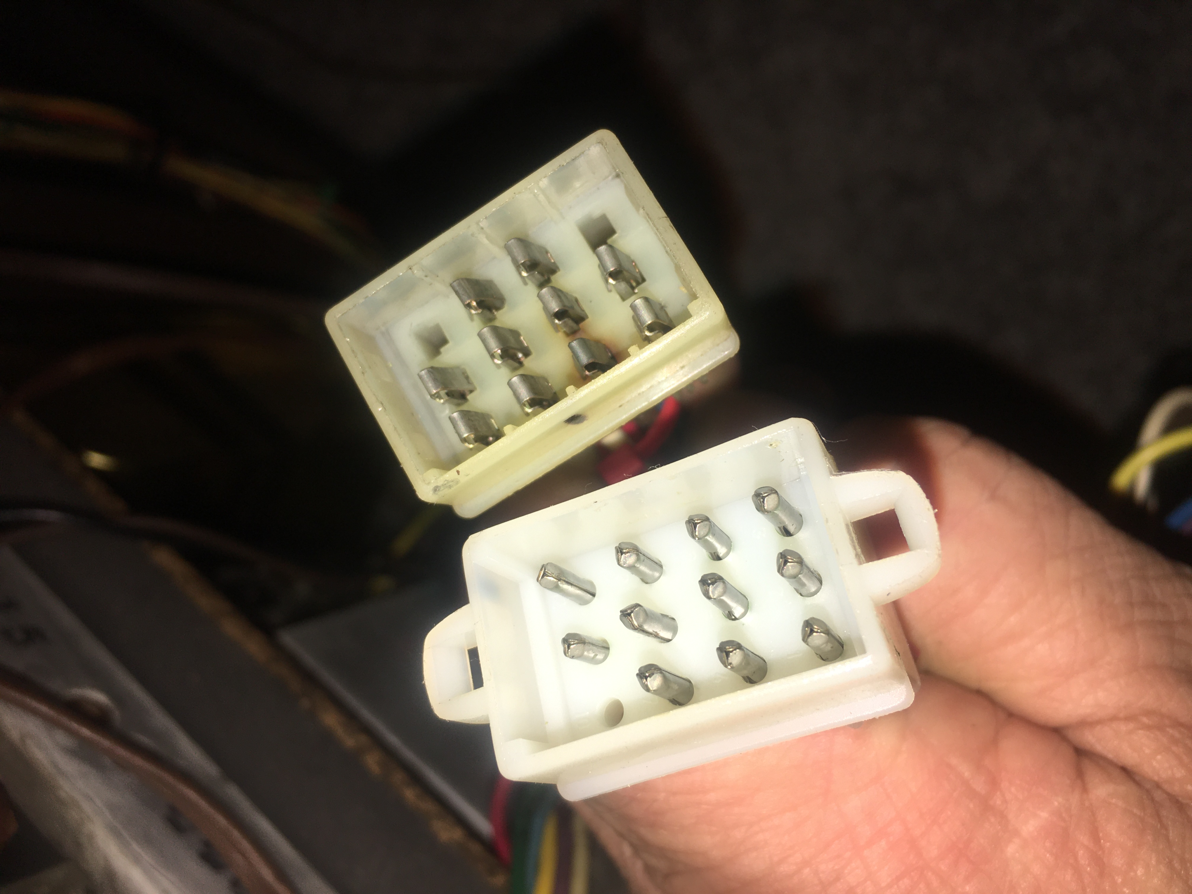

Re: Strange Molex
Hello guys, I had run into this before. I had a MPX unit I went to put onto a AMP 175 and the plug was slightly different it was perplexing since it fit in another AMP 175 that was just one year newer. Then on my CG I went to remove the MPX since I never use the radio I didn't think it needed to be on every time I wanted to listen to the stereo (on Blue tooth) I quickly realized that the in plug on the MPX unit has a slightly different plug from the amp side so it was kind of acting as an adapter. One thing I want to do on the CG is make all the molex plugs the same. If you want I can take photo's.? They look very close to the same plug.

Re: Strange Molex
Hello guys, So here is a photo of the plugs for the MPX on the CG. The round pin one is the output of the mpx the flat pin is the input to the mpx from the preamp. I can't find the mpx unit that had the different pin connector right now. Idk it could just be a replacement.
- Posts: 9084
Re: Strange Molex
All the Molex connectors I am familiar with have flat pins like in the top connector. Perhaps the lower one is a replacement. The Multiplex adapter on my CG is mounted across the opening for the tuner, right above the tuner power supply chassis. I think factory placement is on the back. What a pain that would be to remove the back with the MPX hanging off it, along with the bazillion other speaker and antenna connections.

Re: Strange Molex
The Molex connectors on almost all of my Magnavox equipment looks like the one in the top photo from Hydrolastic. I'm also betting that it was proprietary to their tube-type equipment.
- Posts: 9084
Re: Strange Molex
I have a 2ST253 from 1963 that uses the round pins like the lower picture. It also has a differently oriented Molex connector that won't let you use MPX adapters from earlier models. You have to use a proprietary stereo decoder, They even put a plug on the back of the apron of the chassis to plug one in.
