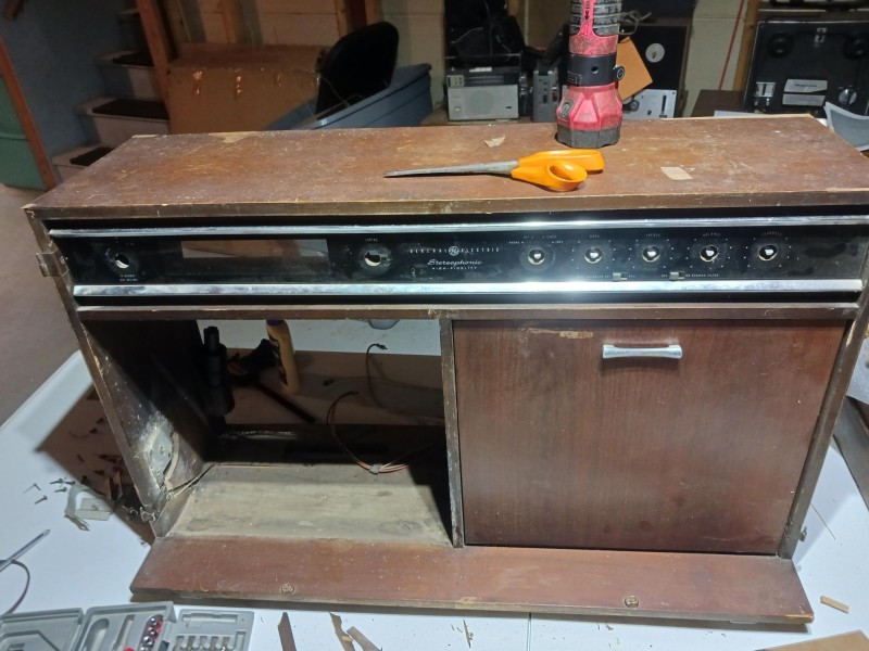

well since the changer is operating, I am now tackling the rest of it... fixing spots of missing veneer with some left over walnut, cut a new plinth for the changer, and got lucky... the changer just squeezes inside the walls of the fold down part .The amp is still in the unit , working on one chassis at a time , the tuner and multiplex unit are out on the bench for now , not sure what kind of legs these came with, but the threads on the corners are like 1" across they must have been heavy duty legs...

I am not happy with the quality of this thing...everything is hard wired including the controls, the speakers, etc... in order to remove the amplifier chassis involves de-soldering about 10 wires or cutting them off .. there are 10 wires going to the volume and other controls including switches ... taking pictures wont help as half the wires are all white I guess I could label each one but I won't remember where they go... the schematic is a joke... this was not made to be serviced ...unless I can find an actual service manual for this , it is getting shelved ...

Sorry to hear that, Elton. It looks a lot like the one I serviced for the local antique guy but obviously a less expensive model. The one I serviced had connectors to unplug to make service easier. Everything was separate, making servicing pretty easy.

When I did Don's RP-1590 and also the parts set I just redid, I learned that the secret to removing the electronics in these sets is to remove it as an assembly. Do not disconnect anything. Remove it all in one lump. If you get to looking real close, you can see that is how it was built. They put the electronics together, then stuffed it all into a cabinet. GE did not built their wooden cabinets. They had the cabinets built so all the parts could be installed as an assembly. If you look, there are grooves cut out of the cabinet so the wires will pass thru. No holes or anything like that. GE stuff is very simple to service, once you get the hang of how they built it. Good luck.
