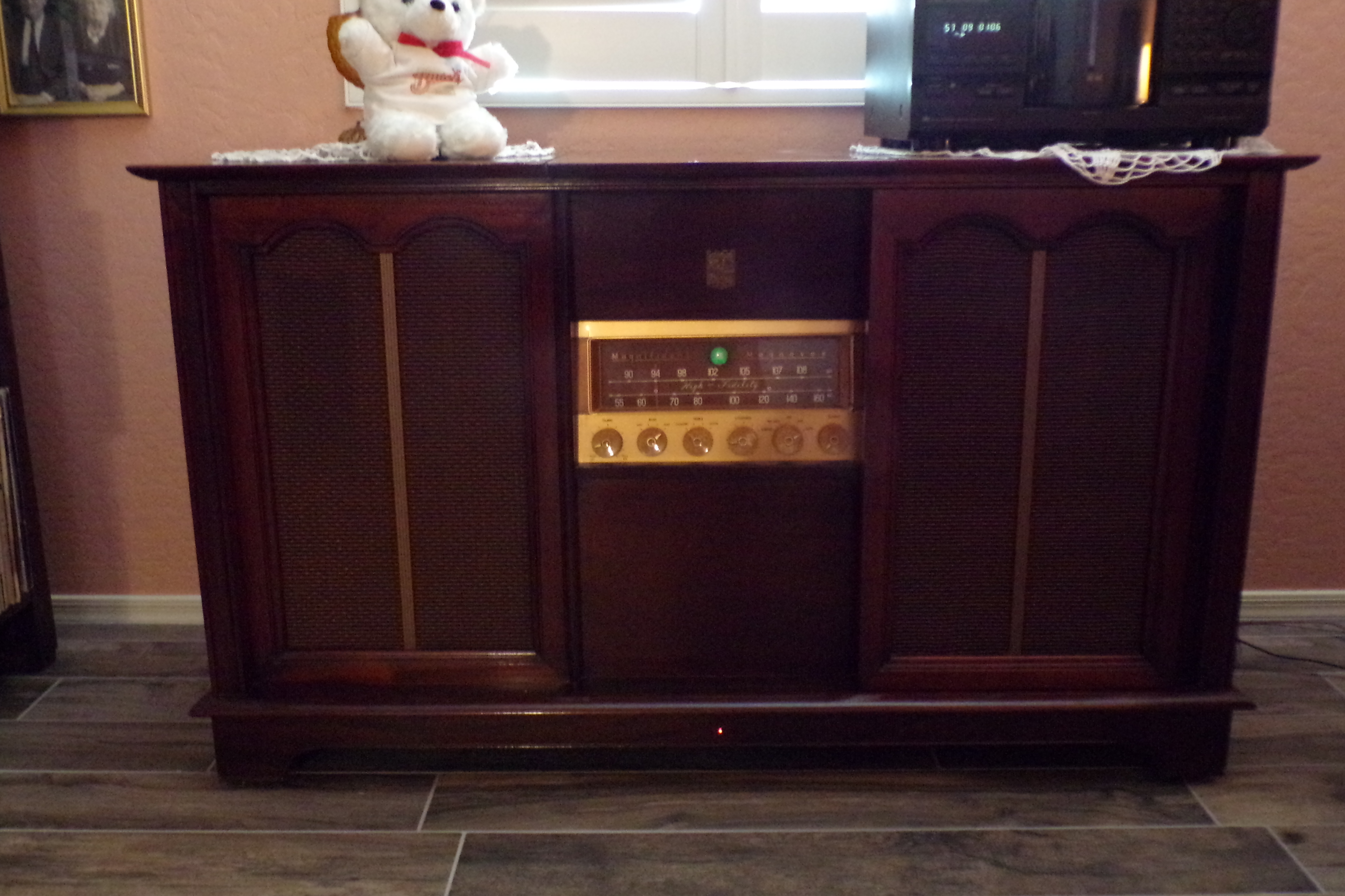

I put the Imperial back on the CD changer
After we got the floor done, I decided to use the Imperial for awhile and let the Symphony rest. I hadn't plugged this in in probably over a year. I still believe this is the prettiest cabinet style Magnavox ever built.

Re: I put the Imperial back on the CD changer
That is beautiful, Greg, and I like the new floor too.
As is the restrained and thoughtful design.
I posted in Chat about a tape I found with my great-grandmother singing on her 100th birthday. If you look at the left corner of the Imperial in the picture above, that is her picture with her husband who passed in 1948. That picture was taken in color, which was a big deal post WW2.
