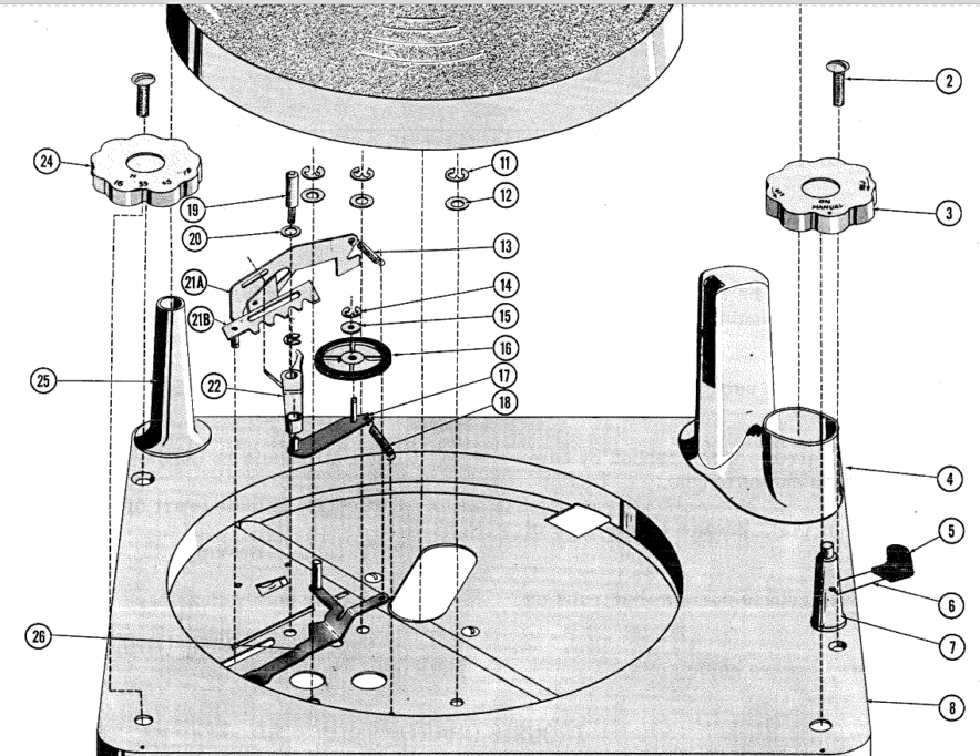

The speed selector was totally immobile, and I could
not figure out why.
I reviewed the exploded diagram of the parts and
linkages in the speed selector area over and over.
I finally realized that part 19 called the speed
change pivot was a sleeve that Part 22,
the speed change lever assembly, was supposed
to move up and down on.
This allowed the idler wheel to move to different
speed positions on the stepped turret.
It took butane flame and a small hammer to knock
the pivot free from the lever assembly.
Yes, good old BSR grease on the pivot, hard as epoxy .
Also, there is not a C-clip that retains part 19, it
is a nut. A C-clip would not work at all in this
set up. Sams missed that item.

Yesterday I tore down the cycling mech after
removing the tonearm.
The cleaning was not too difficult. The trip link had
a bad bend on one side. Easy to bend it back.
4 pole motor is good to go after new mounts installed.
Manual test, all A-OK.
Now I have to order some 5/8 inch long 2-56 screws,
because the tonearm has very deep set mount
holes. (Due to prior large crystal turn over cart)
I have some brass spacers, and will install an
Astatic 81/89 plug-in cart/mount I had left over.
I will say I used up September's cursing quota with
this changer initially. [ : )
