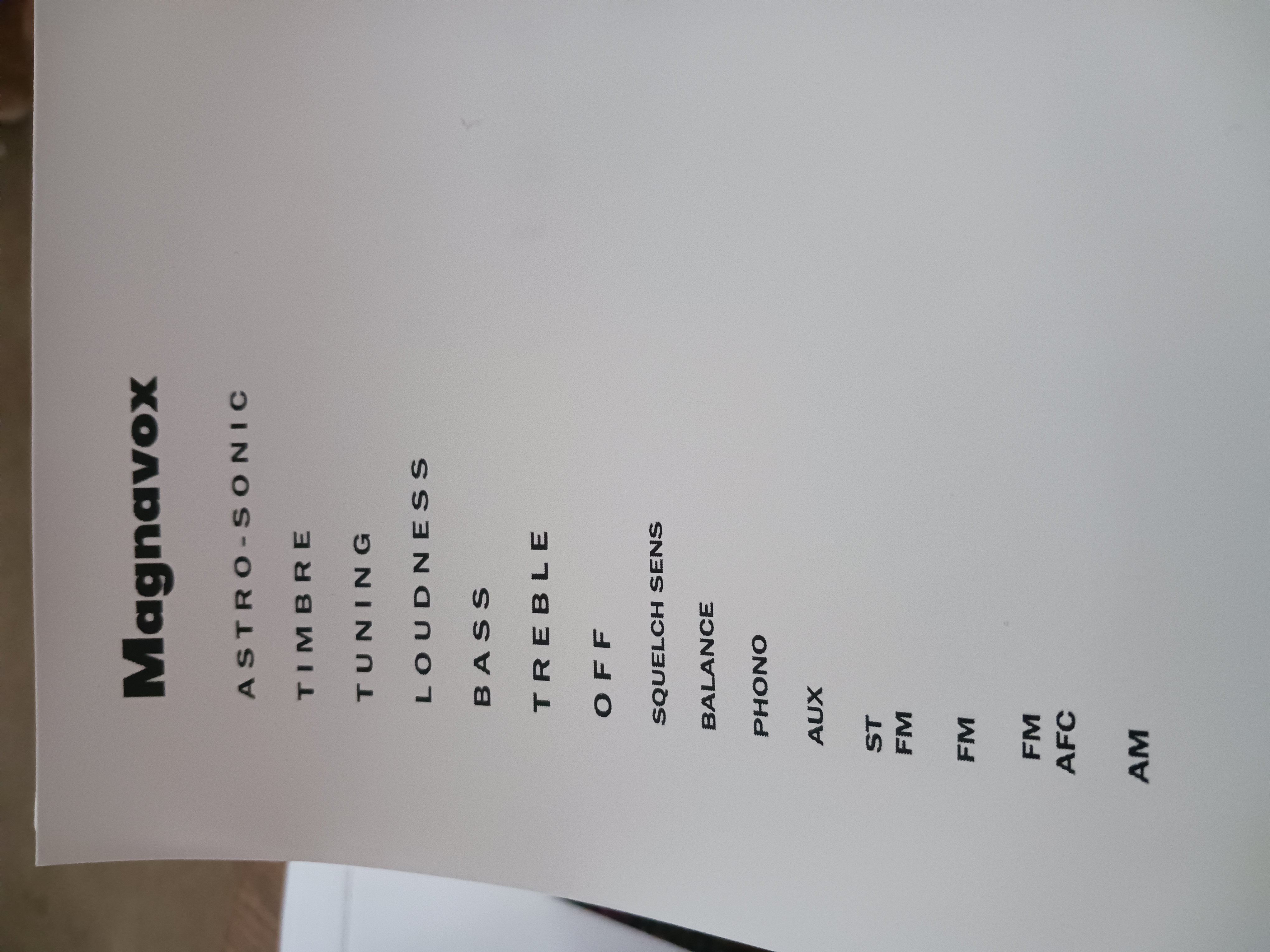

OK, for the unenlightened, more details please? Water-slide decals? Protective covering over them? Where do you buy the printable sheets?
Long ago I repaired a Zenith radio with one of those brass-finished steel rings for a tuning dial with the frequencies marked off on it. it was rusted beyond simple cleanup, so I spray-painted it gold, applied press-on numbers, and sprayed over that with clear finish. It worked well and looks good, but it was far less elegant than your job.
Re: Modification time!
Post: # 19536Post hermitcrab »
You can buy blank water slide decal paper at hobby lobby, in the model car dept , also the dullcoat spray to seal in the decals by Testor's paint... but that paper is only for ink-jet printers , if you have a laser jet then there is paper for those, but I could not find it locally so I got some from amazon... then find the font on your computer or the internet that best matches your particular job...I think I used "Segoe UI" font on windows. it was the best match for the "a" in the Magnavox word... every "a" today looks like a @ sign . here is the sheet printed out with all the words before cutting them out ...

Great job, Elton, I would not have thought about any of what you just did.
Post: # 19543Post TC Chris »
Me neither. Thanks for sharing so the rest of us can give it a try.

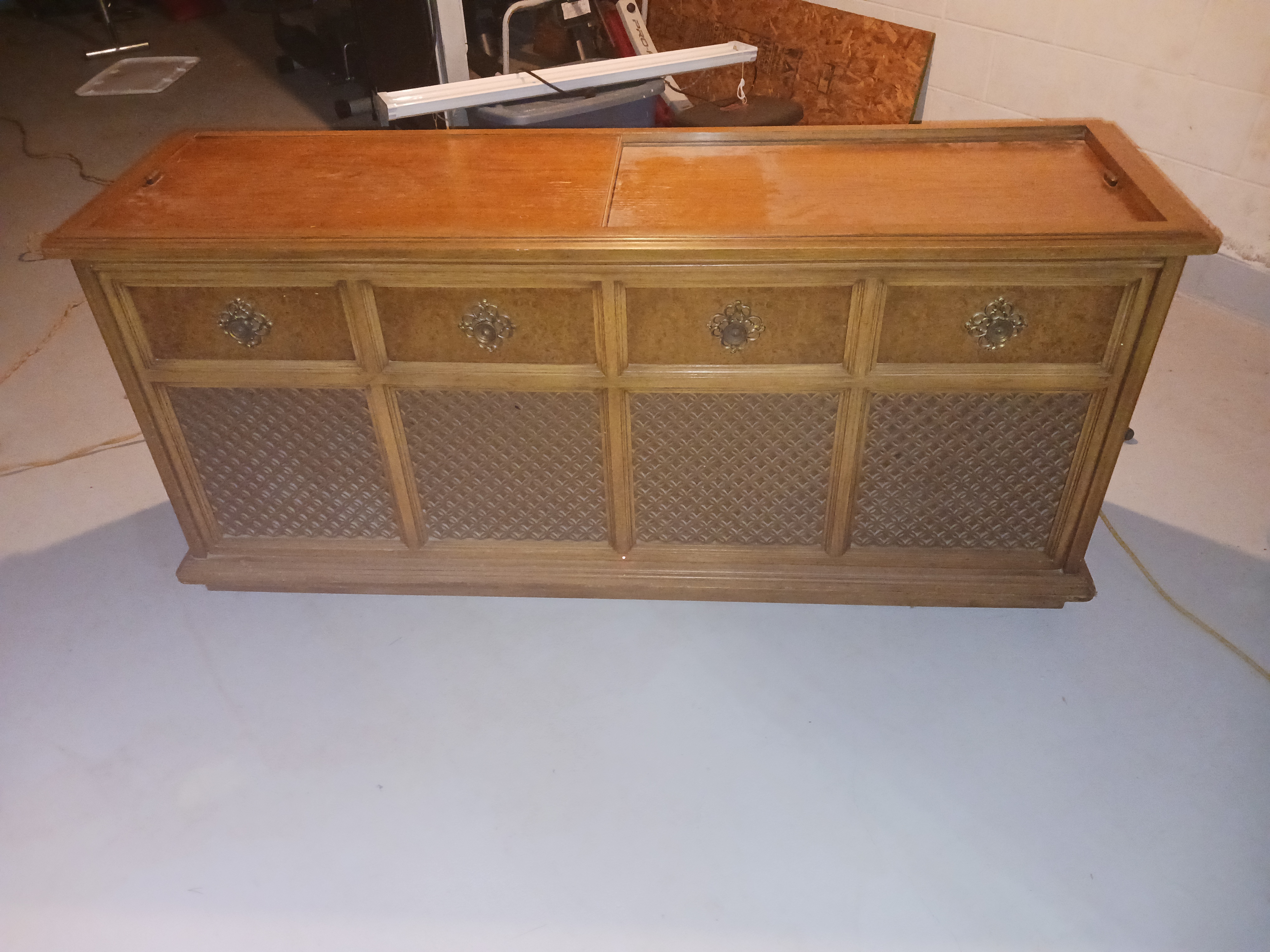

Guess I am not done modifying... the R2R needs to be matched to the system , can only get decent room volume turning the master volume all the way up , I see the AUX input only has a 220K resistor in line according to the schematic , later sets use 100K and a bypass cap ...anything I plug into the Aux is low output... maybe the standards were different back in 64 ? The only thing I can figure is a impedance mismatch ....
Post: # 19635Post electra225 »
Are you certain the electronics in the R2R are up to snuff? Do you have another line-level source you can try to see if the issue is in the console or in the R2R? I have never owned a solid state Magnavox, but I've not had issues feeding tape decks and CD changers into the tape input of a tube instrument.
Post: # 19645Post hermitcrab »
User error!.... plugging in the RCA's into the magnavox aux jacks ,and some bad vision, I plugged the input and outputs backwards ... the letter stamping on the chassis did not help either... it's playing good :oops:

Post: # 19652Post hermitcrab »
OK.... Finished product... I shall not speak of this again :lol:

Post: # 19654Post TC Chris »
Speak of it all you want; it was a cool project, well done. Pat yourself on the back for the accomplishment. Wish we could al hear it performing!
Post: # 19937Post hermitcrab »
Here is a quick video of it playing....https://www.youtube.com/watch?v=tDMwz0EAJvw

Post: # 19938Post walyfd »
Now that's a console! Great job and you didn't think you were going to keep it.
Posts: 5466
Post: # 19940Post William »
Great job, Elton, and even with my crummy computer speakers I can tell it has plenty of bass.
Post: # 19982Post hermitcrab »
walyfd wrote: ↑Sat Feb 17, 2024 8:36 pm Now that's a console! Great job and you didn't think you were going to keep it.
Yea... I know .... but fortunately I sold 3 consoles before Christmas this year...which gave me the room to keep it... :D
