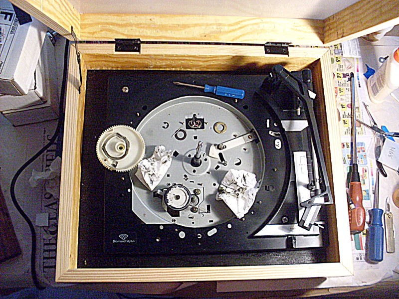

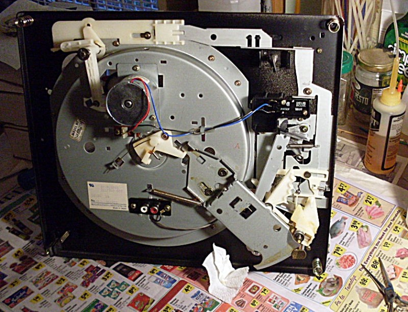

A nice young couple wanted the wife's record changer
working again, so she could show her 20's age kids how
she enjoyed records.
At first, it looked like a BSR, but examining the cycling
mech and some tags under the changer base, it said:
Matsushita, Japan (Panasonic by any other name).
It is circa 1980.
It has a 12 Volt motor, and a similar, but different
cycling mechanism as a BSR.
Besides old grease in the mech, the original idler
wheel had decomposed and a LOT of rubber had
anealed onto the inside rim of the platter and the
stepped spindle of the motor.
After a good cleaning of all that mess, it works very
well. The tonearm drop is very nice and slow.

Were you able to get an idler for it? Gary maybe?
Posts: 1345
Re: 1980 Panasonic SP-915 Changer
Post: # 19583Post Hi-Fi-Mogul »
William wrote: Wed Jan 31, 2024 3:29 pm Mr. Mogul,
Were you able to get an idler for it? Gary maybe? Bill
Bill,
An O-ring is currently working fine, so that the
customer can enjoy it until the idler arrives.
