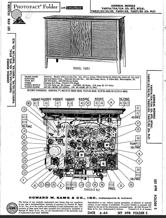

Greg is correct on all counts re: value.
I'm not 100% sure if that is a V-M record changer.
It might be one of their cheaper versions.
The Sams photofact says there is an Admiral-made
changer there.
Here is the Sams photofact electronics
service file face page published in 1964.
changer there.

Now that I look at that again, I think you are right. I don't see another knob that should be there for a VM changer. Old age, I reckon. Good eyes, Mr. Mogul.......
The one I worked on had a VM changer. Maybe it wasn't original? Or maybe they used different changers for different years/models? That looks like what I remember of the chassis. I remember it being a middling performer, nothing that great.
