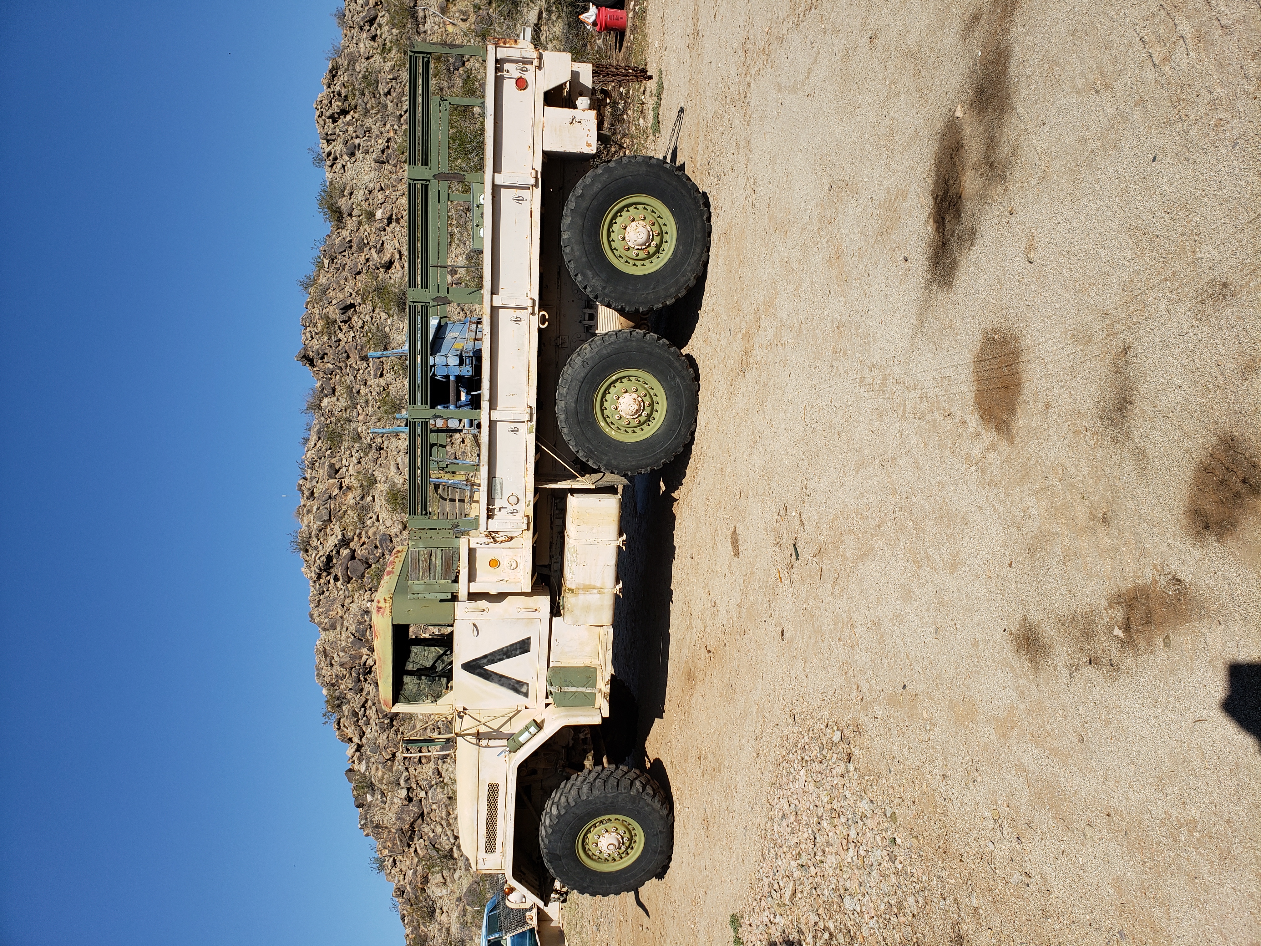

My '67 Kaiser-Jeep Corp M54A1 6X6 5-ton, factory with a Mack ENDT-673 210hp.
5-speed Spicer synchro & 2-speed Rockwell transfer with automatic front axle engagement.
22,000 lbs curb weight of right-of-way...
Dunno know why it posted vertically, just enlarge it to see correctly.

That is quite the grocery-getter, Dennis.......
Wonder why they didn't use the five-speed Mack transmission?
You need a rig like that when you are on the 101. It's not safe to be on that road with a small car....

Dennis, what is the final drive ratio on that? Did it have Mack rear ends? Mack ratios were 4.56. 4.44, 4.33 and 3.88. Most of the five-speeds used a 4.44 ratio. The 12-speed Super Liner was on 4.33's. I had an Autocar with a 335 Cummins on 3.88's. Scary fast.....
I got more speeding tickets in that thing than anything I ever drove. Getting a speeding ticket in a Mack was unheard of......

Re: Mack model L
I hope this doesn't result in TL,DR...
The series of tacticals like mine was designed in the very early 50's, built by International, Diamond T, Mack, and Kaiser Jeep over the years, with completely interchangeable parts.
Spicer had the lock on the largest synchro 5-speed trans used in all of them for many years.
The rest of the drivetrain was of Timken design, later supplied by Rockwell, with a highly compliant 44,000 lb tandem set and 6.44:1 ratio. These were not speedy road trucks, but real off-road workhorses. Top speed in mine with the 14.00 rubber is 59 mph. Even has wet brakes with an Bendix air-over-hydraulic booster. It stops just fine, loaded or not.
The original fielding was powered by a Continental 6602 6cyl gasser @ 234 hp (100CI/cyl). Thirsty, but made a LOT of power, up there with the Mack 707 engine.
With a newer contract in '65, the Test & Evaluation Command went with the Mack ENDT, as it was an easy fit in the chassis, better fuel mileage and lifespan. Spicer redesigned the gearset with a 5th over to compensate for the lower RPM.
3 years later and a lot of $ spent on Mack Diesels for that reign of trucks (tractor, dump, cargo, LWB cargo, tanker, expansible van, bridge truck,wrecker & cab/chassis), they went with the slightly cheaper Hercules Hypercycle turbo multifuel engine, said to run on most combustible fluids, to include Kerosene, gasoline, jet fuel, & diesel. That it did.
It never did really good job at anything; it had temperamental head gaskets, an unsolved resonance item with the crank, and was underpowered with a displacement under 500CI.
A 1969 production run with an extended hood & fenders (the 800 series) to accommodate a Cummins 250 NA was much improved over the multi, even without a turbo.
In the mid 80's, a new generation (the 900-series) was let with either Cummins 8.3 or a Cat diesel, Allison or Clark powershift, computer controlled eng & trans, tilt front end, and straight wedge air brakes. Blessed with a host of electronic and mechanical problems, many upgrades were done in their short lifespan.
They were getting too soft on drivers, many new recruits couldn't even work a manual trans. No thanks.
The proof is some trucks like mine, built in the 50's, are still running some 70 years later in the world. "deleted", mine is pushing 60 now. Until the last couple years early series 5-tons were still in service in a few units.
Not so with the newer ones, the surplus market is full of them. I know of several original 50's gasser rigs still running in private collections.
Most of this data is correct: https://en.wikipedia.org/wiki/M39_serie ... %976_truck
