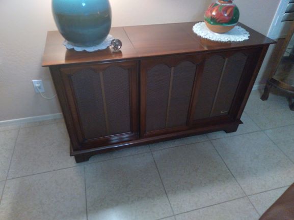

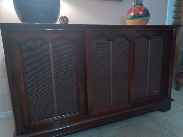

Everybody likes pictures. Perhaps a picture of the old Imperial might be appreciated. This is my prettiest Magnavox. NOBODY did mahogany like Magnavox. This one is in the Italian Provincial cabinet. This thing sits in our living room, and always garners compliments even from folks who have no idea what it is. It has one of the more non-drifty, non-AFC tuners that I have. I found this on Craigslist, in 2013, right after we got to AZ that year. It was in Creve Ceour, MO, a suburb of St. Louis. It was advertised as a Concert Grand. I contacted the seller, emailed back and forth a few times. He told me his Aunt Rose bought it new in 1961. It "was always on" in his aunt's house. She had passed, and he was cleaning out her house of belongings, then was going to sell the house. I told him that I was in AZ and would not be in that part of the country until April. Surprisingly, he promised to hold it for me until Spring, because he wanted it to go to someone who would appreciate it. When we got home in the Spring, as soon as we could, made the trip of about 250 miles one way to see it. It was pretty sad when we first got to it. It looked like someone had slung mashed potatoes all over the cabinet. The grill cloth was nasty. Not wanting to take it in the house until it was cleaned, I went to work on the cabinet with cleaner and orange oil, the wife went to work on the grill cloth. It had a real bad hum, caused by the cathode bias resistor being burned internally. The output tubes were all fried, so I put a set of JJ's in it. It has the typical Magnavox bi-amp strangled bass, but that's just a part of its personality. The blue lamp on the left of the cabinet "set top appointments" came from a ceramic Easter egg my wife had. She had me make a lamp out of the Easter egg. I used an expensive bit in the drill press to make holes in the ceramic. On the other end of the cabinet, is a handmade solitllo canteen. The bottom holds water, while the lid is actually a drinking cup. It was made by a relative of our neighbor.

That's a handsome piece of furniture, Greg. I wish my Imperial was that cabinet.

Who doesn't want to restore these gals after
viewing such a beautiful Hi-Fi ?
Greg, in what situations do you find orange oil of best use ?

I bought a case of Pledge orange oil. It doesn't have any silicone in it. I like it to clean the wood, and feed it so it will not look so dry. Nobody knows for sure what the milky smooth finish was that Magnavox used on their cabinets. They advertised ten coats of hand-rubbed oil finish, whatever that was. The best guess is Danish oil. Orange oil works well with the original finish. There were some flea bites on the cabinet, but a stain stick from Home Depot and some elbow grease pretty much negated their impact on the finish. I used glass cleaner without alcohol or ammonia to do the worst cleaning, the heavy stuff. Then I used the orange oil to finish and make it milky feeling again. I don't remember what the wife used on the grill cloth, but I'm guessing it was Spot Shot that she uses to clean up animal emissions left on the rugs and carpets. She cleaned it with the grill cloth still in the cabinet and it turned out really nice. It's hard to hurt a Magnavox finish.
Bill, I have always believed that this particular cabinet was one of the better ones Magnavox built. It's just plain pretty. Every line, every detail is pretty. Then there is that Magnavox mahogany......... :D :D
And, for an old guy like me, it's on casters!...... :D :D :D :D :D :D

That sure did turn out nice... a great save!

I recently painted the wall behind the Imperial. The current color better highlights the mahogany finish. Wait until I get the pale pink whorehouse lamps I have for it and the Concert Grand out of storage. Those will look killer on the mahogany cabinet.

Great looking device. Mahogany is a stunning wood and the design is dignified.
