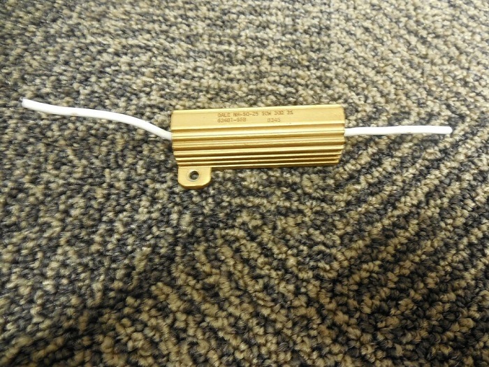

- Posts: 1975
Re: Magnavox stereo, voltage bucking devices
In selecting a higher wattage resistor, I have used and suggest a mountable resistor like the Dale. you can mount it on a flat aluminum plate sink with a little thermal heat sink compound and set the sink up so it can be mounted in the equipment space.
- Dale power resistor.jpg (209.36 KiB) Viewed 4413 times
- Posts: 9030
That Dale resistor looks a lot like the one I saw in the Zenith radio I mentioned. That could be mounted under the chassis, couldn't it? Where might someone acquire such a device?

- Posts: 3749
My preference would be to mount it outboard, where it wouldn't shed its heat in the innards of the device, cooking other components. Yeah, it might look non-original outboard, but at least it would ventilate effectively and into a space where nothing wold be roasted. Heat is a big enemy of our equipment.electra225 wrote: ↑Thu Sep 02, 2021 8:59 pm That Dale resistor looks a lot like the one I saw in the Zenith radio I mentioned. That could be mounted under the chassis, couldn't it? Where might someone acquire such a device?
