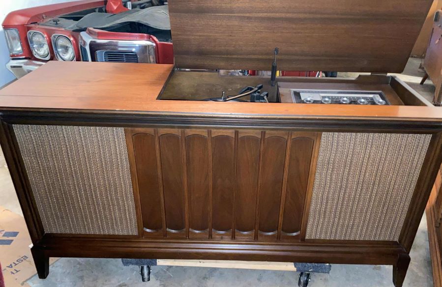

Post: # 16302Post Motorola minion »
Once again, I jumped and made an offer before researching this one. Assuming it was all tube, nowhere does it say solid state. Picked it up yesterday and also noticed an empty spot for a reel-to-reel tape deck (R2R). I tested it at the sellers before paying up, prepared to walk way if it sounded lousy. It was in nice shape and had been moved from Buffalo.
The pull-on power switch is a plus on any unit. AC power switch piggy-backed on function switches and treble controls was a bad idea that most manufacturers used for some reason. The knobs are all metal and control panel looks very much like the TOTL model of 3 years before, the SC617 which uses PP7868s :o like a Fisher 400.
The chassis is all hand-wired, tubes are used for RF-IF-MPX but its all transistors for the preamp and output stages.
I have had a SS Sylvania before this one and I was not able to get it sounding quite right even after replacing all the capacitors. I dropped that one off at Habitat, working, complete and it sold quickly. Suspecting the germanium transistors, mainly because they weren't RCA transistors. This just may be another lesson in solid state fails and why to avoid them.

Looks like a crypt in here but no bugs :D . Sometimes Im surprised by what I see. My 69 GP likes company in my rented garage, where volume testing is cowabunga no limit! Unfortunately, this console makes a very soft but clear FM and AM out both channels. Hope its just caps and DeOxit :!:
Only one thing "jumped out"; by this time, Sylvania TVs had been using fiberglass-based PC boards for years with mixed reviews, yet none are used in this console!

As can be seen from pictures, the speakers are baffled with jute? so adding some cabinet reinforcement may even improve and tighten bass by improving enclosure rigidity.
The two cone tweeters with a cap between them, means the jute needs pulled back, hope it doesnt disintegrate
