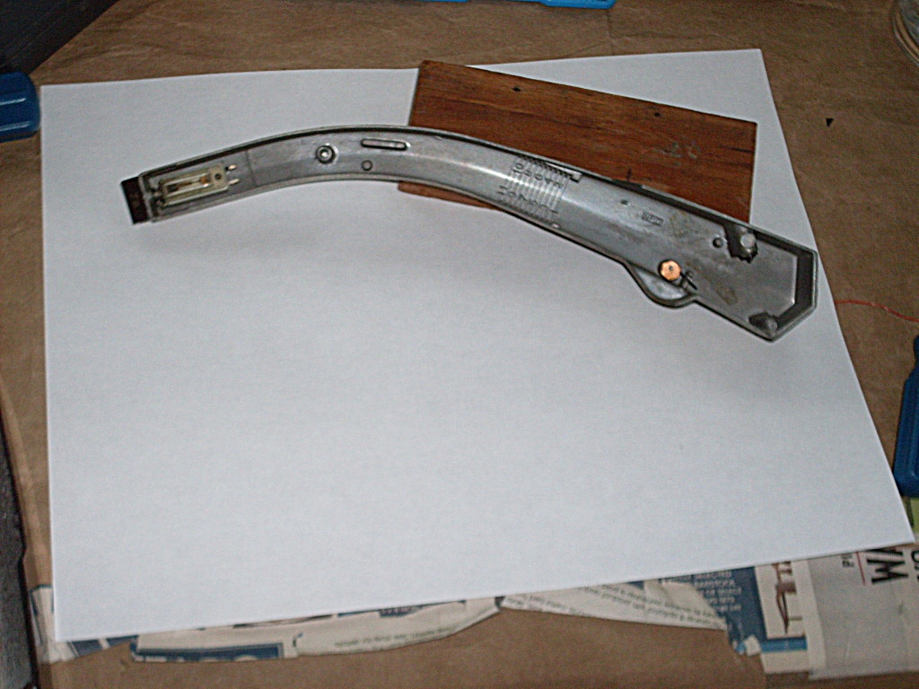

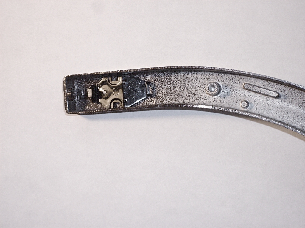

I removed the old crystal cart.
I was able to drill a hole through the tonearm easily,
but centering the hole is a bit difficult.
I came pretty close, and I don't think it would affect
playability of the Pfanstiehl cartridge.
The Pfanstiehl P-226/228 carts have a plastic mounting
bracket with a centered hole in it.
I measured 10 mm to be the length away from
the inside front of the tonearm to where the hole
needed to be drilled to mount the P-228 cartridge
mount bracket.
I believe I used a 4/40 screw, but it may be smaller
than that.

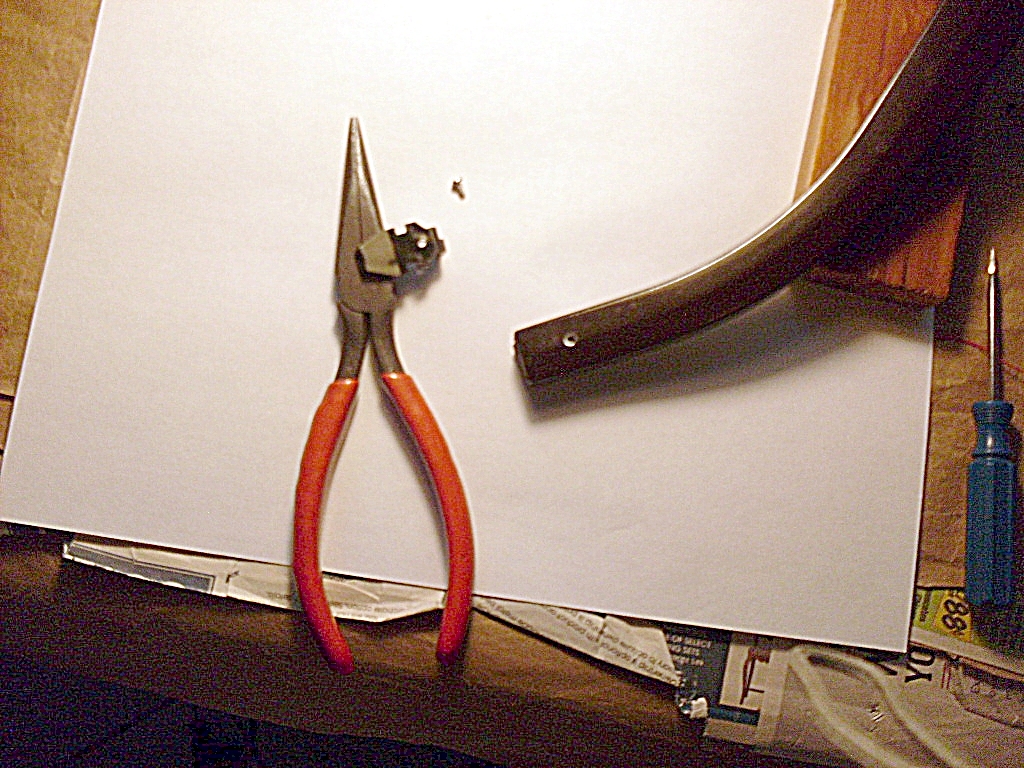

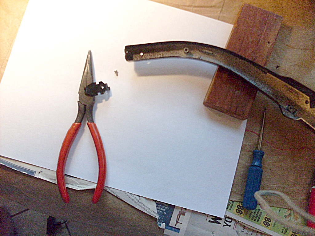

After drilling the hole for the 4/40, I widened
the top hole in the tonearm by shallow drilling
it out a bit larger than the original hole.
This created a bit of counter-sink on top of the tonearm hole.
Then I removed the mount bracket from the P-228, and
screwed the 4/40 screw into the bracket's hole.
That takes some patience, but once you get the thread
started, you can pincer the screw/mount with your
fingers of one hand.
With the other hand, use a small screwdriver to then
turn the screw through the plastic bracket's mount hole.
I then removed the screw, put it through the top hole of the
tonearm, then centered the hole of the plastic mount
over the screw.
Tightend it down good, and it appears this technique will
work to re-use V-M tonearms that came with crystal
turn-over carts sans 1/2 inch mount holes.
