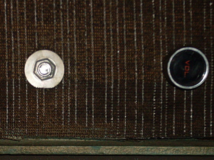

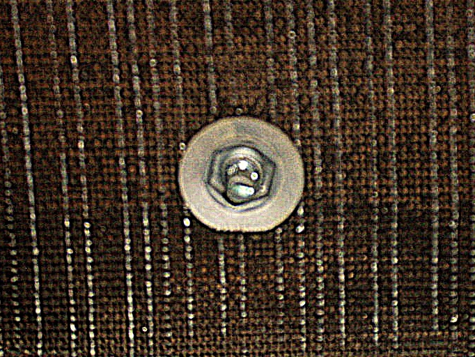

I've got an orphaned one tube wonder Bradford
record player with a nice mid-1960's BSR.
The Tone and Volume control shafts on the amp
chassis are held onto the cabinet by a more
rare kind of recessed fastener.
I would like to know what will work to easily unscrew
these fasteners ?
I know I could use a larger set of needle nose pliers,
but suggestions are welcome.
Thanks !

- Bradford Control Fastener.JPG (301.3 KiB) Viewed 1892 times
- Bradford Control Fastener-1.JPG (390.67 KiB) Viewed 1892 times

Looks like a socket won't fit into the recess, so your notion of using the needle nose pliers seems right.

A thin-wall socket should work. Or, you might even be able to use needle nose pliers to remove that nut. They usually aren't on all that tight. I have a set of thin-wall sockets I bought to do heater cores and evaporators. You need those many times so you don't break the fiberglass heater housing....My set is 1/4" drive from 1/8" to 5/8" and from 2MM to 15MM. Worth their weight in gold if you do lots of underdash work....

I don't think I made a clear description.
The fastener is inverted to be concave versus a normal
convex hex type fastener.
It's like I need a hex socket turned inside out where the
six sides would fit into this fastener.

Could you use a double nut setup? Find a nut that will go inside the thing you want to take off. Then either glue the two nuts together, or use a length of hollow all-thread to hold them together. Then use a socket on the nut that is on top to turn the bottom one and the thing you want to remove. Magnavox used those on some of their Astro-Sonic chassis. There is a name for that tool, but it escapes me. You might also be able to put a nut into the thing you want to remove, then see if enough sticks up to get a deepwell socket on it.

Greg,
I like the idea of using a single nut or glueing
2 nuts together to insert.
If I can get just a bit of the nut protruding, then even
regular pliers will make it an easy do.
Being a nut myself, I should be able to do that !

I've had luck using snap ring pliers. Set the tips inside 2 corners of the nut and, because squeezing them opens the tips, you create pressure.

Nah, that is a cheap, stamped-out of thin sheetmetal regular volume control nut.
You're looking at the concave side of it. It removes just like any other VC nut.
Usually takes a 1/2" thinwall socket.
I throw them away and replace with a real solid nut.
That is indeed an econo player.

Re: What Tool Do I Need ?
I used needle nosed pliers and removed the nuts.
A thin wall socket cannot fit into a concave cavity,
so I don't get that.
Replacing these control nuts with a regular one, though
is a good idea.

I have a special double-ended socket made just for those installs. The wall is about 1/32".
