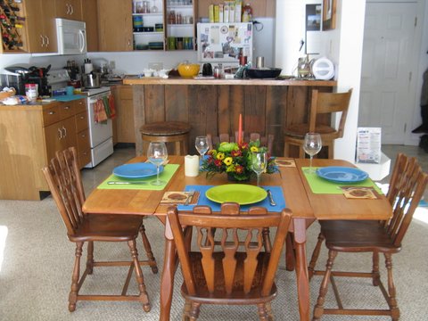

Query whether a fancy two-part finish is warranted for a table top. In the early 1950s my Mom bought a used round oak pedestal dining table, likely from 1910s or 1920s. It had been painted white and was a utility-room table. Then it was in the way and she gave it to family friends who used it as a basement table. It acquired a couple sawblade nicks in that service. The pedestal came unglued and before they tossed it they offered it back to Mom. I took it, reglued the pedestal, removed the old finish, and stained then varnished with store-brand polyurethane varnish. That was in 1977. It has served as my dining table ever since, which includes service as an electronic service bench from time to time. About 5 years ago, after 41 years of use, it was a bit scratched up. I recoated the top, using the rest of the original can of varnish. Yup, still usable. Turned out just fine. The point is, don't overdo the finish.
Oh, and the table it replaced in 1977? That was a maple one, stained in that Early American orange color. It went into storage but got hit by a flood and the top, solid maple edge-glued, came unglued. I felt awful because it was a nice table. For years I walked past it, thinking "Some day I'll reglue that." About 10 years ago I bought a biscuit cutter and reglued the top, then refinished it and gave it to my niece and her husband. They are still using it.
