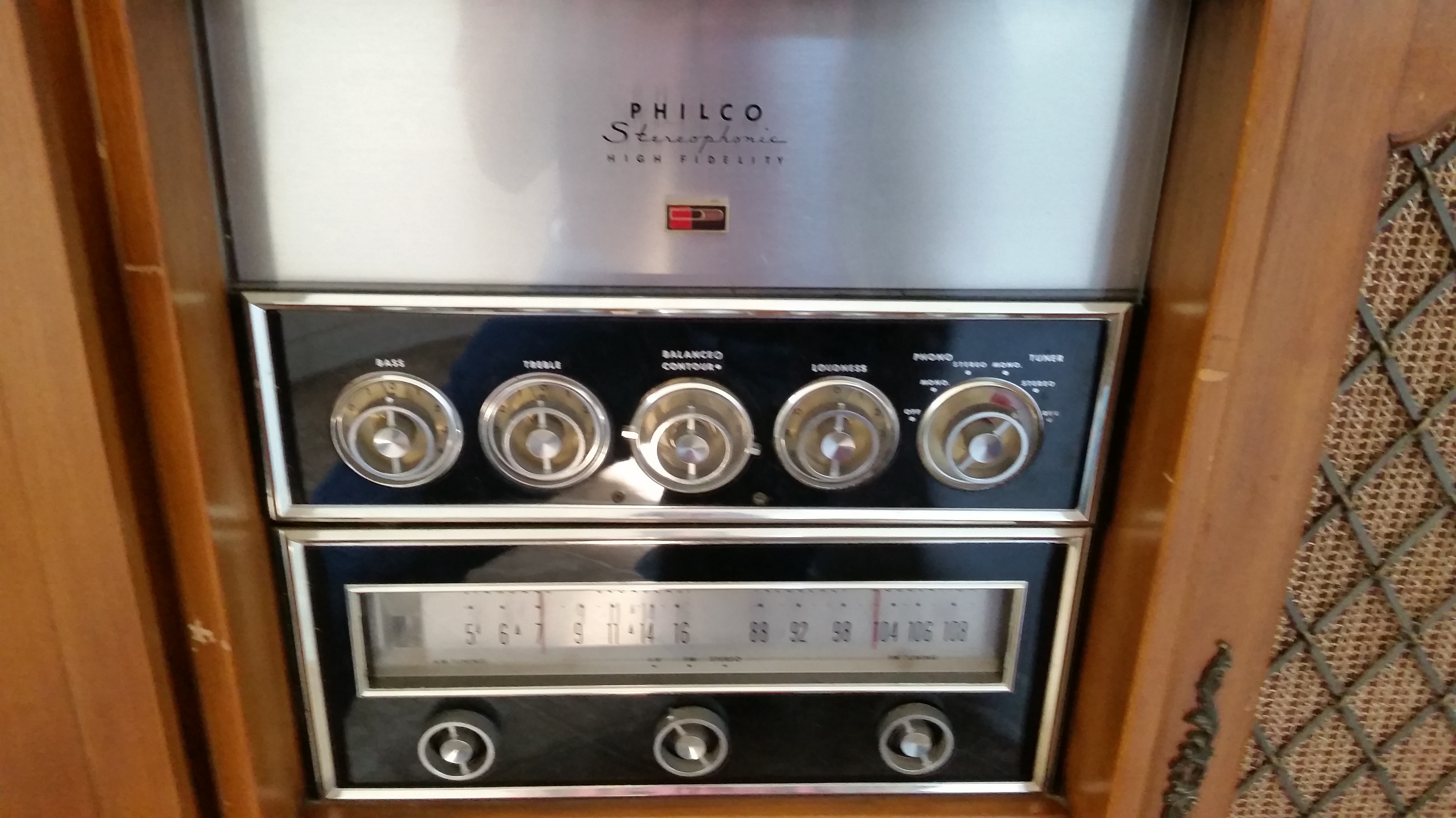

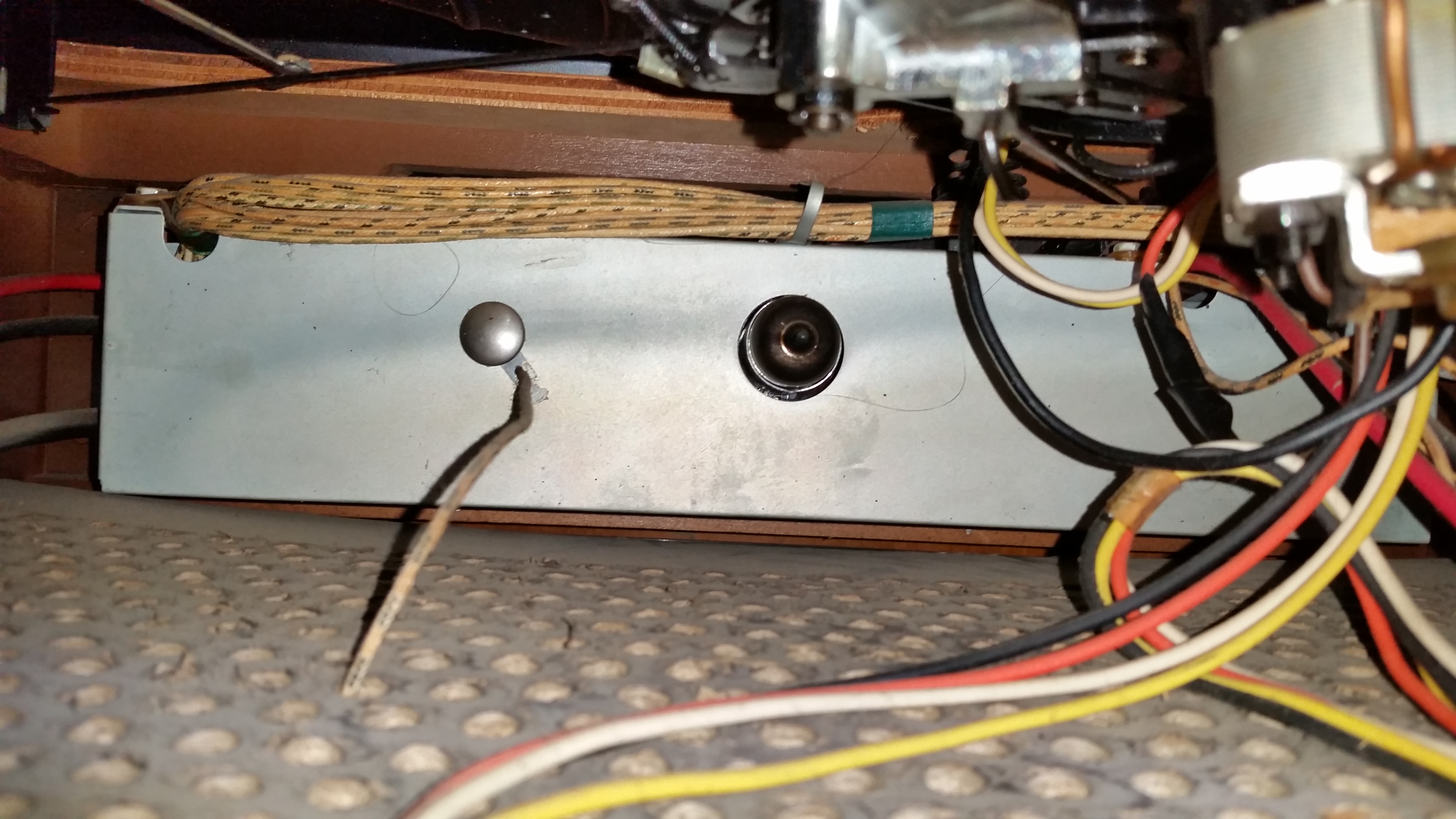

I think Philco calls it a Control Center. It's the only separate pre I have in my collection. Just a single 12AX7A/7025. The amp is 3 channel 7189/7199. I wish I had the knowledge to know why a 12AX7A. Not sure if it could be related to the electrostatic tweeters in them? Here's a front and rear photo. Markelectra225 wrote: ↑Mon Jan 23, 2023 1:54 am Then if your Philco specs a 12AX7A in the pre amp, may we assume it is there for additional gain, perhaps? Is that in the Multiplex section of the tuner?
- Posts: 8935
Re: tubes: 12ax7 vs 12ax7a
Do you have the schematic you could post or link? That might give us a better idea of what that tube does.
