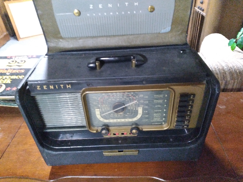

I re-covered a H-500 Zenith Transoceanic with tolex , being able to dismantle the case greatly helped ... just used contact cement , turned out pretty good...

Not quite sure on what you mean overkill... tolex is not that thick maybe a couple mils...here is a example of a corner on the radio , that to me was the hardest part to get it to lie down ... otherwise it was pretty straight forward ...the picture of the zenith console i used contact paper for the ribs as I did not have any edge banding at the time ... I dabbed stain on the paper to try and match ... as you see I failed... fortunately I can just easily rip it back off ... I think the stuff you are talking about is the grey paper that is on the lid behind the wave magnet ... it is a paper with some kind of colored coating on it , it is pretty stiff , no idea what they used at the time...
