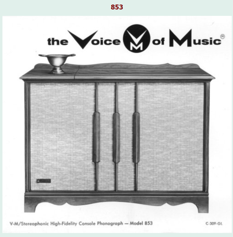

I just had a call from a new customer (referred via local Record Connection) who wants her Grandma's console restored. This model was a 1963, but the VM website lists as 1962, selling for $260 new.
From the conversation it was being used recently so, I am assuming a recap and record player (VM 1200 series) phono wheel, stylus etc. Thanks to Firedome, I have the same tuner and changer as spares :P , so I was pretty sure I could do the job.
I pulled Sams 667 - 10 and confirmed the restoration will be comparable to two lower-priced 6BQ5SE Mag consoles in my shop right now. The schematic did not include the stereo tuner.
This was a popular model for V-M.
V-M 853.png (406.88 KiB) Viewed 51350 times

Is the tuner full stereo or does it use a Multiplex adapter?
Re: VM 853 console
Posted: Fri Sep 10, 2021 11:10 am
by William
As far as I know, VM did not have a MPX adaptor. Their tuners were either mono or stereo.
Dave, is this single ended, or PP?

I have the spare tuner and it appears to have on-board mpx. The tube chart shows 19 kc pilot and 38 kc doubler adjust coils.

I missed your post before sending my last. This stereo amp is a single-ended 6BQ5

This unit was a very easy restoration. The player had a still-good Euphonics U2 ceramic cart but needed lots of degunking and an idler pulley. I played it all last week on my office console, a Motorola SK112 with twice as many tubes as the V-M, to be sure all was functional and sounded good on even worn records.
The amp got all its electrolytic caps replaced and the multiplex tuner (model 1465) needed cleaning, two electros, one paper cap and at last, a 6C4 tube was gassy. The bill was reasonable and close to the fair asking price for a restored model, considering its not highly-desirable furniture otherwise.
I delivered and reassembled the console in about an hour and the customer had two LP records of her grandma's, ones I am also familiar with like Jackie Gleason's Orchestra and Billy Vaughn.
These fine old sounds really highlighted how good this unit really sounds. She was going to the local used record store right after I was done, the same place that referred her to me. :P
Too bad many of these get gutted for the amplifier alone but leaving matched speakers behind, it will not sound as good with less-efficient speakers. .

The amp in the 853 and tuner drop-in from the topside. The selector-volume-tone controls are built in and included a 6EU7 on a small PC board, fully shielded all around, even the bottom of the amp had a stout, ventilated cover.
The amp itself looked awesome fully shielded and very neat layout of OPTs, power trans and tubes. So I understand its appeal as a separate component.
