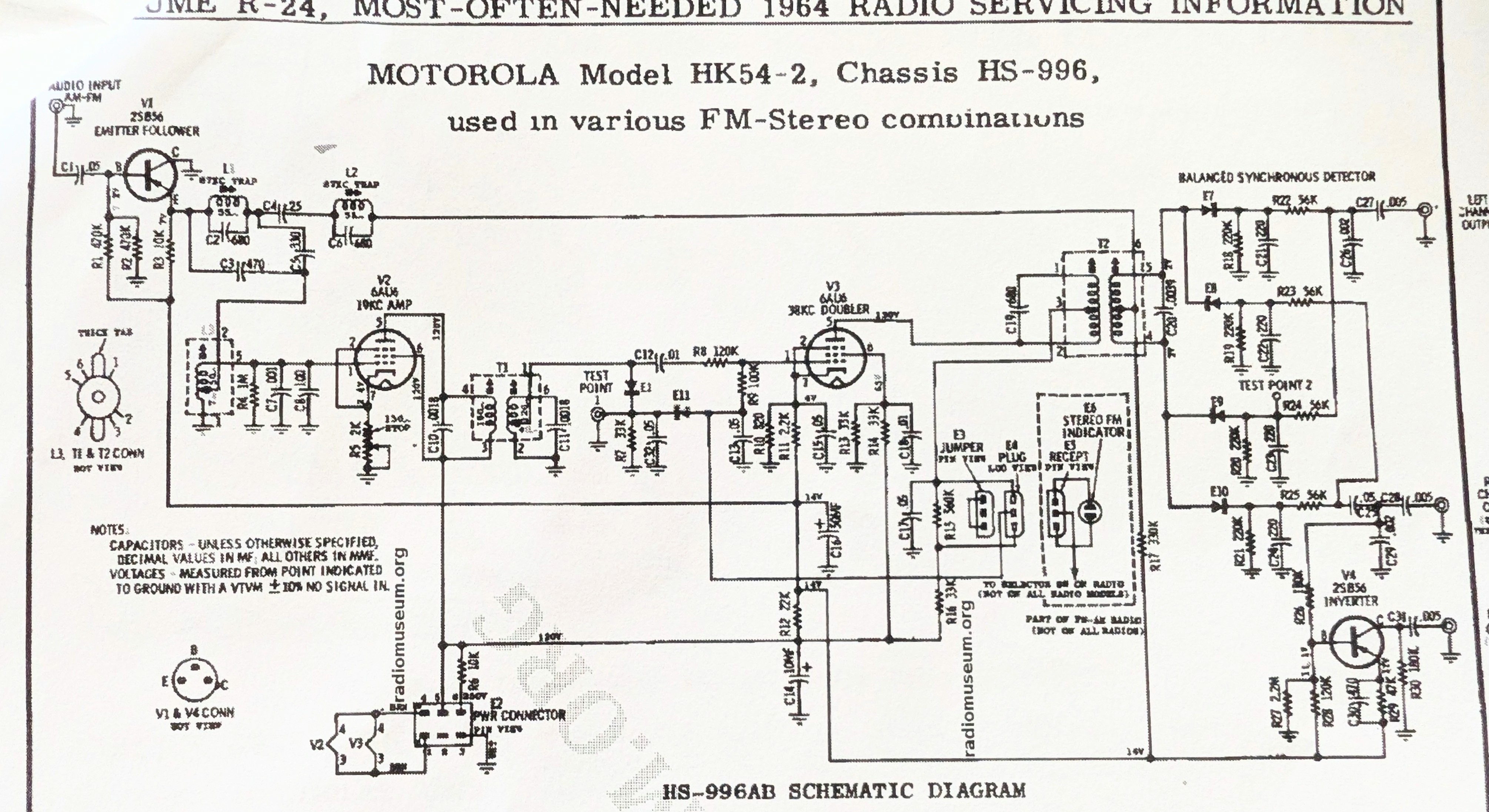

Re: Stereo light issue maybe solved?
Shortly after moving the SK111 to our living room and my tweaking of the coils on the MPX unit, the stereo light quit working. Still had FM sound, but it was mono, no audible separation. Didn't want to mess with it since I don't use FM that much.
But, we relocated it in our living room for a better sounding location, and after that, the radio became very weak, both FM and AM. Finally got around to checking that out this morning. I took off the back and started wiggling some of the interconnecting cables and connectors, but no effect. Then I noticed that the MPX tubes were cold, no filaments glowing, even though the MPX was putting out audio!
I'm guessing the filament voltage was not getting to the MPX unit, but the input transistor was still getting its DC, so the mono audio had a path to the center tap of the final transformer, and subsequently to the outputs. This schematic, (one of three different ones) most clearly shows that path in the upper horizontal line. So, I de-oxed all the Amperex connectors for the MPX power cable that goes to the tuner and the one from the power amp to the tuner. Now, the stereo light works (its not very selective, stays on or flashing most of the time while tuning) and stations actually have decent stereo separation! BTW, that output transistor stage, V4, is not actually present on my MPX.
For those of you who have the "wonky stereo light" you might try this fix. Will it last? We shall see.....
