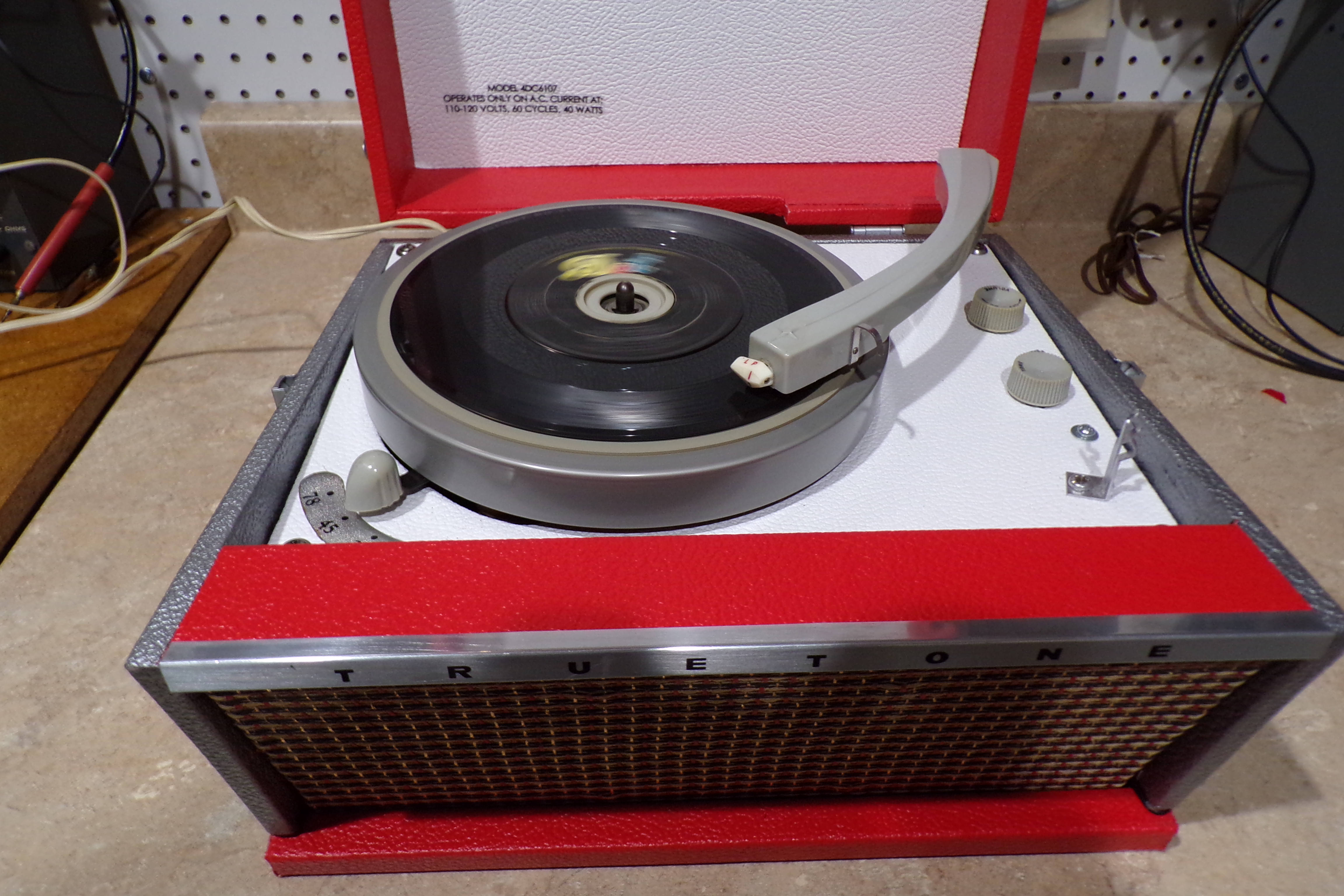

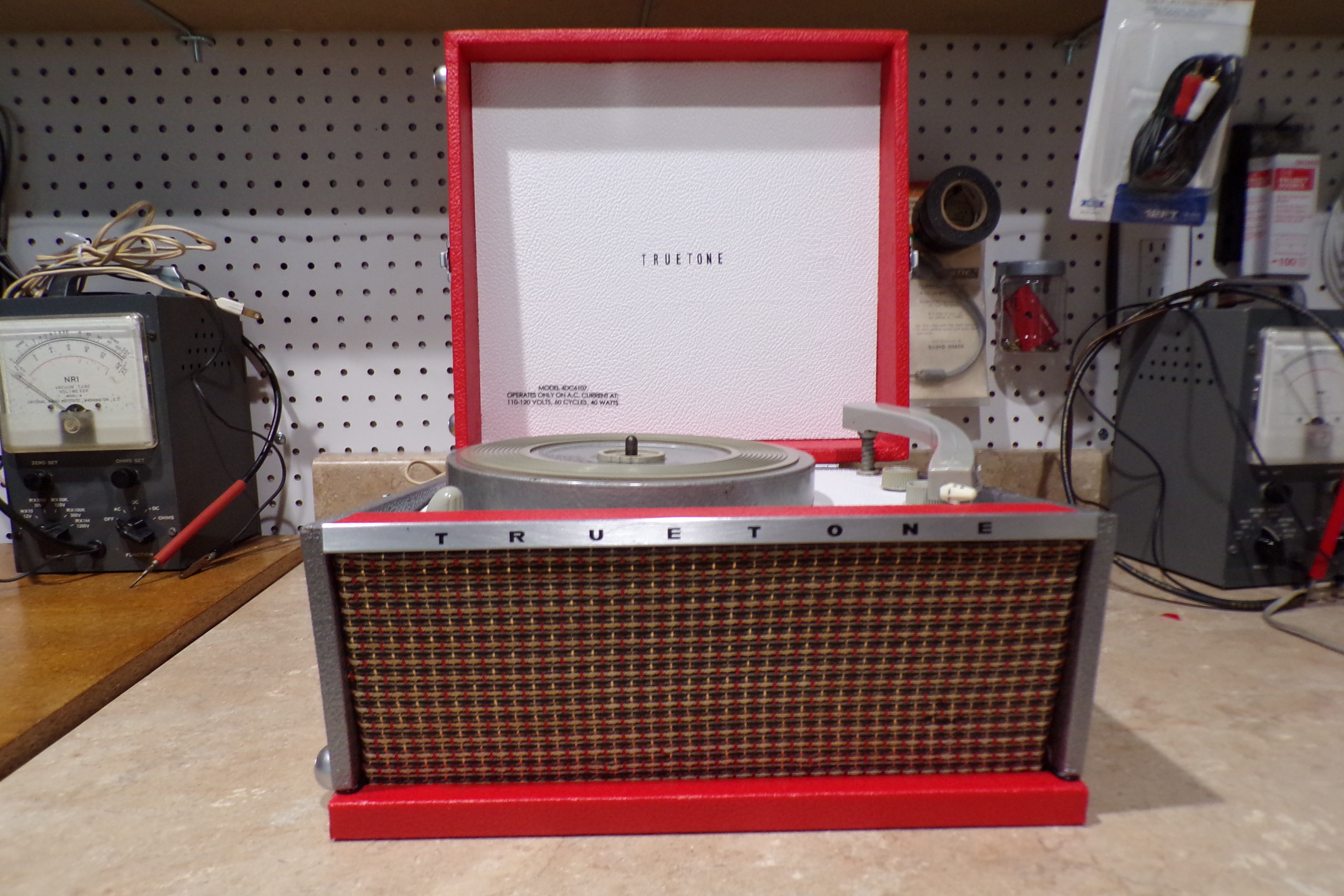

Okay, here we are, folks. Done and done as grandpa used to say.......
Since I am my worst critic, it could really use a new power cord. This one isn't as white as it was before I replaced the white Tolex in the lid. Now the cord looks dirty, but I'm not going to take it all back apart to change the power cord. The grille cloth is not perfectly straight at the bottom edge. It never was and won't cover the top if I move it. They didn't give a quarter of an inch more material than they needed....
I may start replacing 50C5 tubes with 50EH5's in record players. I like the volume this has now. It wasn't that loud when it was new.
And.....in the way of full disclosure, the metal trim that says "Truetone" on the front lip of the cabinet was not originally polished. There were a couple of scratches on the upper edge that showed. So I used some 0000 steel wool and Simichrome and polished it by hand, then used a buffing pad on the Dremel to finish it. It came out pretty good, all things considered.
I'm happy with how it turned out and am thrilled that my little Truetone record player is back amongst the living....
It is seen in the third shot playing a Pat Boone record, on Dot, "Johnny Will"......
I followed Rex's advice and cleaned the grille cloth in the washing machine. I used a towel for backing, then stapled it to a Swiffers container lid, a clear plastic lid that would keep the cloth somewhat supported. It came out pretty good considering how dirty it was to start with. Not perfect, but it's the original cloth and I'm happy I saved it. That method works pretty well if you have a small piece. Drying the grille cloth took almost a week. I weighted it to keep it flat. I used Elmer's white glue to stick it to the speaker board, which is DELICATE cardboard. I reinforced it with clear shipping tape to hold it together. I maybe should get a piece of Masonite and make a new speaker board. Someday...
Changing the grille cloth on this little record player just so it will be new would ruin its personality. That style grille cloth is just part of it. It is 64 years old. I still don't know who built this record player. I'd really like to know. It was not Wells-Gardner, that I do know. They made a lot of stuff for Western Auto, though.
