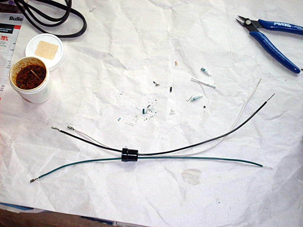

- Posts: 1372
Re: 1956 Zenith Cobra-Matic Stroboscope Changer Transition
I was able to push out the power plug connectors,
from the rear of the plug.
They are held in with tabs that can be bent out from
the metal connector's body.
There was a lot of green crud in all of the holes of
the plastic plug that made pushing the connectors
difficult.
I cut three 12 inch lengths of 20 g stranded wire to
solder onto the metal connector pins.
I tinned a small area of the bare wires right where
the wiring insulation starts, so it
would serve as a stable anchor for bending the
end of the wires through the connector's eye hole
and onto the connector arm.
The wires now go through the plastic connector's
holes easily.
I'll bend out the tabs on the connector pins and
carefully push the pins into the plastic connector body.
Then put a piece of shrink wrap over the wires, solder them
onto the original power wires, and shrink wrap the solder joints.
difficult.
holes easily.

I'm not sure. I keep seeing the radionic/ceramic switchover date as 1954, but my unit clearly has a 1953 build date on it and doesn't seem to have the extra oscillator tube needed to drive a radionic cartridge. It's not been modified either, save for the mounting hardware, the tube layout sticker is still on there and it matches a standard 3 tube amp most of these types of units have. I suppose it must be ceramic.
The good news - I've managed to source a parts turntable that has all the missing parts I need, including the cartridge. I'm not going to delude myself into thinking it's still good, but with a physical reference I can at least work something out to get my unit going in its original configuration.
Given that I've got a full turntable and all I need to pull is the tone arm - to my knowledge, anyway - that means I've got a complete mechanism worth of spare parts, if anyone needs anything. Also happy to provide reference photos to build reproductions now or in the future. Once I get my unit going I should be able to part out the rest if someone needs something to get theirs going.
Just wanted to pose an updated, since Hi-Fi-Mogul had asked for references and whatnot. I'm still tearing into the parts table to get the tonearm off, but I have learned that the correct cartridge for this model is a Pfanstiehl 992, which is still readily available from VM Audio Enthusiasts. I paid around $22 for the variant with a diamond LP needle and sapphire 78 needle. I guess it's the radionic cartridges that are hard to find.
I am sacrificing stereo compliance to use this cartridge, but given the unusual variant I'm working with I'm ok with that. Once I get my unit working I'll check to see if this thing can handle stereo at all.
