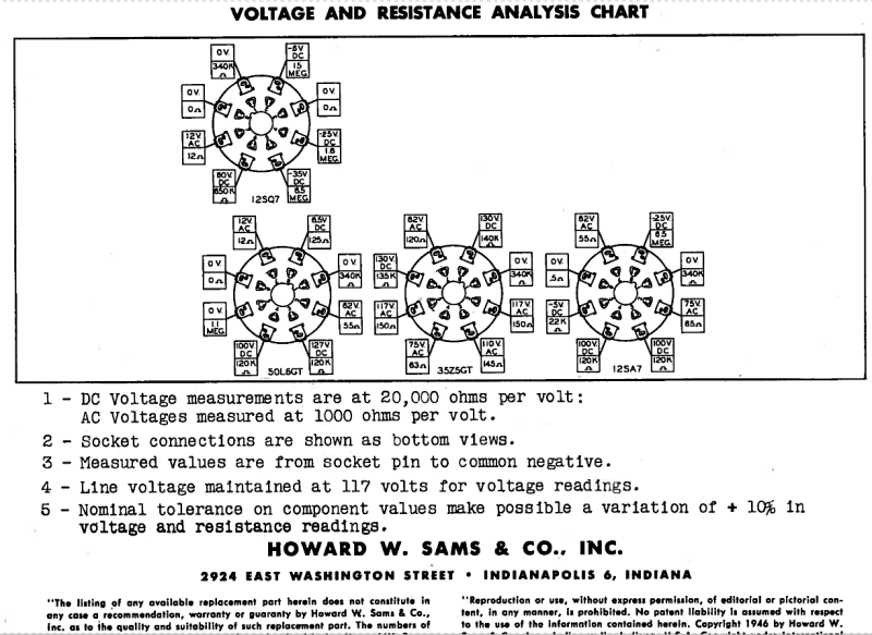

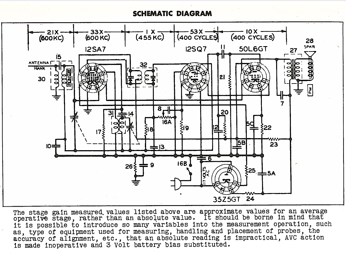

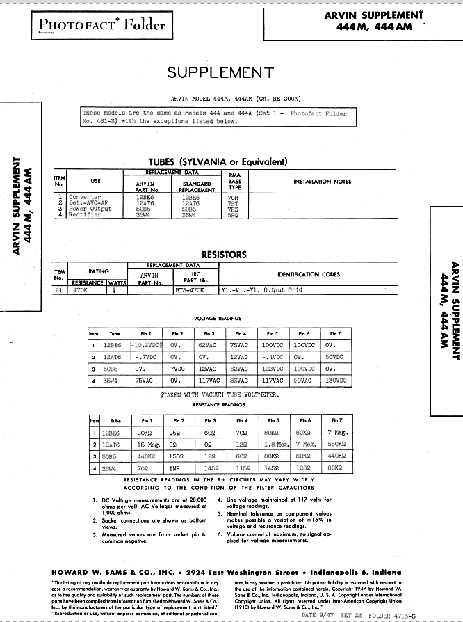

Re: Arvin 444-A
Mr. Mogul, you posted exactly what I need, a resistance chart. The schematic you posted is the Rider's schematic that I already have. The problem I have with the Riders drawing is that there were no resistance measurements listed and there is a "60 volt" specification that is not specific as to just what element should have the 60 volts. I'll print and run that resistance chart and see what that tells me.
Looking further, the voltage readings given in the above drawing are totally different than what is on Rider's.

The schematic was from Sams, a bit different
than the Riders, it looks like.
- Posts: 9077
Re: Arvin 444-A
I appreciate it in whatever form it is. Sams may have changed nomenclature and added their own comments. The resistance chart is the big deal for me. I can't tell you how many times my butt has been pulled from the fire by a resistance chart. Sams was good about that.

I ran the resistance chart on this chassis. I found something out of spec, but I have no idea what it means. I am supposed to have 120K ohms resistance to common negative on pins 3 and 4 of the 12SA7. These two pins check infinite, open, many megaohms of resistance. Pin 6 also checks open to common negative. Pins 3 and 4 have the required 100 VDC B+ on them, and pin 6 still has its 70 volts. This makes no sense to me. How can a pin have B+ with no continuity to common negative? Pins 3 and 4 are the mixer. They get B+ from the primary of the IF transformer. What is going on with this radio? A miswire? This thing acts like a Zenith.......
