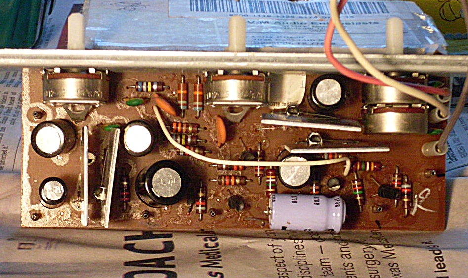

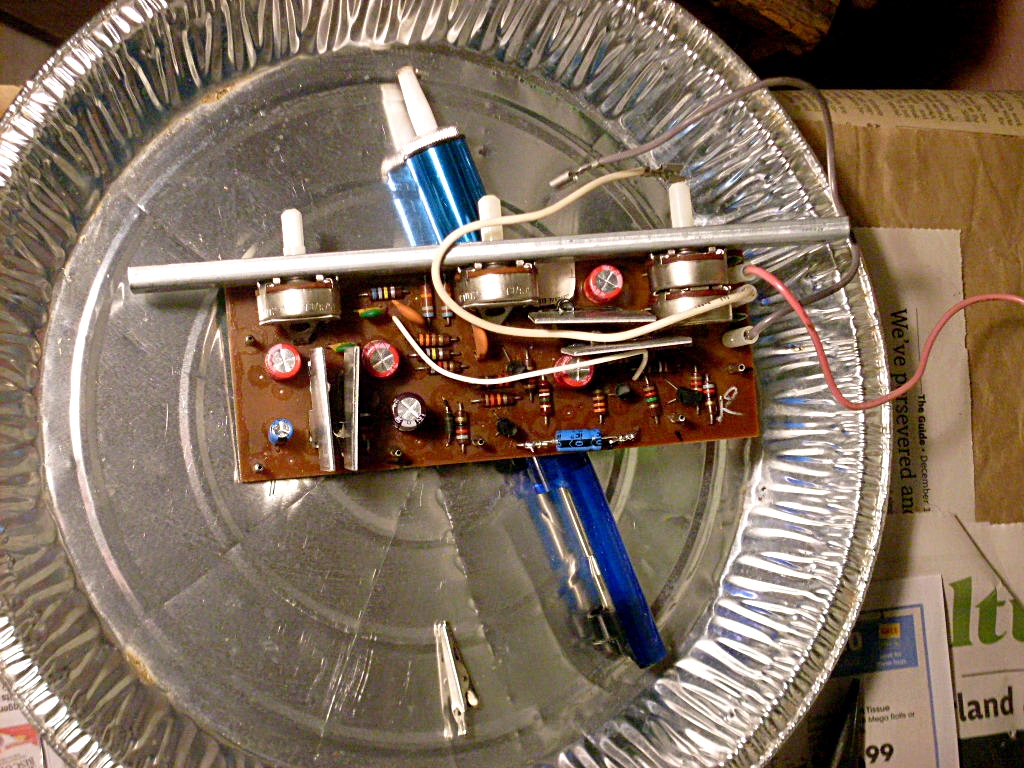

Tonight I re-capped the little GE Wildcat SS amp.
Went very smoothly, after I sat with the
schematic for some days.
Reason being, that this amp is a variant
of the T2N, and none of the numbered
components on the PC amp board
matched the only schematic I could find.
There were also different values for the
e-lytics, but I just numbered each old
cap before I took it out, and it was
easy to match them up on the pc
when I received the new ones.
Photos after & before.
Tomorrow to connect the changer AC
motor wires and speaker wires back
together to the amp, and see how she sounds.

- Posts: 3790
Re: Going to try to start on 2 simple SS record players
Seems to me that my Wildcat did not require recapping, just changer work, so I never looked at the amp. Now I see yours. Those aren't exactly massive heat sinks on the output transistors, are they?

- Posts: 1371
Well, the hum is gone, but the left channel is
not as strong as the right.
At this point, I'll try a new cartridge, in case the
original Astatic one is the culprit.
I'm not interested in going further
with trying to diagnose/replace a transistor.
I might return to it, after I get a few more
tube hi-fi's up and running.
Or, it might go as a gift to a youngster,
for their first record player.

- Posts: 1371
Hallelujah, it was a bad cart !
Playing some Herb Alpert on this little
1967 plastic record player.
It sounds good for what it is.
Always rewarding to see a project finish
well.

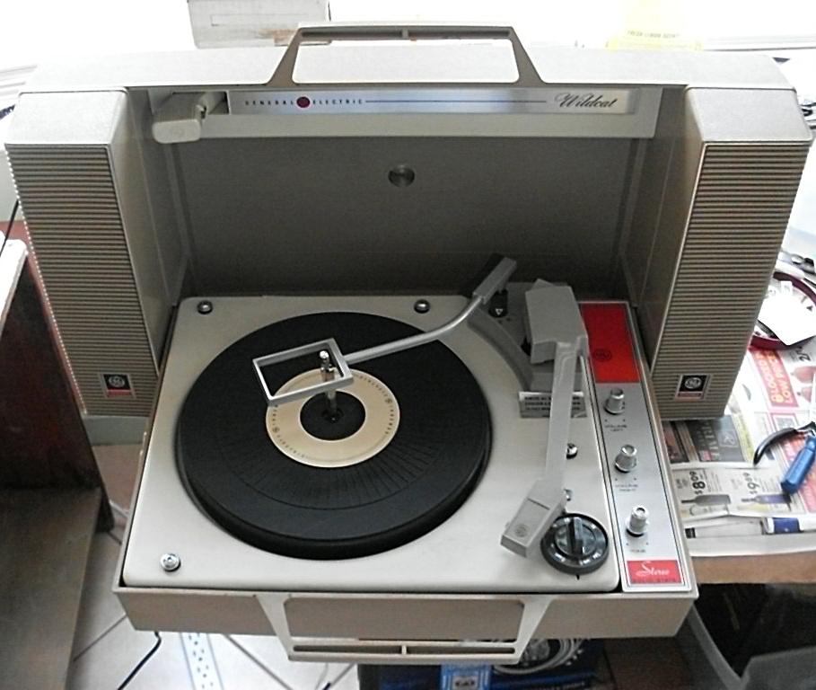

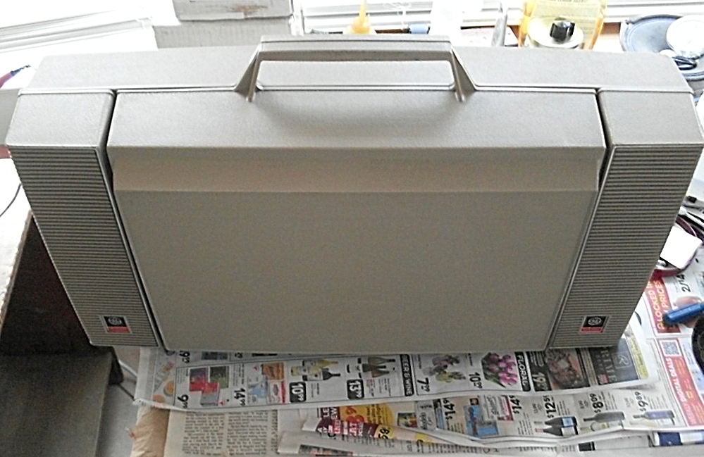

- Posts: 1371
A couple of photos.
Ms. Wildcat is all cleaned/tweaked and ready to go.
Something nice is the original 45 adapter
was still with the player.
- Posts: 5523
Interesting, your Wildcat is different than the one I worked on. Mine only needed changer work so for me it was easier than dealing with SS that I have never tackled yet. The one I worked on had the controls in front of the changer, a toggle type switch that I can't remember what it did, and I think a place to plug in head phones. Either they made different levels of the Wildcat, or, they were from different years? What really got me was how simple they came apart. The one I worked on, everything plugged in. I did not cut one wire to take it apart and everything had to come out to get the changer out. Why didn't all manufactures do that? I know, the bean counters!
