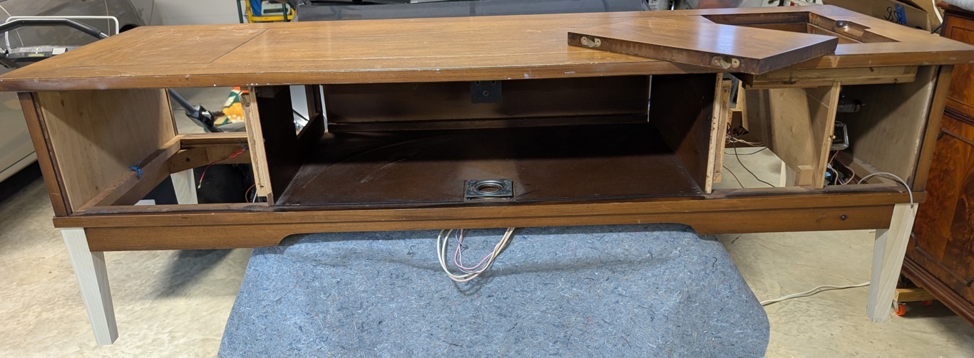

The legs screw in, should be easy to remove, but you have to remove those masonite bottom panels to get to them. I agree that grille cloth would be better looking, just have to get the right color!

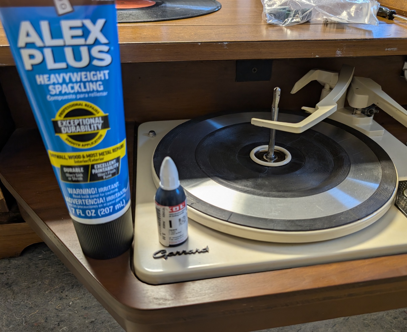

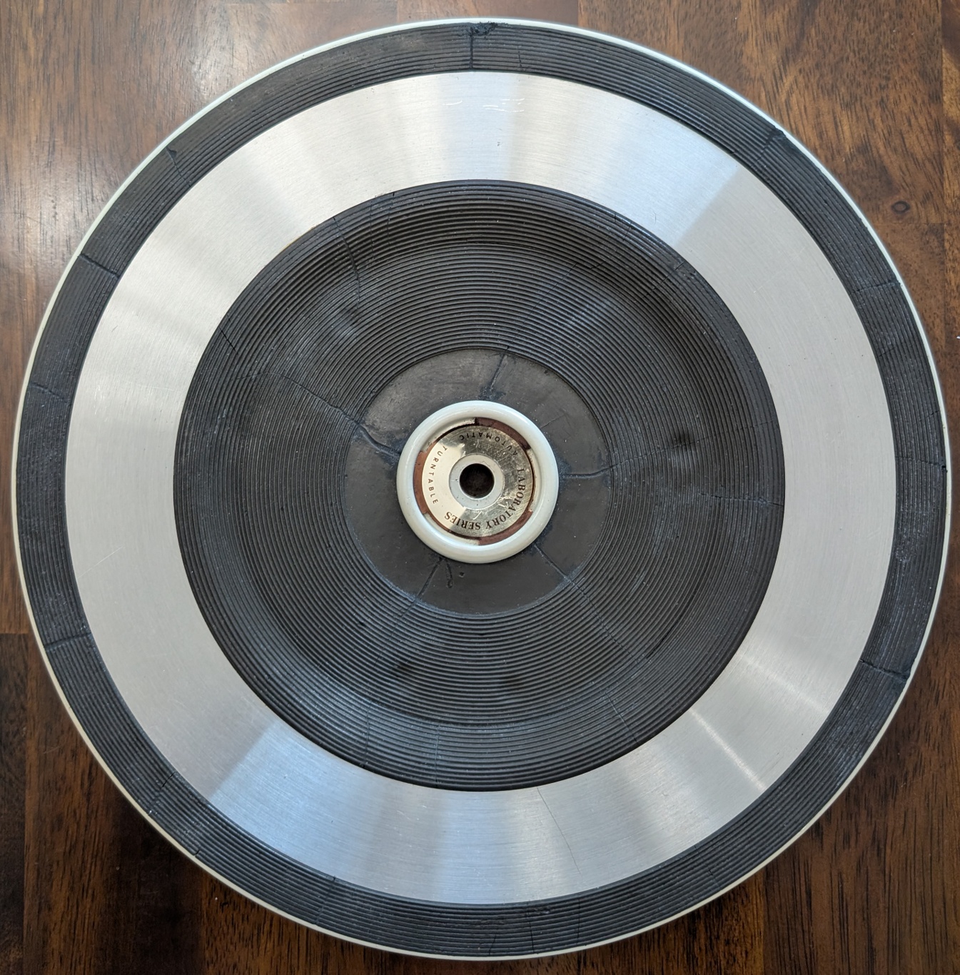

Decided to attempt cosmetic repair of the platter, and if that didn't work, cover it with a generic rubber mat. The original rubber is rock-hard, and has shrunk, creating radial cracks, allowing the light color paint underneath to show through. Maybe was stored in a hot attic for a long time; fortunately the cabinet is still in good shape.

After ruminating on various types of materials to fill those cracks, I decided on spackling compound, tinted black. I used an Exacto knife to work the stuff into the cracks, letting it set for a while, then wiping with a damp paper towel to get most of the excess off.
I'm happy enough with the results, it's not like new, but significantly better looking now. Before and after photos:

Wow, that worked out well and it did not cost you much money.

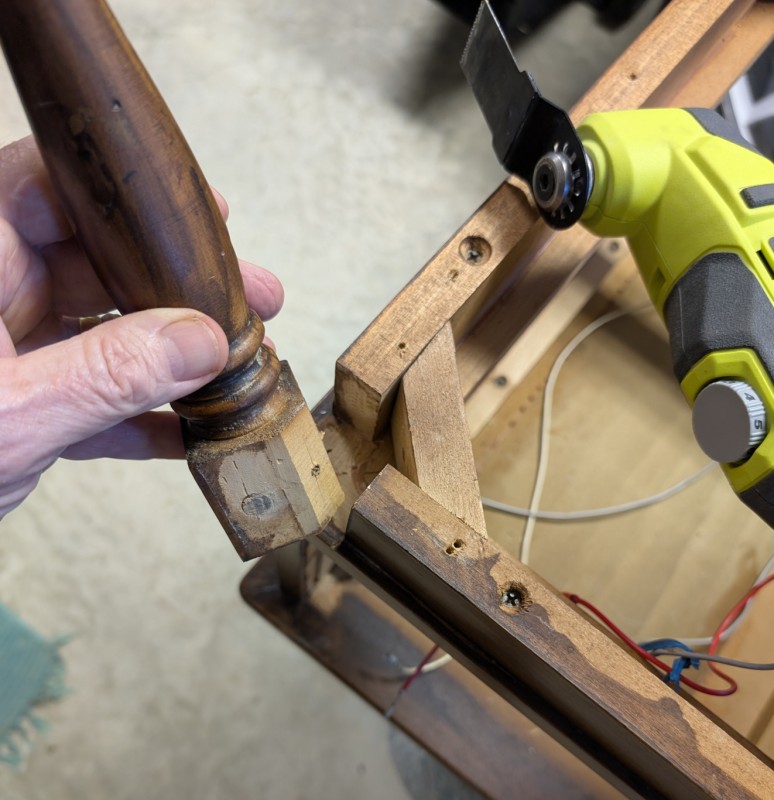

Currently working on the cabinet modifications. I got the legs off, turns out that wasn't as easy as I first thought, they were doweled in, got them off without damaging the cabinet, thanks to my plunge saw (amazing tool, only have had it a year, but it has really been handy). I've continued to be impressed with the quality of this cabinet, every joint is solid!
Also have removed all four of the the louvers, added a new 15 foot polarized power cord, eliminating the interlock. I had noticed a slight tingle when touching the chassis (while standing on concrete garage floor), went away when reversing the old plug, so there's some mild leakage somewhere, pretty common.

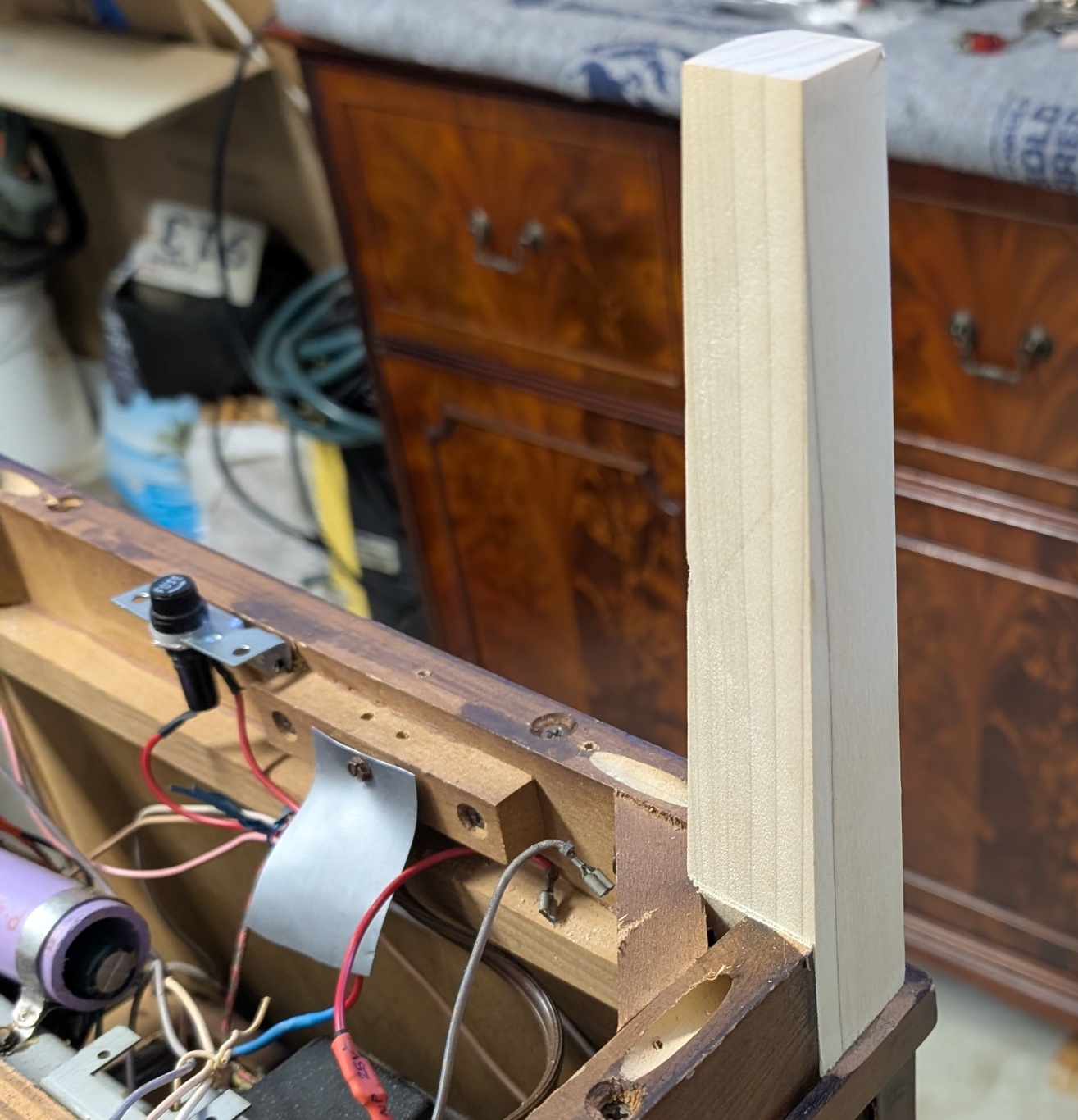

New legs fabricated and installed. Pocket screws replaced the original dowels and glue, since the dowels were originally assembled with the lower cabinet rails which are screwed and glued. Legs are 1.5" square at top, taper on two sides down to 1"square at bottom.

Nice job on the legs!! Getting the taper right isn't easy...

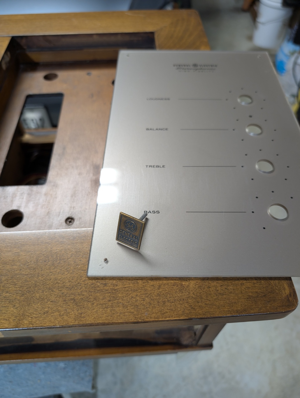

The control escutcheon is just a piece of clear acrylic, steciled on the back, with gray paint over that. Good idea to protect the markings from getting worn off, I guess. It's in pretty good shape. Knobs are plastic, too, but the GE emblem on the front is a nice piece of die cast metal. Extra holes are for the model with the tuner.
