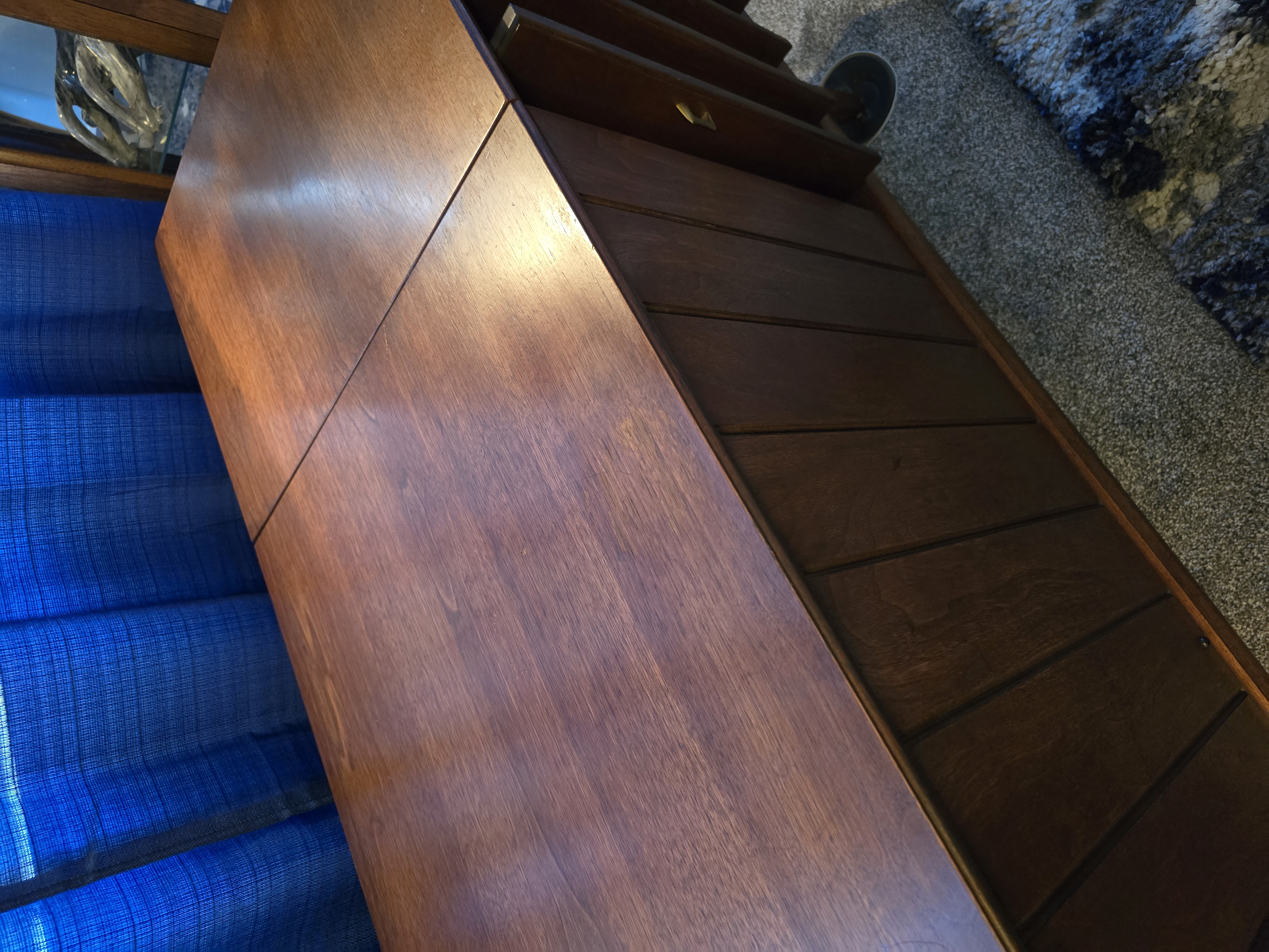

I suspect the Old English is darker than the Howard's. Would it make sense to use the Old English first to stain the light spots first, and then follow up with Howard's? Or just pick one and use it?
Charles
USAF Veteran
Posts: 5361
Re: Finish...
Post: # 22436Post William »
I would probably use the Old English first and see what it looks like, see how well it covers the bad spots and then go from there.

Post: # 22509Post chazglenn3 »
It looks better but it still bothers me. I might have it professionally repaired. A local guy will come by and take a look at it next week.

Were you unhappy with your results because of color mismatch, different texture, or what? If the color is right, try hitting the whole top with 50/50 boiled linseed oil and turpentine. Some make it 1/3 each of those plus 1/3 white vinegar. Or shellac with an artist's tiny brush and then a light scuffing with 4-0 steel wool.
or show us a photo of current status so we can see what's wrong.

Post: # 22526Post chazglenn3 »
I think it's mostly the texture and a little bit the color. I'll take some more photos tomorrow and post them. I need to update my post in the Zenith forum too. I can see the difference in the texture from across the room but barely notice it when I'm standing right in front of it...

Keep in mind that when we are in charge of projects, we are acutely aware of each and every defect. Nobody else notices, except maybe the occasional expert. I have a lot of varnishing on my old sailboat each year and there are always issues--crud, holidays, runs. What others see is mostly what turned out right.
If you are thinking about paying somebody to do it, then you might as well experiment a bit. Try some darker stains for color.

Post: # 22538Post chazglenn3 »
Pictures
