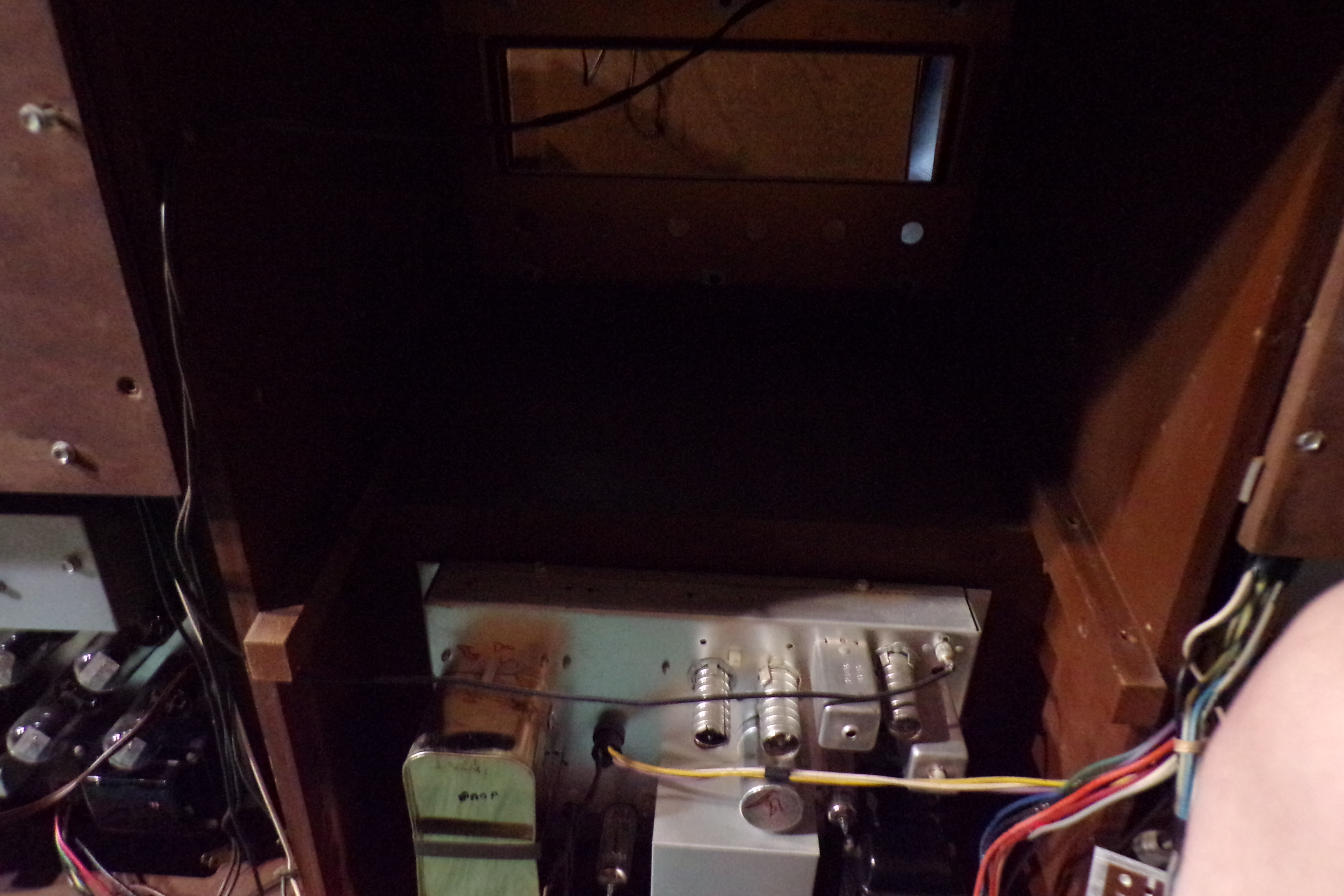

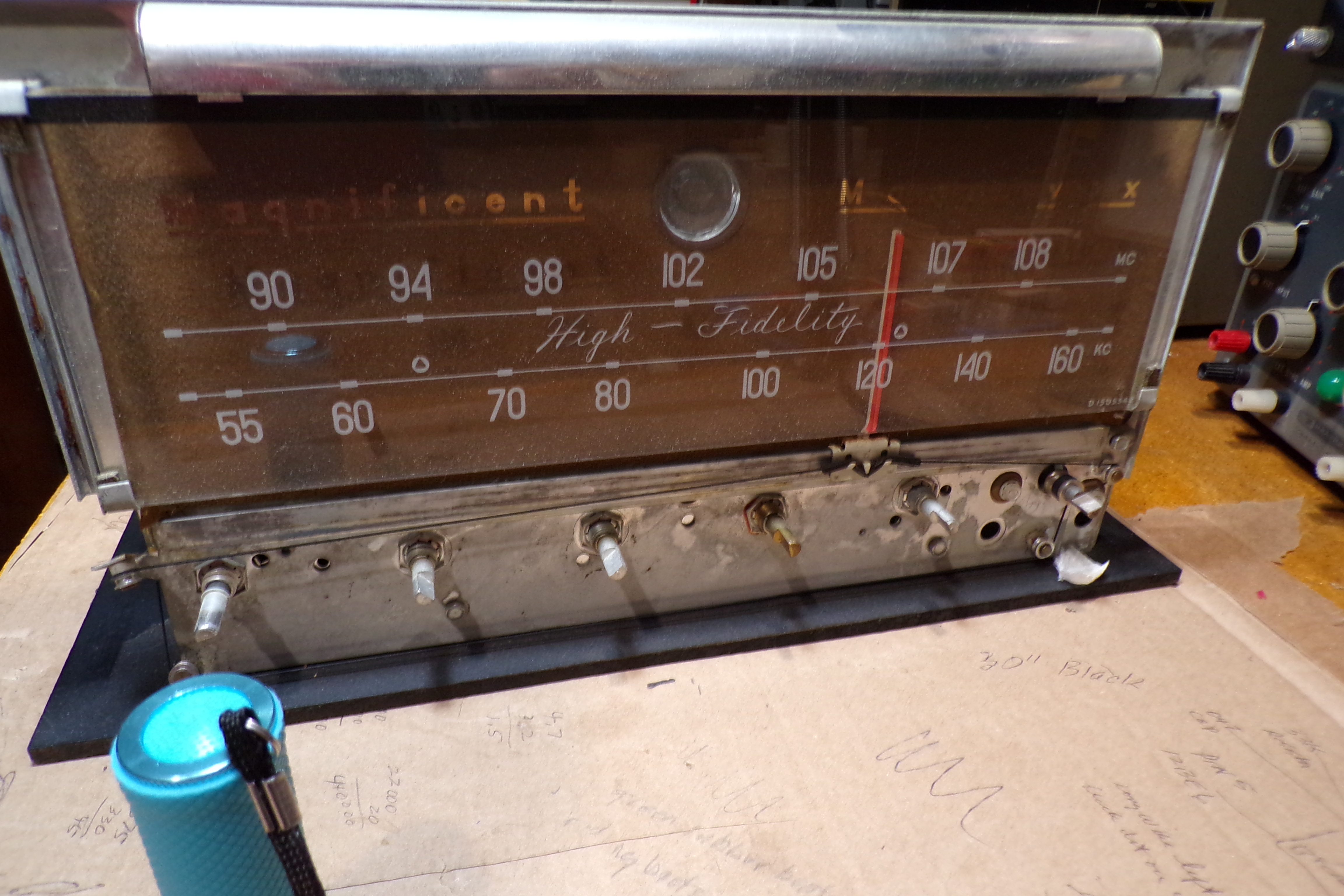

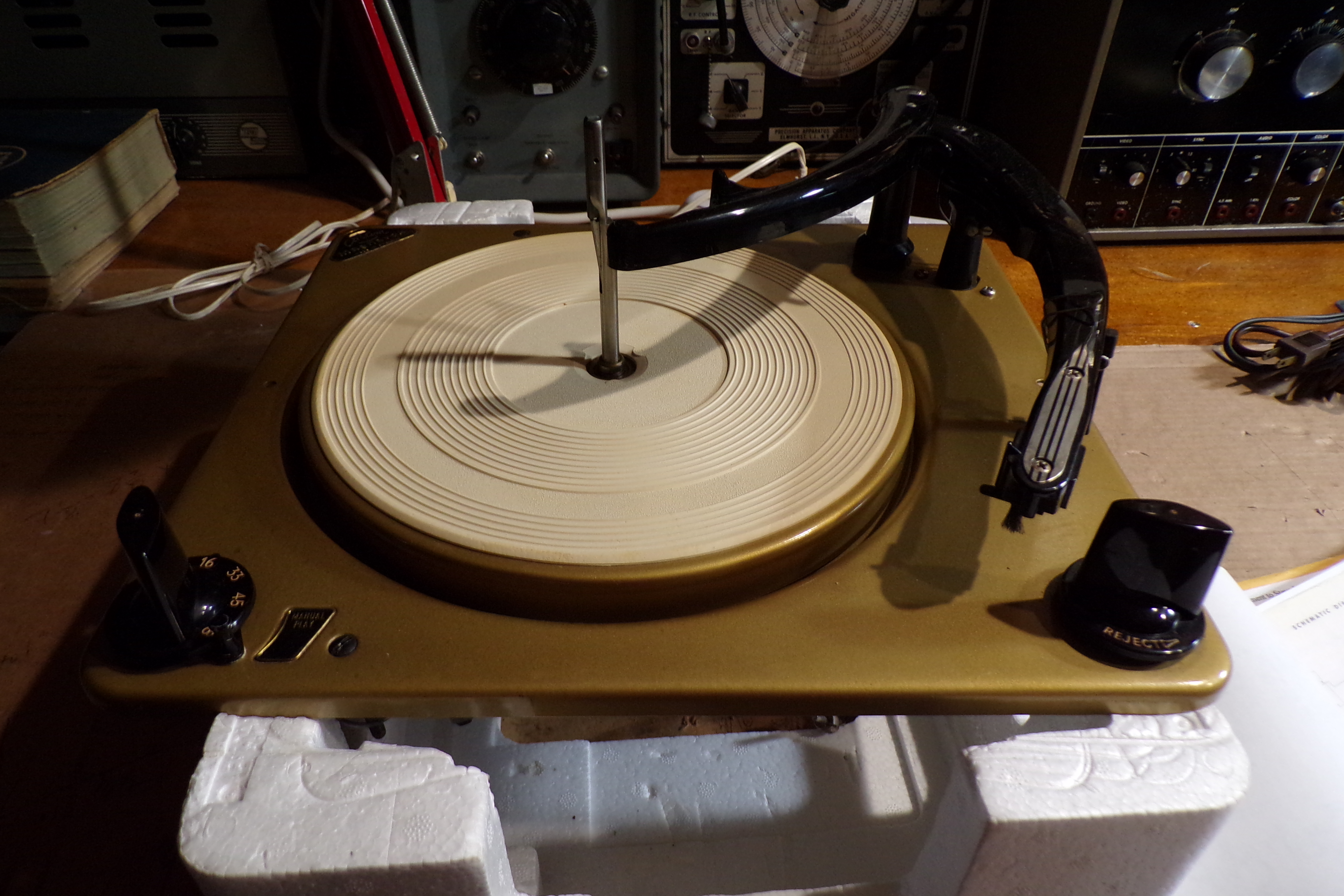

Re: 1960 Magnavox Concert Grand model 1ST800F rehabilitation
I finally got caught up enough around here to get on this project. I have the changer and tuner/power supply/MPX assemblies out. My challenge with the changer is that the upper bearing of the motor is really stiff. If I don't run it for a month or so, the motor won't start without removing the platter and giving the motor shaft a twist to get the motor started. I need to completely remove the motor from the changer, take it completely apart, clean it WELL, put it back together, then pray I get the fan and turret back in their right spots, and that I have not bent the fan. I've read where taking the motor apart may be a fool's errand, but, in this case, I don't see a way around it. Then I need to figure out why the tuning eye doesn't deflect, just sits there. I need to check resistors R342 a 15K, R345 a 470K and the likely reason for no deflection, R206 a 1.5 MEG, and R208 a 2.2 MEG. There is also a .1uf cap that I need to check and maybe change, even if it has already been changed. Then I need to test all the tubes in the tuner and MPX.

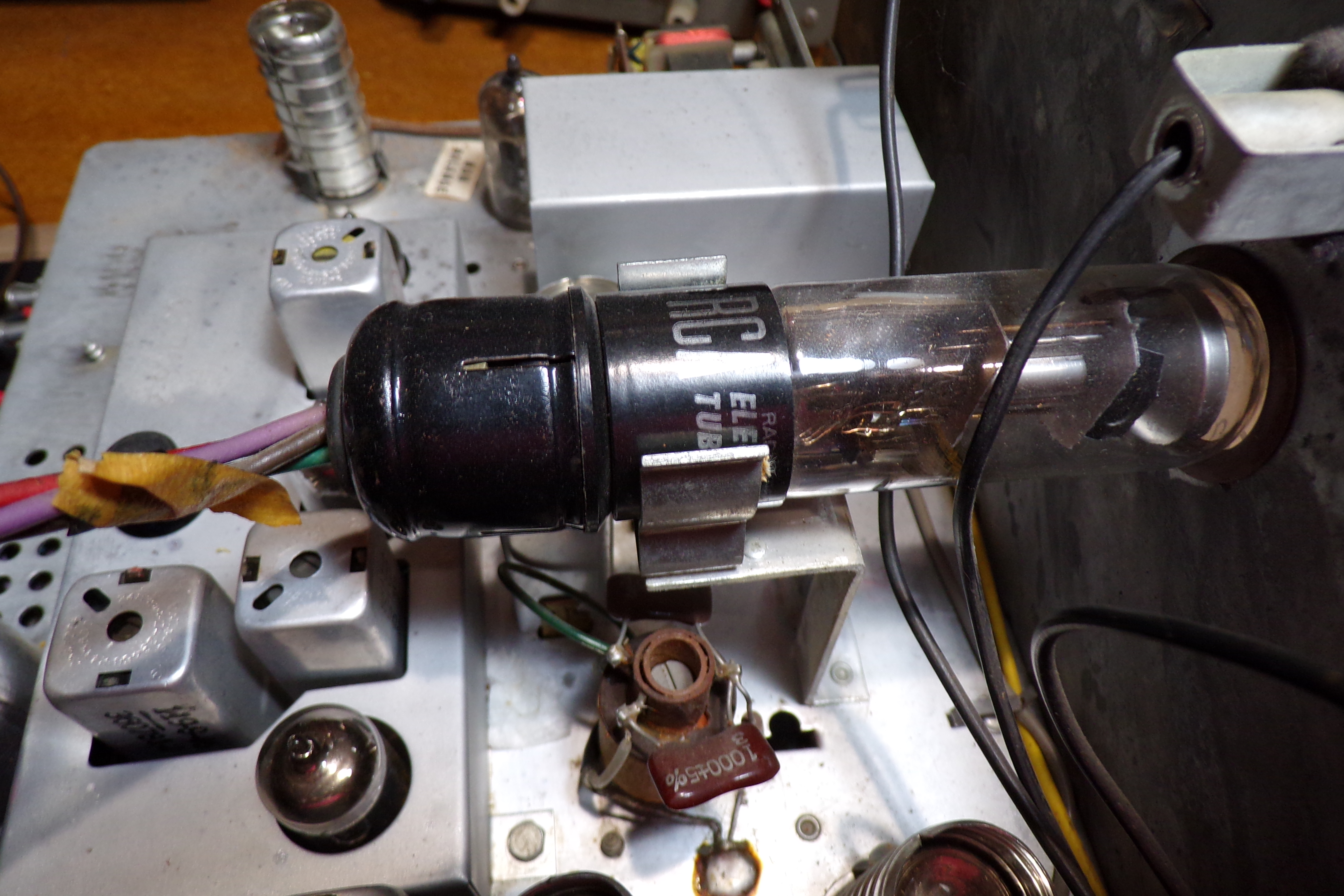

I measured the 470K resistor in the eye tube circuit, from pin 2 to pin 4 of the 6E5 eye tube. It measured over 3 megohms. The socket on the eye tube is designed to be serviced without being destroyed. If you notice the slots in the tube socket, you put a thin screwdriver in that slot and pry the socket up. Once you get it started, you can use a thin blade to pull the socket out of the base. It starts coming hard, then pops out all at once. I got the 470K ohm resistor changed and checked the other three, which checked just fine. The tubes all checked good. I have the tuner ready to go back into the cabinet. Next up will be the phono motor.

I have the tuner, power supply and MPX all back into the cabinet. It may just be my ears today, but I could swear I actually heard some bass responce today in my old CG. I replaced the cathode follower 12AX7, but that wouldn't affect the bass response any. The good news is that the eye tube now works like it should. The dial is off somewhat, but that seems to be a feature of Magnavox tuners. Some frequencies it seems pretty close, others it's way off. I have the changer rigged up so I can get the motor out and get it cleaned.
This particular Collaro changer has the remote control components to deal with, so it has a few more goodies than others have. My goal here is to remove the motor with a minimum of drama. Then I'll decide what I need to do otherwise. It works fine. I'm sure I can fix that, though.....
- Posts: 9026
The motor on this particular changer is different from the other Collaro motors I have worked with. The "shift" mechanism is built as part of the motor housing. There is a plate on the bottom end of the motor that comes off so the rotor will drop out of the motor. I had to remove the cycle drive tire, the turret and fan (gentle as she goes there boys!). Not really any drama so far. The next stab I take at this project will involve removing the plate on the bottom of the motor, then find out if I can get the rotor out. The upper bearing is really sticky. Let's keep a good thought......
