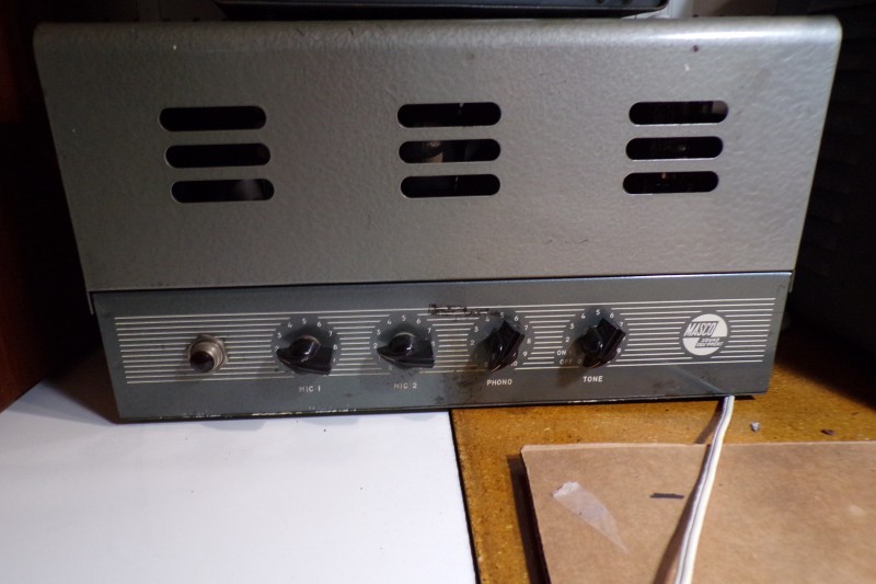

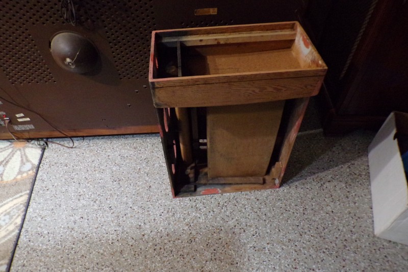

You have better eyes than I do. I looked and looked at that picture, trying to find something that might be close to what you are referring to. In the dark, on the left of the speaker box I was photographing, is the little Lafayette signal generator sitting on top of an old Masco PA amplifier. It was my stepdad's. I have never plugged it in. He told me it was 100 watts, but I seriously doubt it. He got it from a Methodist Church in town when he upgraded their system sometime in the 1960's. He installed a multi-channel Bogen system and kept the old Masco. Masco stands for Mark A. Simpson Company. It has P-P 6L6G out put, a couple 6SJ7 amplifiers and a 5U4G rectifier. Huge iron, but I don't know what they would be good for since it is not stereo. I've kept it because it was Sam's. The inputs are antique and nothing more modern will work with them. Those would have to be changed to use it. The thing is in nearly pristine condition, spending it entire working life in a church. I figure it is from the 1930's, but I don't know that.

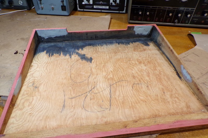

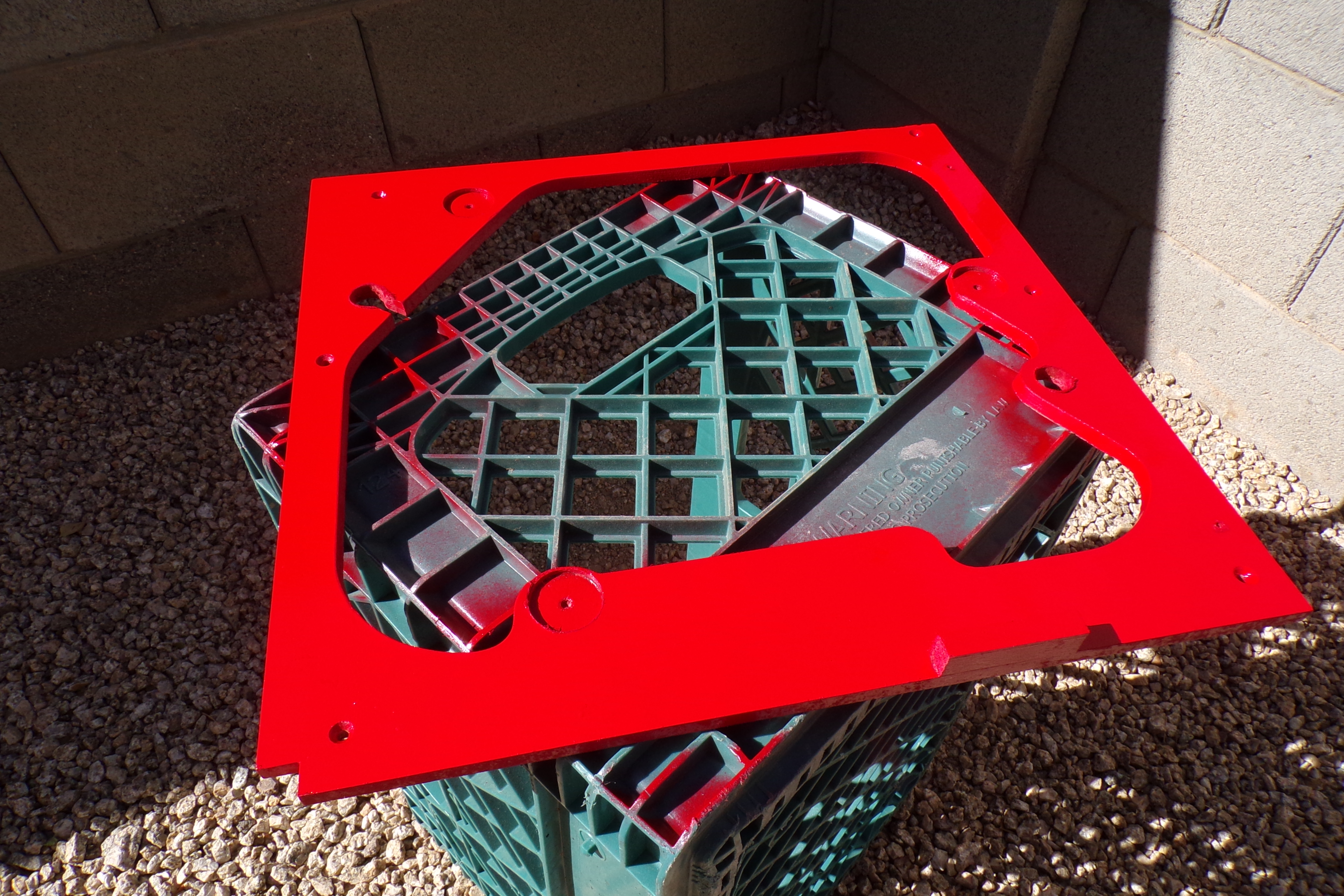

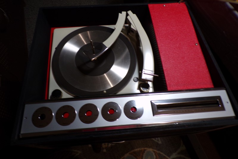

I have the lid done. I took some pictures to share.
Motor board (plinth) painted red. I may change my mind on this. I wanted it brighter, but not gawdy.

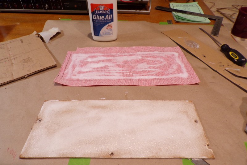

Next two photos show installing Tolex on tube cover panel, then the final product.
The old Masco PA amp Chris asked about.

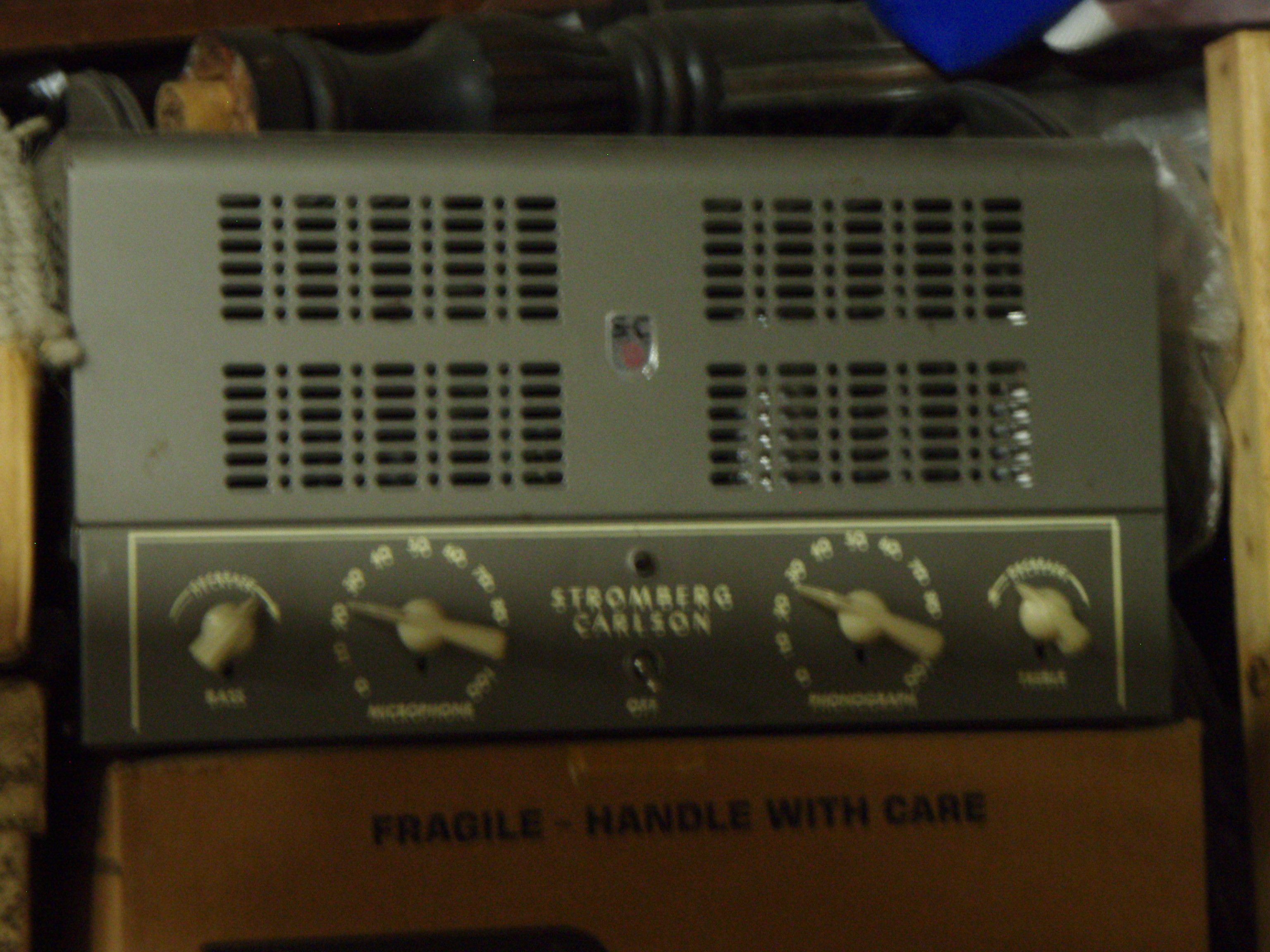

Yours is a bit smaller but has more inputs. Here's my Stromberg-Carlson AU-36B, a big one with 4 6L6s in parallel push-pull. It was an auction buy, part of a mound of misc. stuff. Sorry about photo quality; low-light conditions in the garage at night.

Trying again on the photo

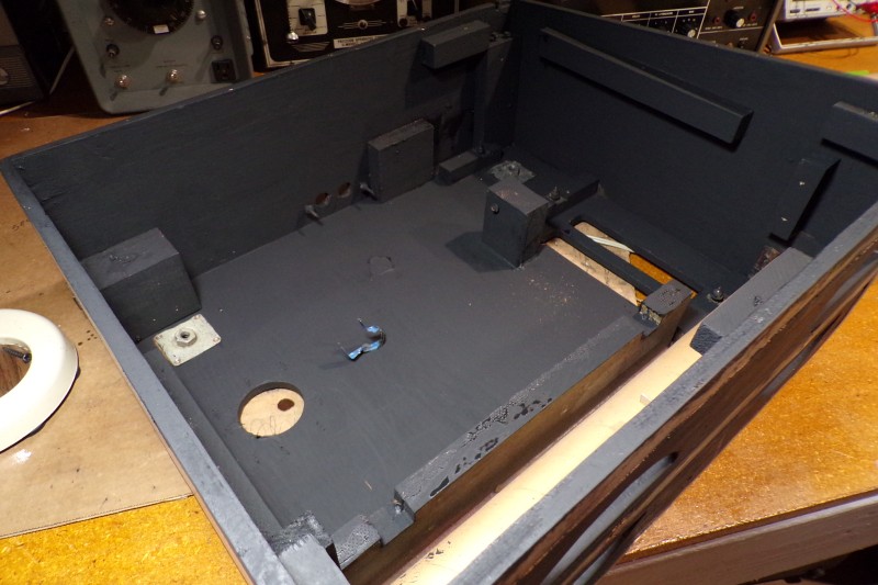

I found some matte (flat) paint at Walmart that I'll use on the inside of the cabinet. It is an 8-ounce bottle which should be more than enough for the job. If I have enough, I'll do the insides of the wing speaker boxes as well. This procedure will hide the black water stains.
- Posts: 8933
Re: General Electric RP-1590 stereo cabinet restoration

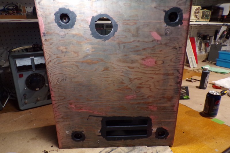

I have painted the inside of the cabinet flat (matte) black. This will be similarly done in the lid and around the edges of the speaker boxes, on the front edge, where the Tolex bends. I have also painted the cutouts in the cabinet and around them a bit so that any mis-cuts on Tolex won't show as badly. I took the liberty of mocking up some of the components in the cabinet just to see how they look. I think it's going to be alright. With the inside of the cabinet painted black, it makes the picture pretty dark. I apologize for that, but it will give you an idea what I'm doing.
- Posts: 8933

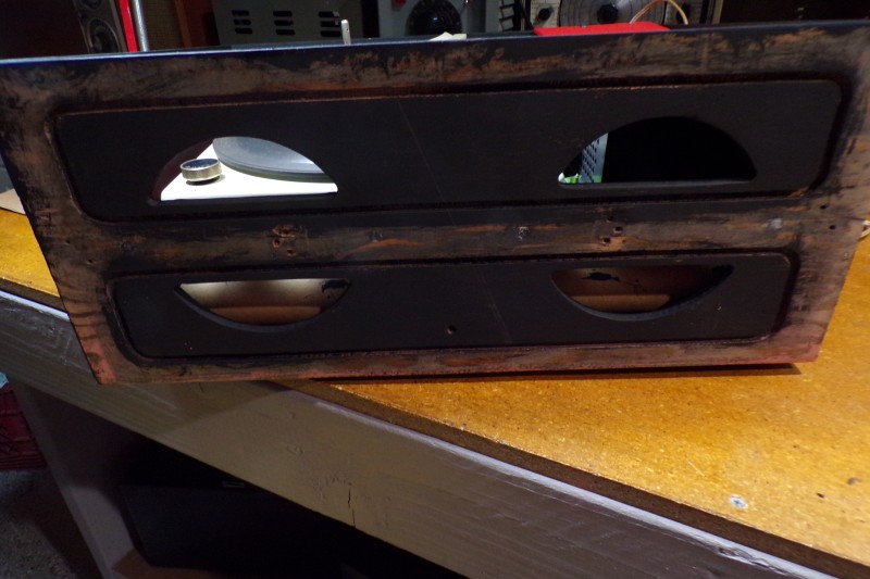

I decided it would be best to paint the entire front of the cabinet. I paid special attention to the groove for the piping. This groove is in not very good shape. It was poorly done at the factory. Getting the cabinet wet caused the cut grain to be unstable and it wants to fall out when you run a paint brush over it. I put a thin layer of Elmer's glue in the piping groove in the effort to stabilize the end grain. I had planned to glue the piping in over the Tolex and grille cloth, so this will further stabilize the area. The piping groove in the wing speaker cabinets is fine.
