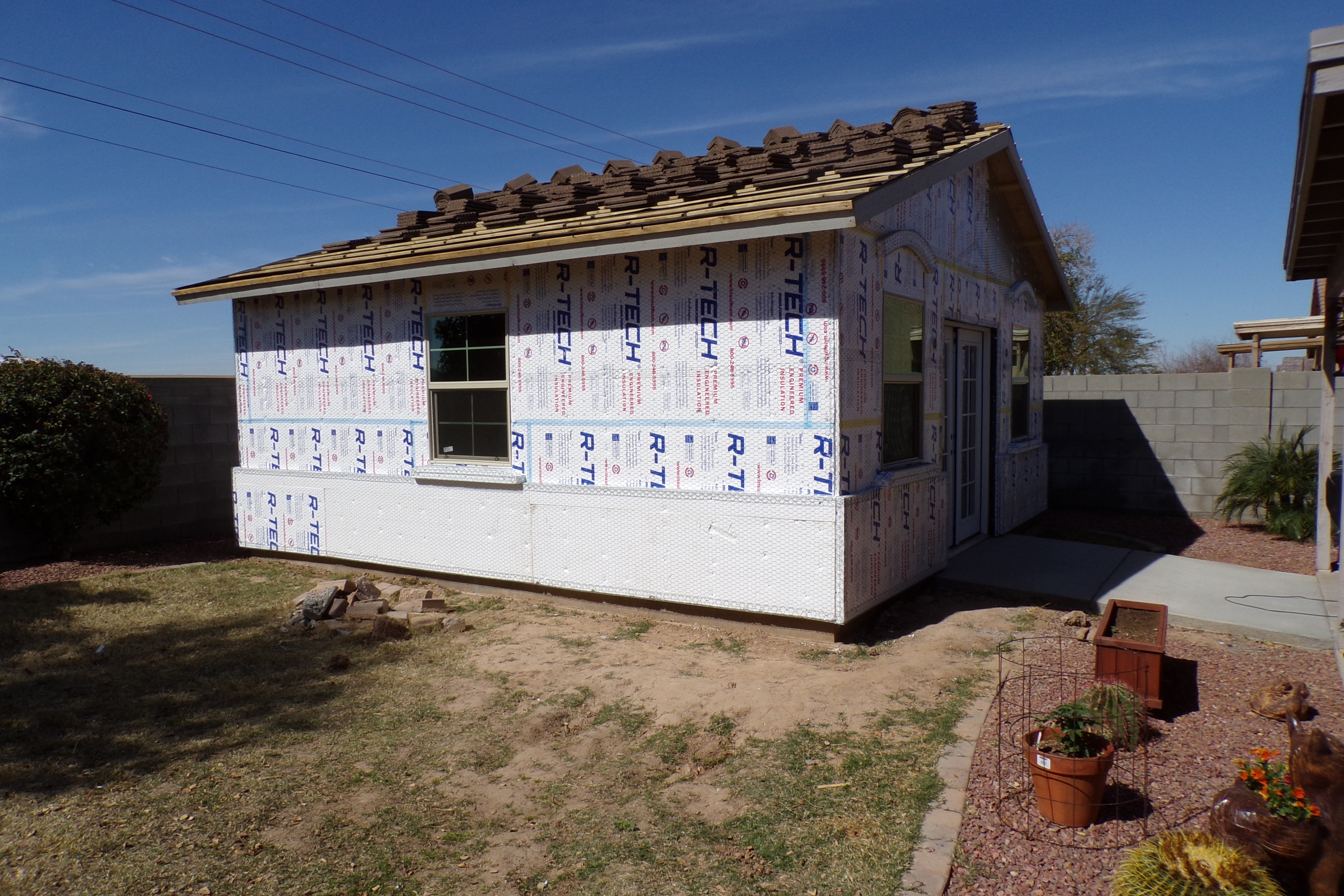

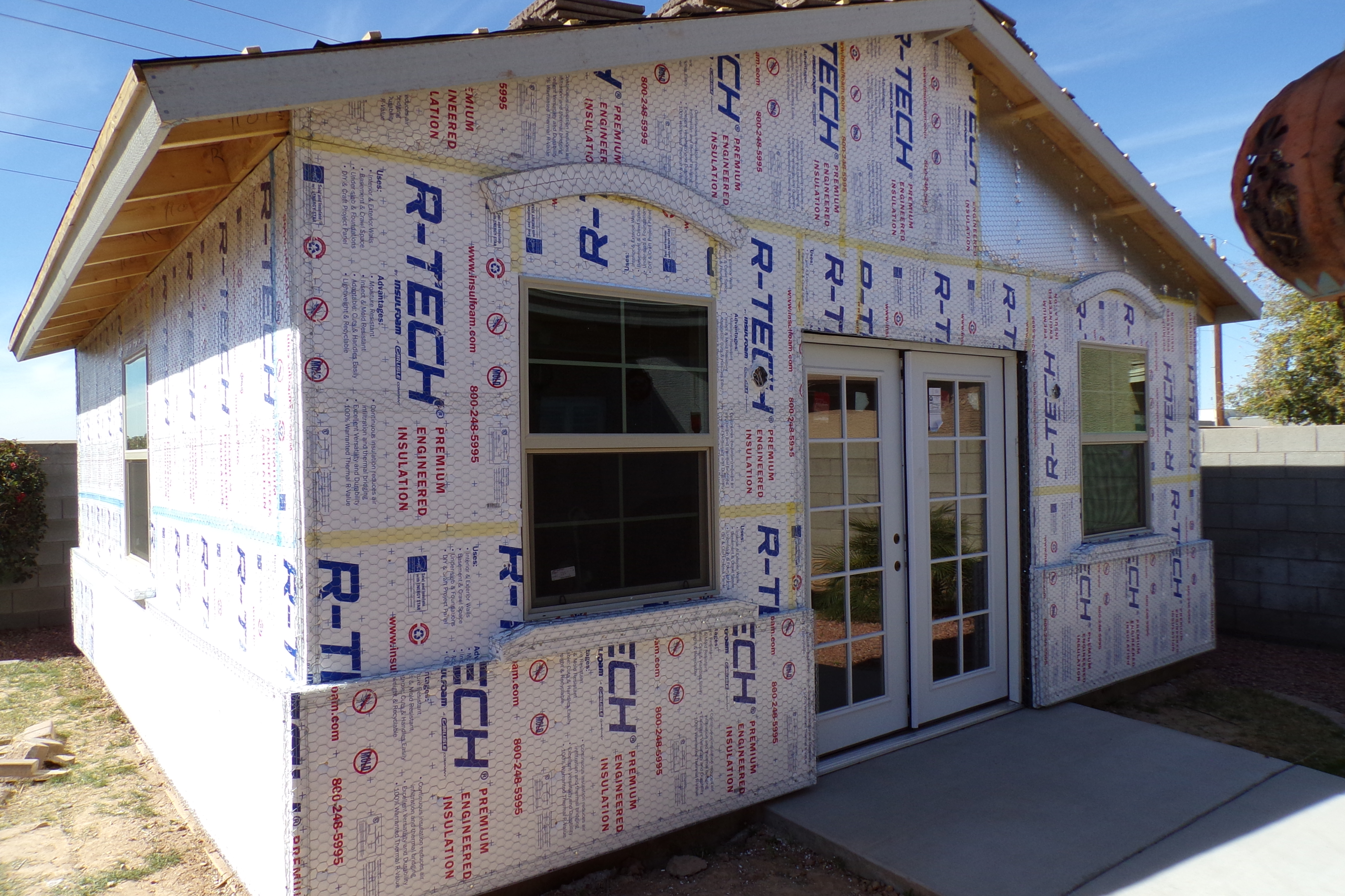

Pictures. One guy did the foaming. Styrofoam is not heavy, but still..... ;)
The 1" of styrofoam ads an R value of 5 to the insulation on the walls. The popouts are two more 1" thicknesses of styrofoam nailed on, then they put wire mesh on those. The electrician obviously didn't look at the plans when he put in the outside outlet. He allowed for the 1" of styrofoam, but did not consider the additional two inches for the popout to the left of the French entry doors.

Post: # 5804Post 19&41 »
That is built like the proverbial brick house! It's coming out nicely.
Post: # 5807Post William »
The eyebrows about the windows add a nice touch. You didn't want to plug anything into that outlet anyway, did you? :roll: :) It's looking good!
Post: # 5810Post electra225 »
Wonder what the inspector will say about wires that disappear into the wall........ ;)
The eyebrows and popouts are there to match the house. Gotta match the house to satisfy the HOA. :roll:
