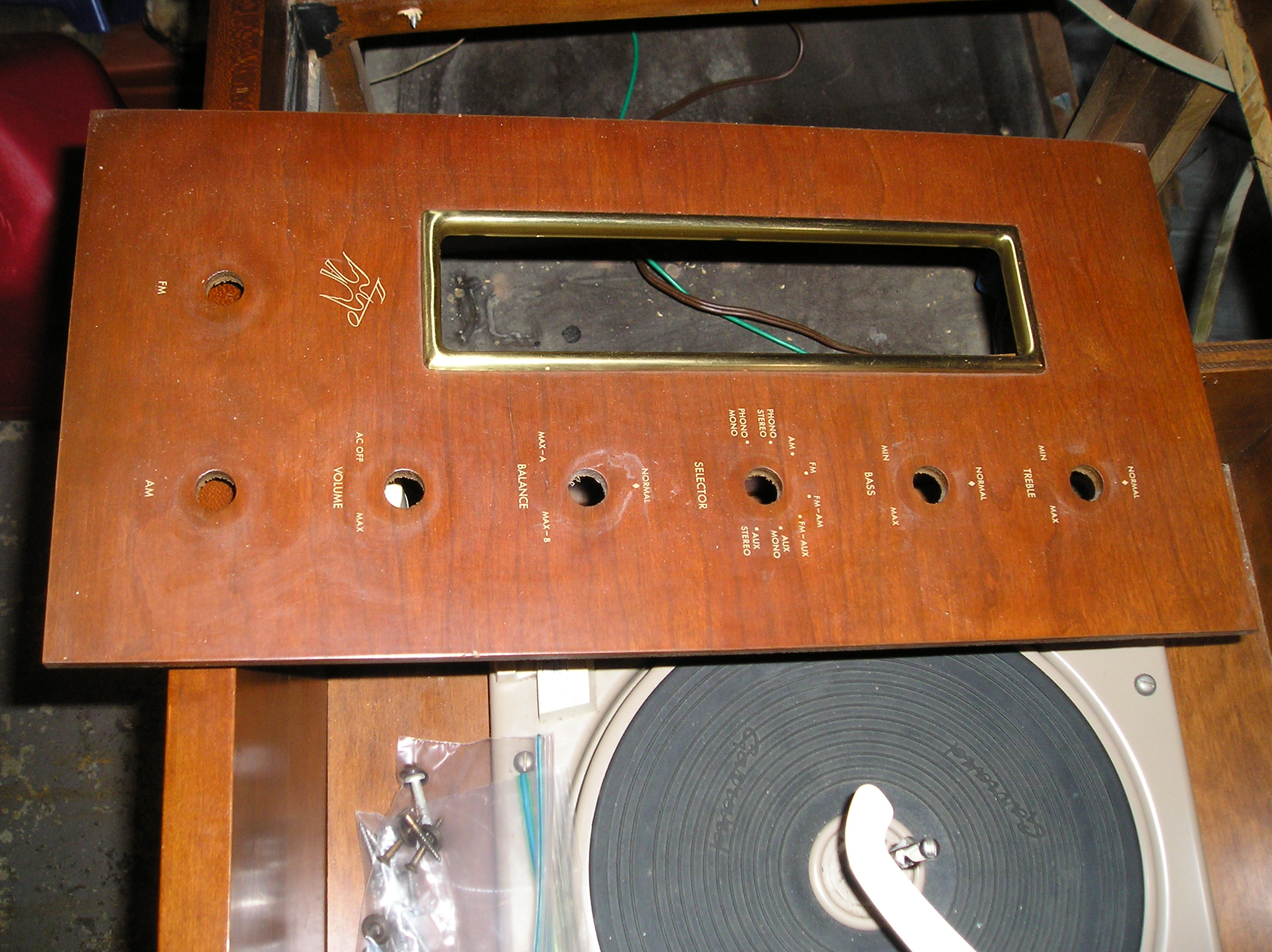

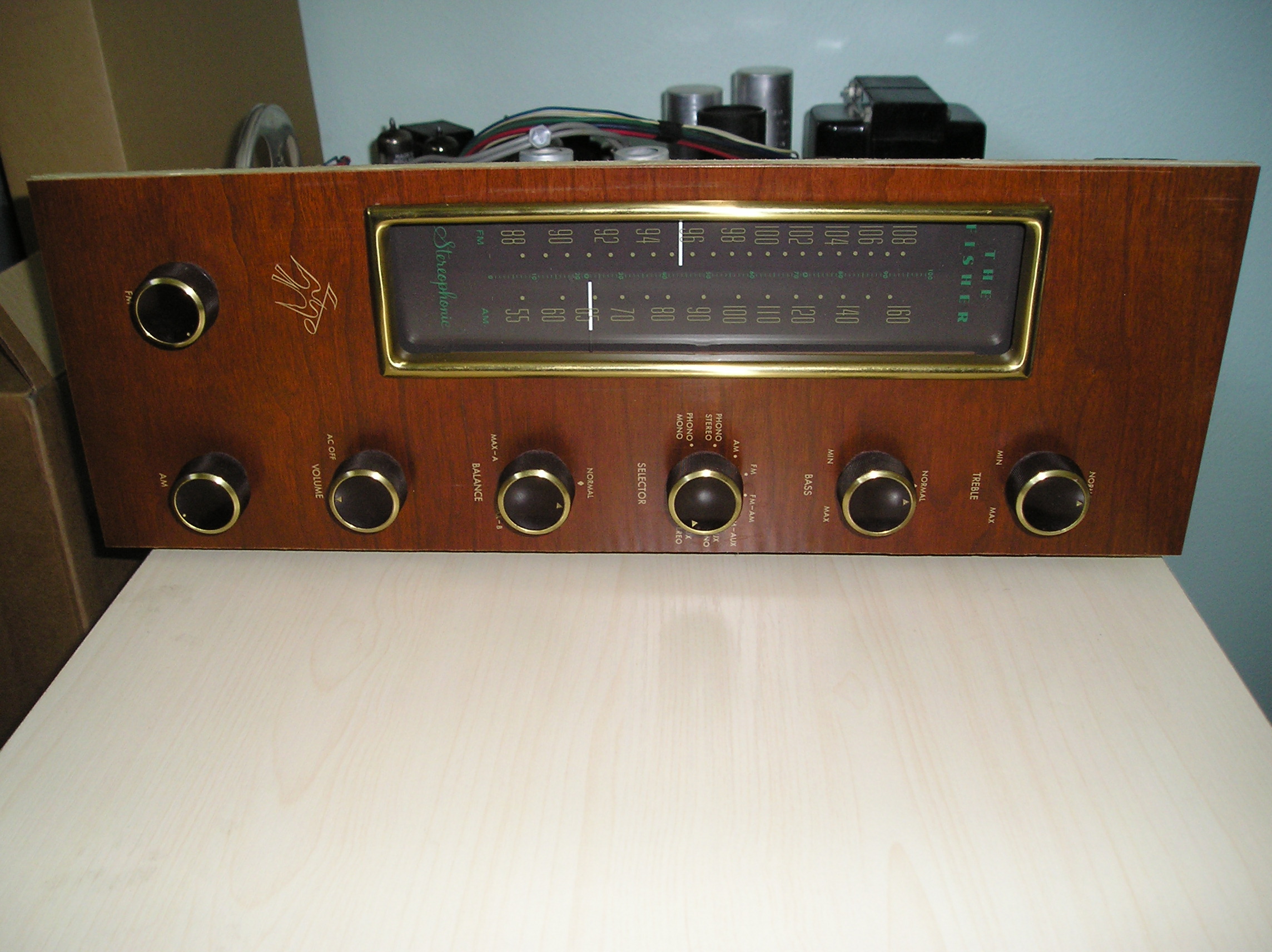

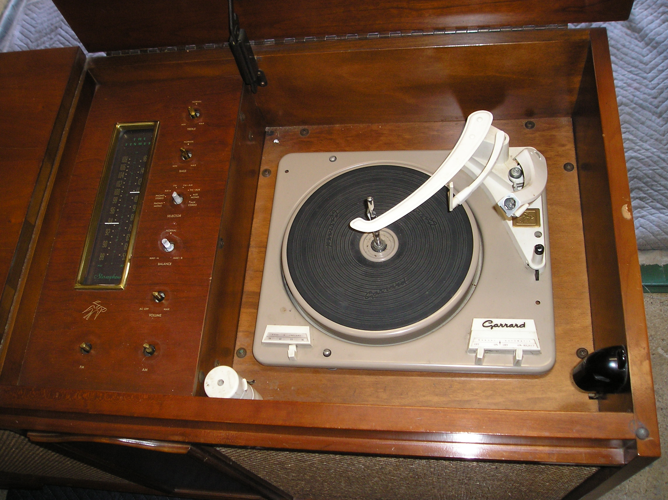

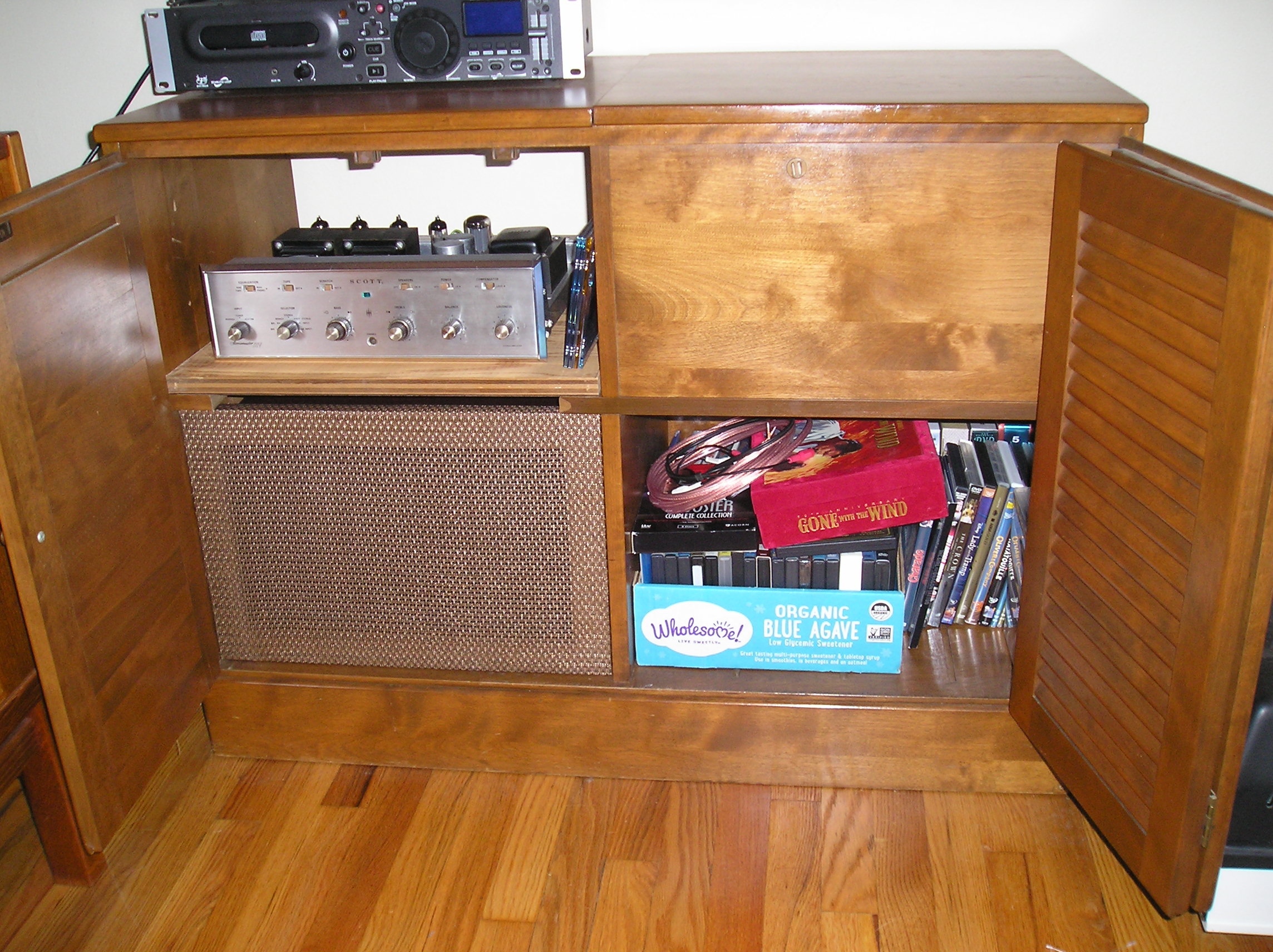

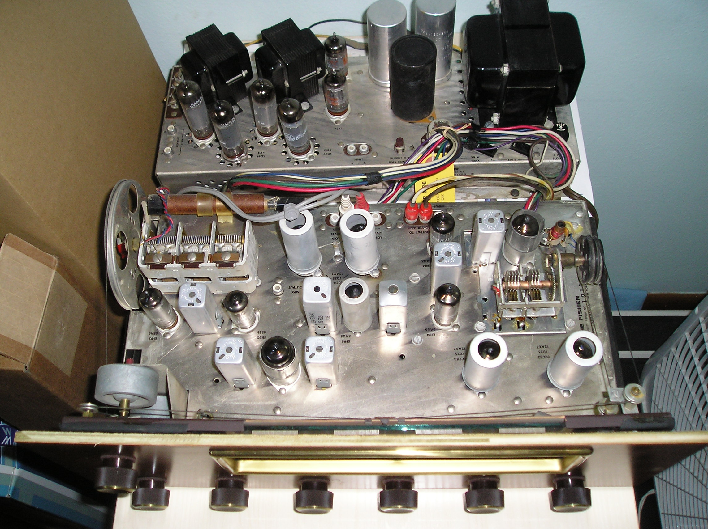

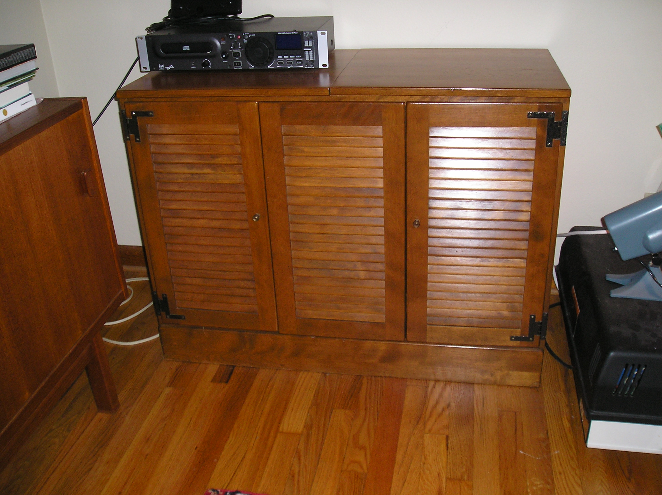

Well, decided to install the recently moved Fisher Custom Electra IV amp & preamp/tuner into a smallish Ethan Allen HiFi cabinet (sold empty with no components) in the LR that we picked up a few years ago. I originally put my Scott amp in it, hid a small ADS speaker in one compartment and used the other one freestanding, and a Phillips TT in the lift-lid compartment (see 2 pics). The first pics are of the Fisher CE IV components after removed them and I cut down the control mounting panel then re-installed it ala a component so they'll fit concealed in the cabinet.
Lately the Scott and ADSs have been used in my "office" sitting on a dresser cabinet, while the living room EA cabinet houses the wife's tablecloth collection LOL! Our DuMont console is on another wall. The FIshers being "naked" kind of lend themselves to being concealed so it makes sense to stick them in the EA cabinet and use them with the Phillips TT.
