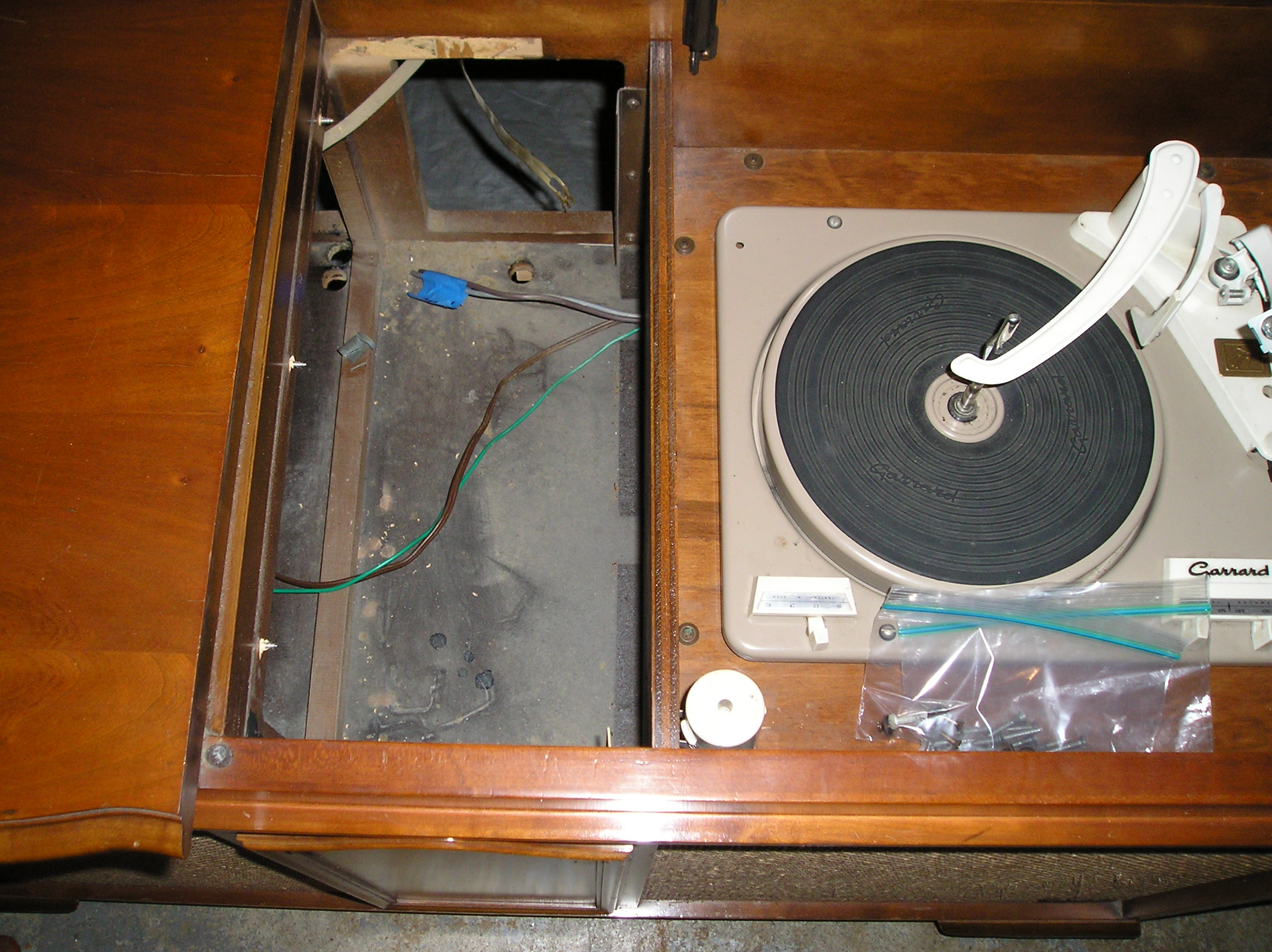

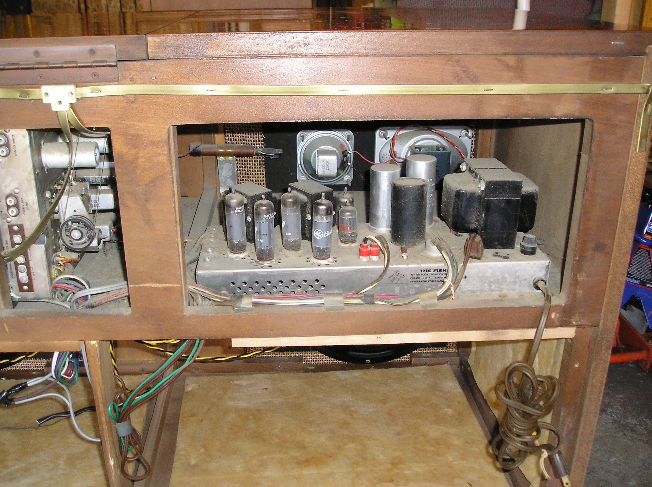

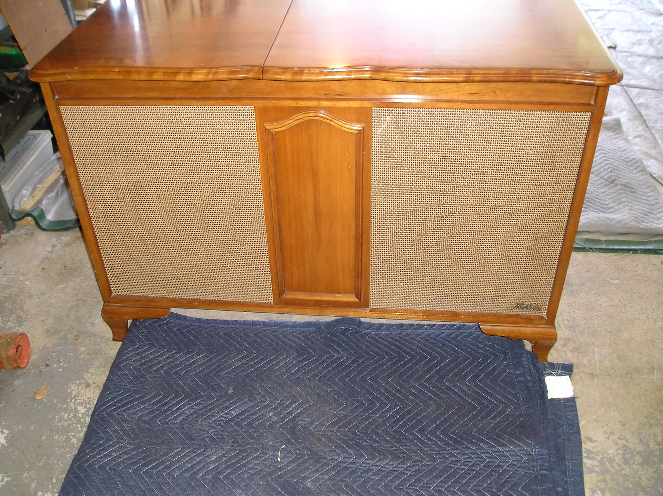

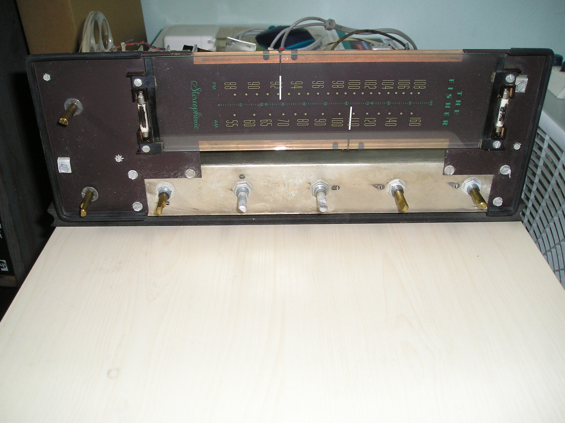

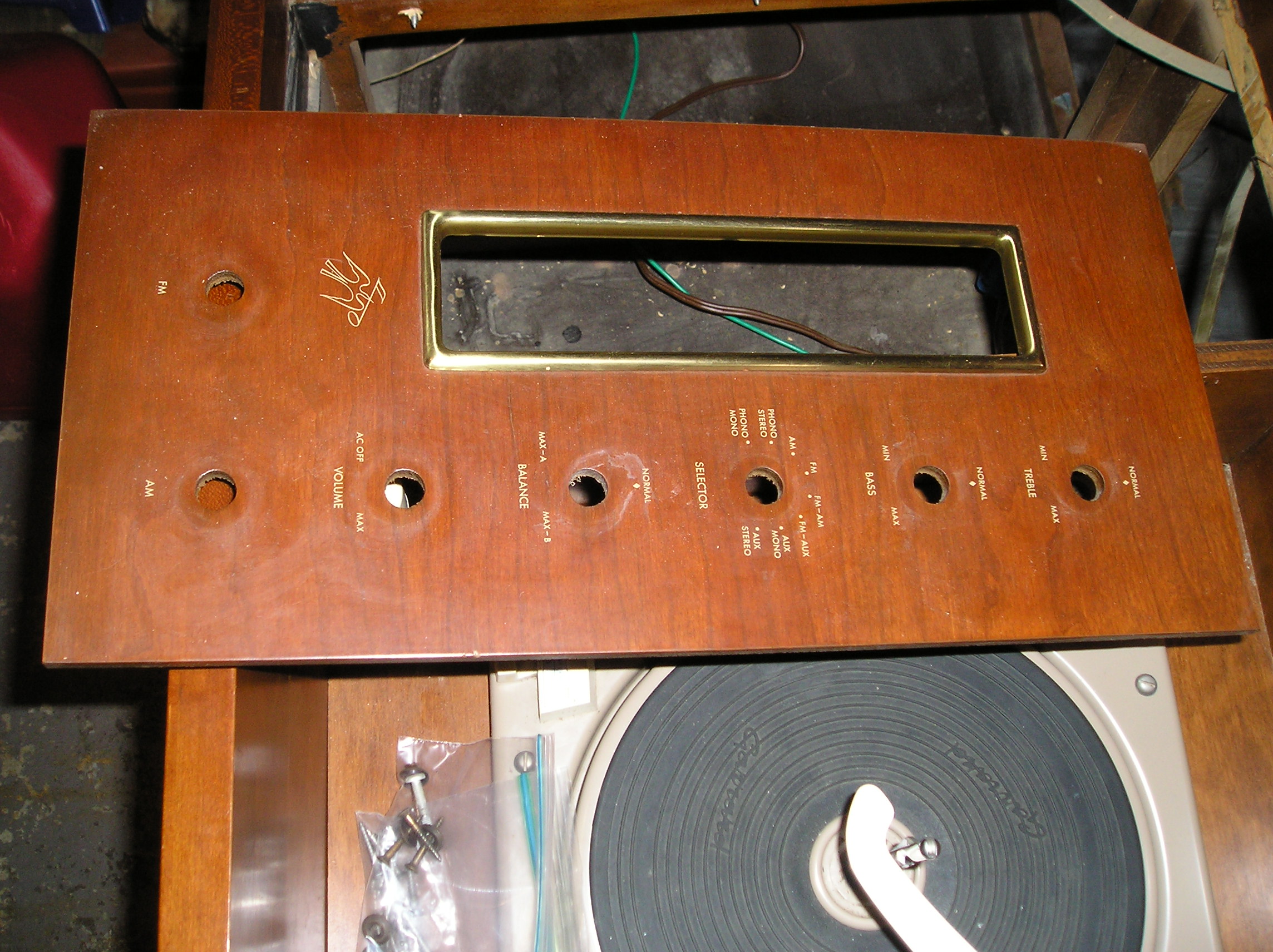

Just found a nice one owner '61 Fisher Electra IV all tube console locally for a very reasonable price. These have a nice tube PP EL84 440a amp and an all tube preamp/tuner with Garrard 210 and 6 speaker set. I have absolutely no room for it, but have been wanting to put the Scott 222 in my office back to the LR where it belongs in it's custom Ethan Allen cabinet, right next to my '63 DuMont SE console. The cabinet is in very nice shape but no way I can accommodate it, besides it's FP style, not my favorite. What to do. Dave MM needs a cabinet to put some Electra VII guts into as his existing FP cabinet which is beat up. So got the IV this past weekend, pulled out the amp and tuner/preamp (cleaned up nicely!!) and it's going to sit on an office cabinet to power my bookshelf ADS L-10s, and Dave will get the rest to swap his guts into. Win-win! I get a good tube office rig, he gets a much nicer home for his Electra VII guts, everybody's happy!

Roger, that is a nice looking unit for French Provincial, not my favorite either says a guy who has two French Provincial consoles. Did Fisher not use a rectifier tube in their amps, or, am I not seeing it?
Re: A console gut win-win
Bill, by about 1961 Fisher moved from tube rectifiers to selenium, so this will get the 1N4007 SS diode treatment at some point, along with the usual other stuff.

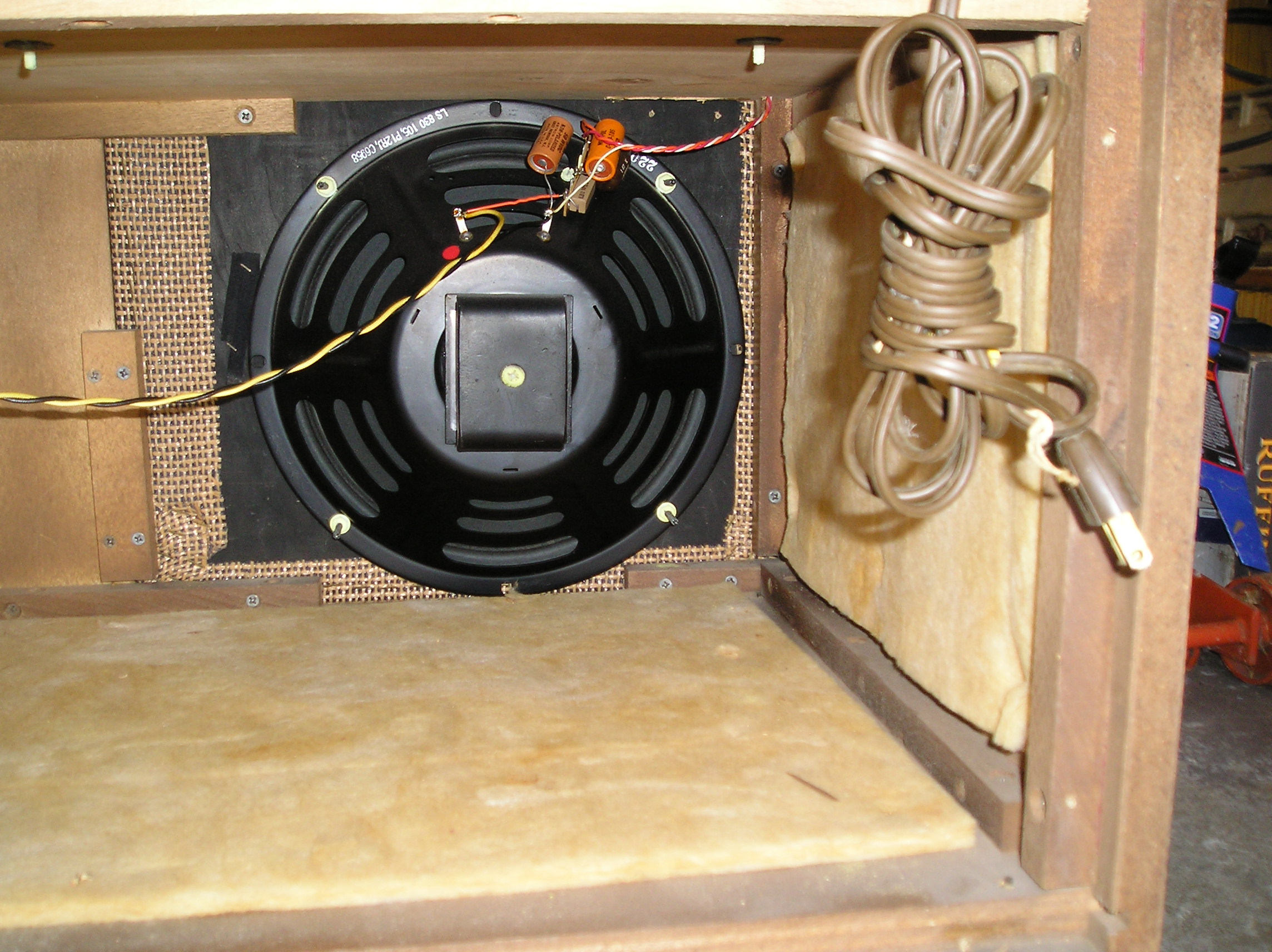

The cabinet is really nice and the ensemble of Garrard 210/Shure M8D and a speaker set consisting of 2 x 12" woofers, 2 x 5x7" ovals, and 2 x 3" tweeters in individual closed & sealed compartments makes for a particularly nice balance with this amp at about 15w/ ch. I've very glad to have a very high quality tube amp complemented by the usual excellent Fisher preamp circuit and sensitive tuner quite cheaply, and being able to let Dave have it to upgrade his ratty unit and keep everything complete and original is truly the icing on the cake... no Fisher should be allowed have a poor presentation imo. After McIntosh and Marantz, which for most at that time were under the radar, Fisher was THE known name for truly high-quality Hi-Fi in the '50s and '60, it was the first brand that came to mind for most people, and for a very good reason.

Is the 12" woofer a Jensen?

The only negative thing about this group is that we can't hear how all these cool devices sound! I was looking at that nice Fisher amp and its 6BQ5s and big transformers and wondered how it sounds at its best.
Also wondering.... I've got a little Fisher 6BQ5 mono amp, a 20-A. I wonder if it's half of that 440-A in the photo? Mine came from an office remodel. My brother in VT spied it when they were deconstructing an old office to add on. It had been in background music service apparently. He snagged it for me.

The 30a amp was 1/2 of a 440a, and I believe the 20a was as well, in '60 the Custom Electra III came with either a pr of 30a amps OR a SA-16 stereo amp, the immediate predecessor of the 440a., I'm guessing the stereo amps were used towards the end of the model run and thereafter as a cost saving measure by combining everything on a single chassis. The 20a had the brown painted chassis with tube cage and slightly different location of tubes and xfmrs. The 30a had a plated chassis, but both circuits pretty much the same afaik. Any of the above Fishers are very nice low-ish power but very sweet sounding amps. The 440a, 460a, and 480a amps were the same from what I can see with model #s changing to mainly to reflect the new model year.

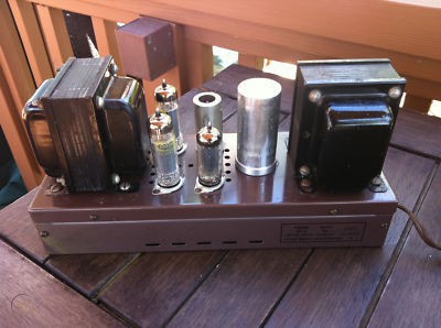

Fisher 20a:

Those are all nice looking amps, and the size if the transformers is, Wow!
