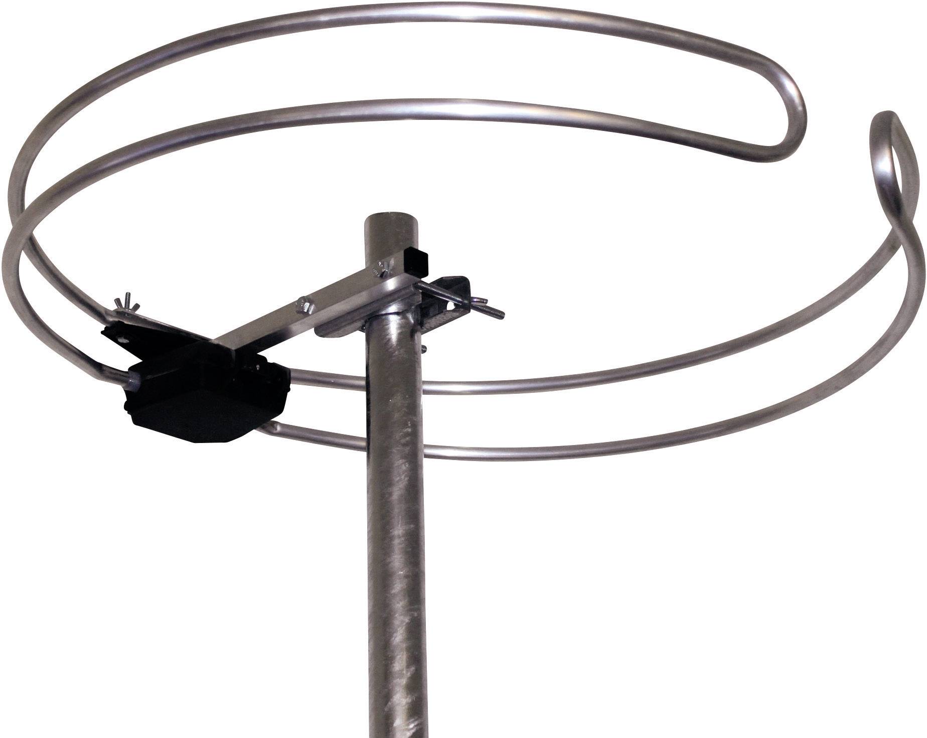

I admit to not being the brightest bulb in the lamp sometimes, but, please, 'splain this to me. How is an "Audiophile" FM stereo antenna different from a common old FM or TV antenna? How does this contraption make stereo better? Built in Mesa, so it must be good.

You're right. In fact, a folded dipole, properly stretched out, would likely be better in dealing with multipath because it's directional. Multipath can make for very lousy sound. That antenna looks like an omni, which will not deal with multipath gracefully. On the other hand, any antenna will reduce noise and make things sound better.

I cannot be silent on this subject, since I had engineering class EL-440 (Antennas and Propagation) over 35 years ago. Nothing is new here, I use rabbit ears for FM using twin lead not coax, so this is half the solution for most folks. A single length of 18-12 gage copper wire is an antenna, insulated or not. All the FM I need is within 50 miles of my house and shop, but issues of co-channel are getting worse as translators multiply.
I do not like indoor FM antennas because just walking around a room affects reception but not everyone has an attic or roof access. Most FM is horizontally and vertically polarized for both home and auto reception respectively. Many broadcast more power in the horizontal plane, hence outdoor antennas are mainly horizontal.
The dimension 31 inches is the dimensional compromise over the 20 MHz bandwidth of FM. Many times, rooftop TV antennas were marketed as including FM, but only 1-2 of the arrayed dipoles were about this length. These had one advantage - its directional and one disadvantage - tuned/cut not just for FM 88-108 but also VHF 54-88, 180-216 Mhz.
An outdoor, roof mounted FM-only antenna is the best because:
1. Up high, outside and unobstructed path is where the strongest signal is! Compromise: Attics are great for a poorly constructed but effective antenna, even home made ones but a metal roof and objects like spouting in the can affect it.
2. Directional means forward gain is maximized and co-channel interference is minimized.
Compromise: Omni-directional antennas often take form of folded dipoles in an S or circular shape. Mounting them on a wall may work if on the "signal side" of the wall.
