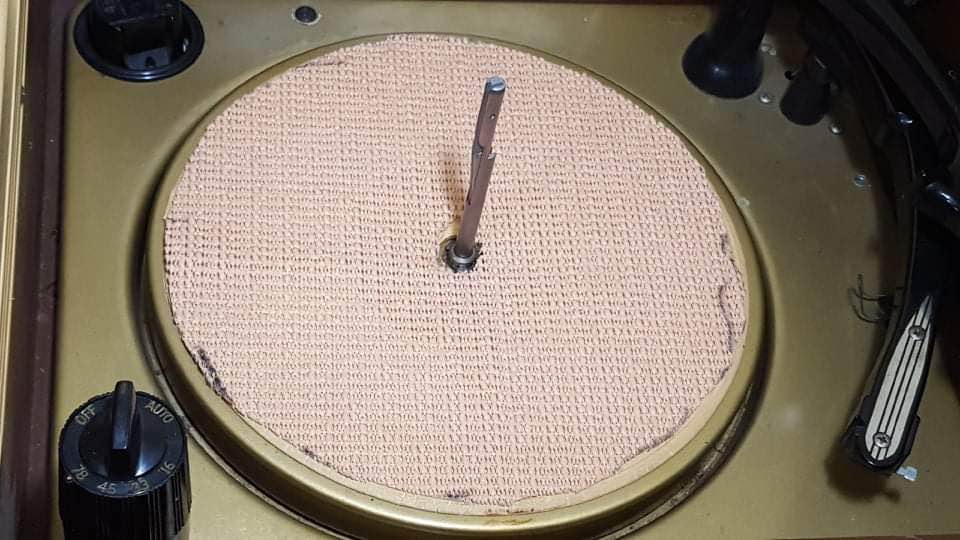

Isn't another way to tell is by what changer is in it? The first has the Conquest, the second, the Imperial Micromatic? I can't remember, Greg. What changer does your Symphony have? Mine has the Imperial changer.

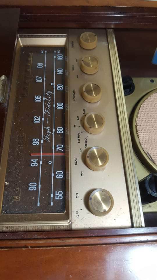

The first Maggie is a six knobber so it should have the 200 series tuner. The changer is a Conquest, the tone arm gives that away. The second Maggie has the Imperial, or, MIcromatic changer depending on what they put it in. And, again the tone arm gives that away. Without seeing the controls, it's hard to say exactly what the second one is, but my guess is like Greg's. iIt's probably an Astro-sonic, and, it would be in the lower half of the Maggie pecking order. Not that that is a bad thing.
In the pecking order of Symphony, I would say it's in the middle. There are several models below it, and, several models above it. In the Maggie brochures for 1961 the sold for $398.00-425.00 depending on the cabinet. As far as the 175 amp, I'm not really the amp guy. But, I think, it's 6V6PP, and not bi-amped.

Is there any significance to the fact it has a separate On-Off knob in the first position?
Also there's no tuning meter, and I assume no eye tube also?
I like it but it's not my favorite style, which is Early American in Maple, but I've never seen one like that.

Magnavox lineup from greatest to modest is: Concert Grand, big Imperial, Stereo Theater, little Imperial, Symphony, Concerto, Comtemporary. These would be the models with P-P amplifiers. There is one series with a SE amp and AM tuner, one with SE amp and AM-FM tuner, one series with no tuner. That would be consoles. The portables I'm not that familiar with.
The AMP-175 had 6V6 P-P amp, not bi-amped and was the predecessor to the 93 series. The Conquest changer is model F-200 and the Imperial Micromatic changer, starting in 1961 is the S-600. To my way of thinking they are identical, or nearly identical mechanically. The difference is the tone arm, over arm and platter mat. Some of the knobs on the Conquest are different, maybe depending on year, maybe depending on application. Every Conquest I'm aware of either has an EV 26 cartridge or a Euphonics U model. The Euphonics is fairly rare in working condition since the rubber bridges turn to goo.

The separate power switch is unique to the Symphony/little Imperial/Stereo Theater series 200 tuners. The Imperial/CG has the power switch as part of the timbre control. Pull out/push in to operate. On the little series 100 tuners, the power switch is part of the treble switch.
AFAIK, the Imperial Micromatic extended to the SS era. The trim was not as big and gawdy, unfortunately. I'm thinking the changer in the second one has the 11" platter and is housed in a SS model. I wouldn't drive two hours for it for free myself. They make good parts instruments for the tube models. Speakers, changer, that stuff. You can put the 9" platter from an older tube model on the newer changers.
Bill, my Symphony has a smooth operating S-600 Imperial Micromatic with an EV 26 cartridge and even still has it's little brush to knock off the dust before the needle hits it. You have to have that little brush adjusted right or it will sound funny. Don't ask how I got so smart......

Roger,Firedome wrote: ↑Sun Jan 23, 2022 10:28 pm Is there any significance to the fact it has a separate On-Off knob in the first position?
This is similar to my Symphony with exact same tuner (57-03 the one with no 88 or 89 on the dial
Mine is also dated on Abe Lincoln's birthday of 1960. The AMP-175 is rated 20 watts in all the sales brochures and is a solid quality amp using a 12AX7/7025 and a robust power supply. It has 8 speakers including the 15" woofs, no horns. The F200 changer is one I have several of, should you need parts. I also have even an extra tuner identical to that one, no meter, no electron ray tube BUT the simple On-Off switch is one of my favorite features.
