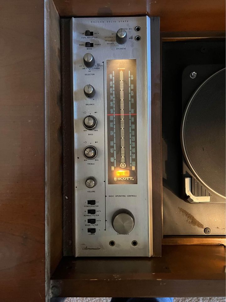

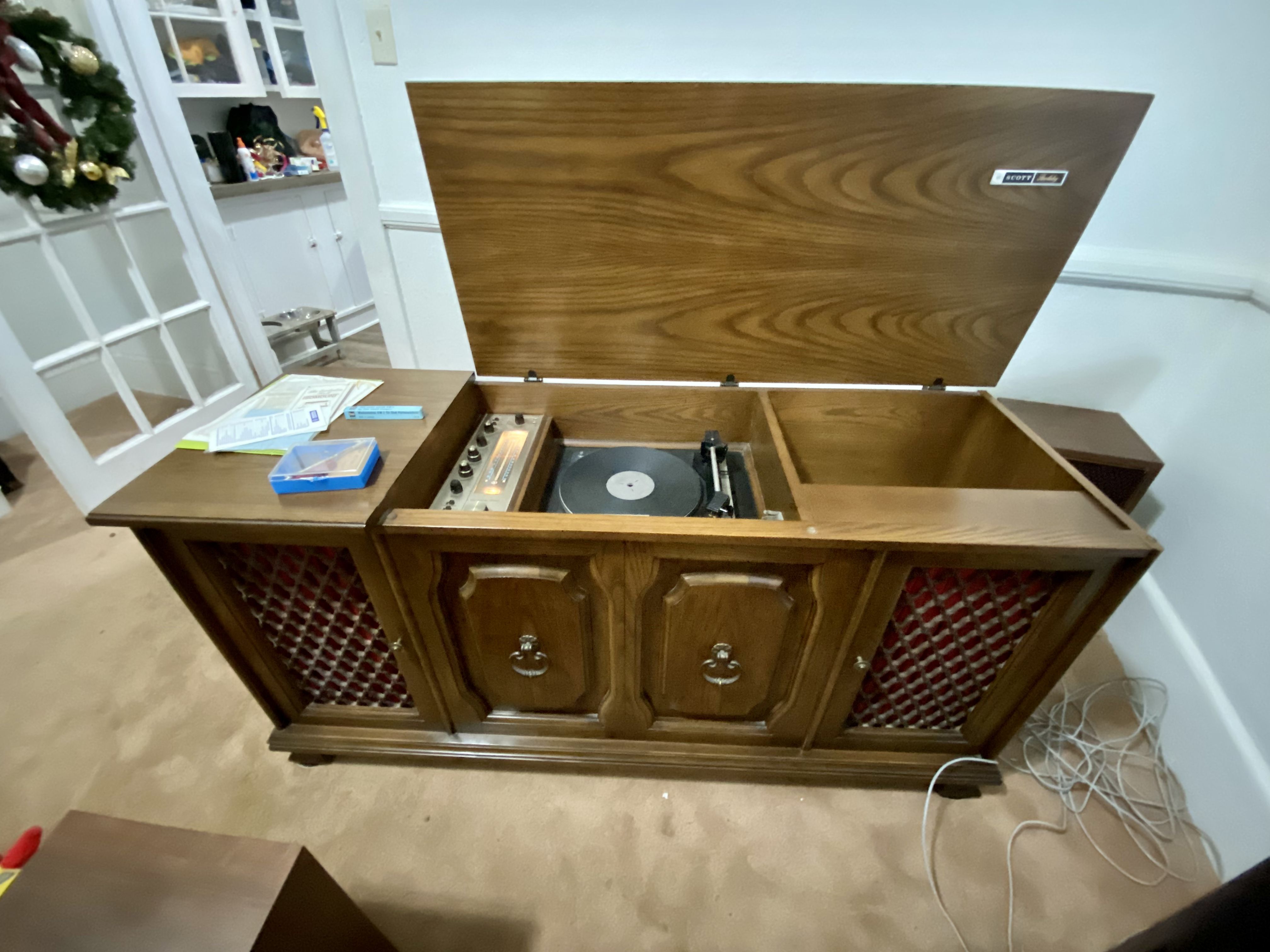

I have the same console as SeniorSteve with a 2225 receiver at my home and the reason I joined the forum. I've attached 3 photos. I have not disassembled any components other than to disconnect the speaker connections to determine if a hum I was hearing is the amps side or a speaker/wiring issue. The hum follows is on one channel regardless of the speaker connected. The tuner brings in station with the strong ones pushing the signal needle to the max. Audio quality overall sound good except for the hum on the right-channel. The rumble and compensator add more low frequency depth to the sound.
I have not tried the mic inputs nor the "earphones" outputs, nor the associated record player (for which I will have to buy a vinyl record for at a local store. I also have not tested the AM side tuner.
Honestly, I was surprised it worked at all and I was quite taken with the sound. I may need some tips on removing the speaker grilles to see what the speakers look like. Any extra hints and info are appreciated!
Bonus pair of Kenwood KL-2070, also untested, were part of the deal.

Just remember that Scott equipment was still made in the U.S. at that time, and to high engineering and manufacturing standards. The electronics are likely an adaptation of a stand-alone Scott receiver. Their devices were generally first-rate and performed well in RF and AF realms. Of course, the better Asian electronics at the time were also of high quality. But the point is, this was before everything-on-one-chip, when tuners and amps could be designed for high performance.
Re: Felipe's HH Scott Console and 2225 Receiver
Nice looking set, and it's got a the dual changer with the 8 lb platter....of course it will need to be cleaned the controls gum up easy on them

Is DeoxIT D5 the right thing to clean out the RCA jacks for the speaker connections? If so, would the Faderlube spray also help by improving conductivity? I will be replacing the RCA jacked speaker wires as well. They are quite crimped by the staples holding the wire down.

BTW the knobs with missing end caps can be obtained at Antique Electronic Supply in AZ (google it, it's online) because the Scott knobs are the same as used on Fender guitar amps (I think it was) and they are available there.

Thanks for the info. I found two caps inside the console so I could glue a couple of them back on.

Felipe, to remove the grills in front of the speakers just grab behind the wood grill at the top and pull. There are a couple of friction latches on the sides and pegs in the bottom of the grill. The grill should tilt out from the top. I have not pulled any of the speakers out of the console to replace the crossover capacitors. There is some sort of sealant that doesn't want to release on the woofer and I didn't want to push my luck. I was wondering what was originally in the console for the changer, now I know. Even though it's not the 1009 or 1019, it is a very decent changer (I like all Duals). I liked that Scott used a good changer with a magnetic phono cartridge, plus the fact that they suspended the changer board to isolate any vibration to changer from the speakers. The console is a heavy beast!
