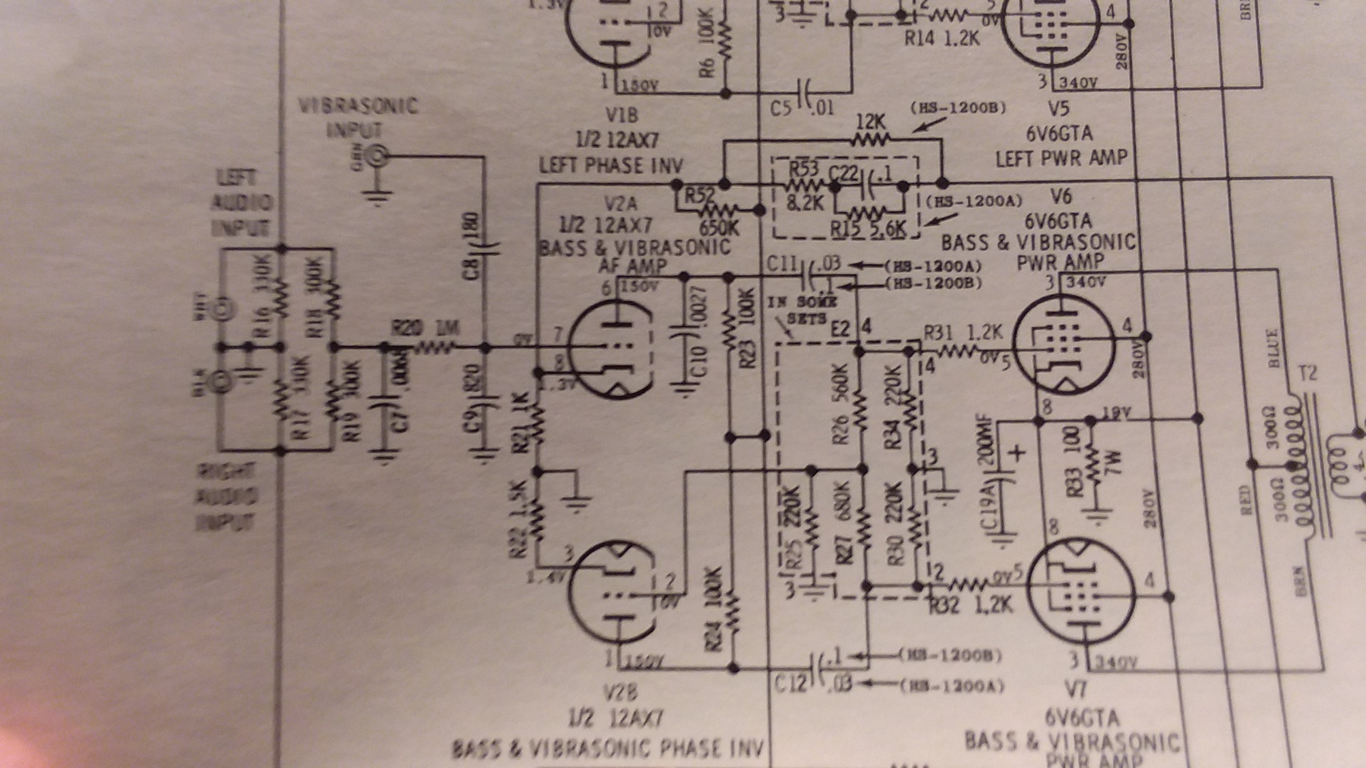

1963 circuit to roll-off HF going into bass amp

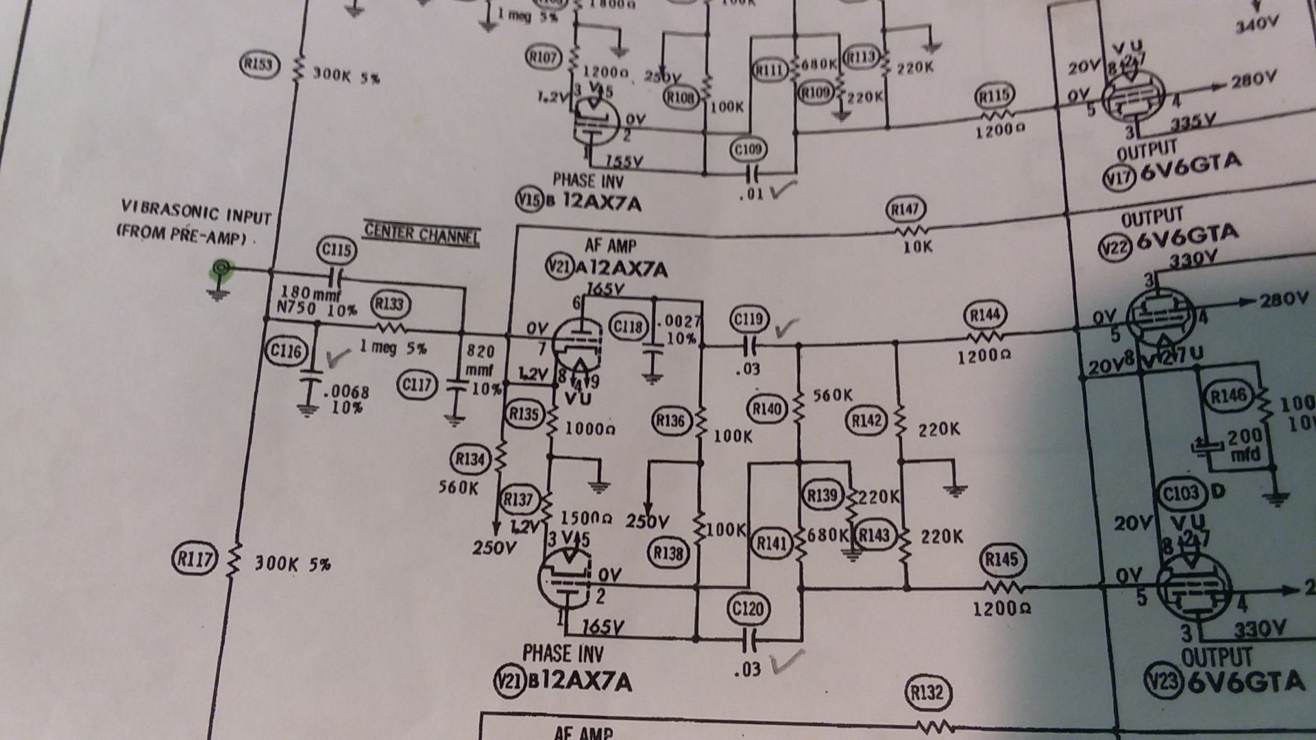

1964 circuit for comparison

They look the same? Have you calculated the frequency at which it starts to roll off?
Re: Motorola 3-Channel Crossover Frequency
Yes! You see values are the same, a second order filter, having two RC time constants. I will calculate that once I find my notes from senior year of college when we studied transfer functions. The math in filters/networks came AFTER the experimental labs unlike other courses, which helped me understand it better but that was 34 years ago
My preliminary calculation yields 476 Hertz for the first time constant and 1200 Hertz for the second one.
Bode Plots are the graphical representation of a second-order filter's transfer function.
Notice the HS-1200 (A&B) amplifier has different negative feedback loop components for 12" and 15" bass drivers.
The HS-1200A is used in my SKR151 which has a 15" Jensen driver. The HS-1048 has a 10 K resistor, for use with a 12", which my SK112 has.
Good bass response roll-off up to 476 Hz with more aggressive roll-off of the frequencies up to 1200 Hz.
