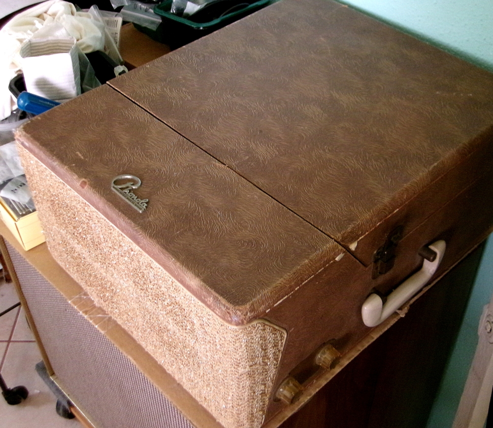

Mr. Mogul. Would you please provide a photo of the Phonola you are working on, I am curious what it looks like. When I Googled the model number it brought up a couple of different photos for the 856 model number.

1. Bill, here's the Phonola 856.
The 3 tube amp is almost exactly the same
as the Firestone 4-A-146 and Sears 4249
that I have posted about.
