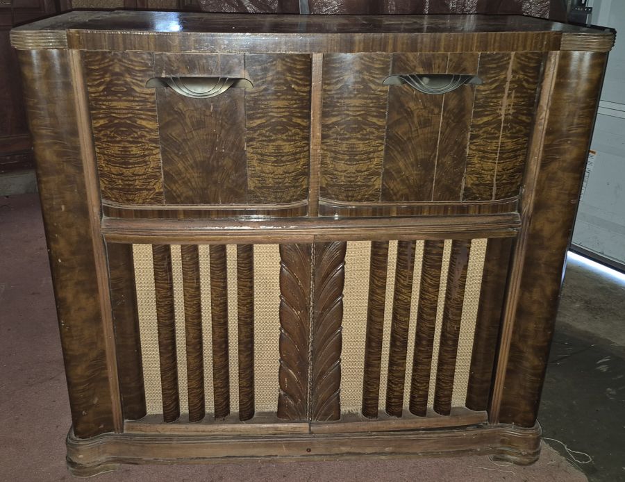

Zenith 12H090 - 1947 horizontal console
- Posts: 844
Out of the 15 post-war radio-phono consoles I own is this which I consider the heavyweight.
I do not consider Magnavox in this category.
Even my 1947 Berkeley will top the Zenith based on the pp 6L6 amplifier and 2x12" speakers alone.
The AM and SW sections on these are easy to restore and perform exceptionally well.
The FM discriminator is less advanced than later models, as it includes both old FM (42-50MC) and new FM bands.
The only drawback with most of the changers, they play only 78 rpm records.

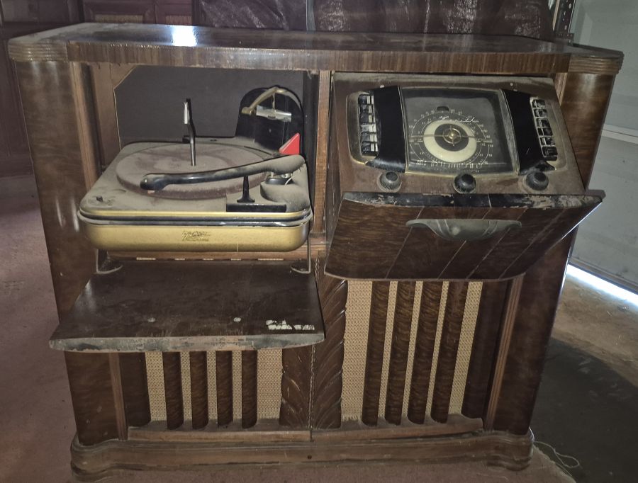

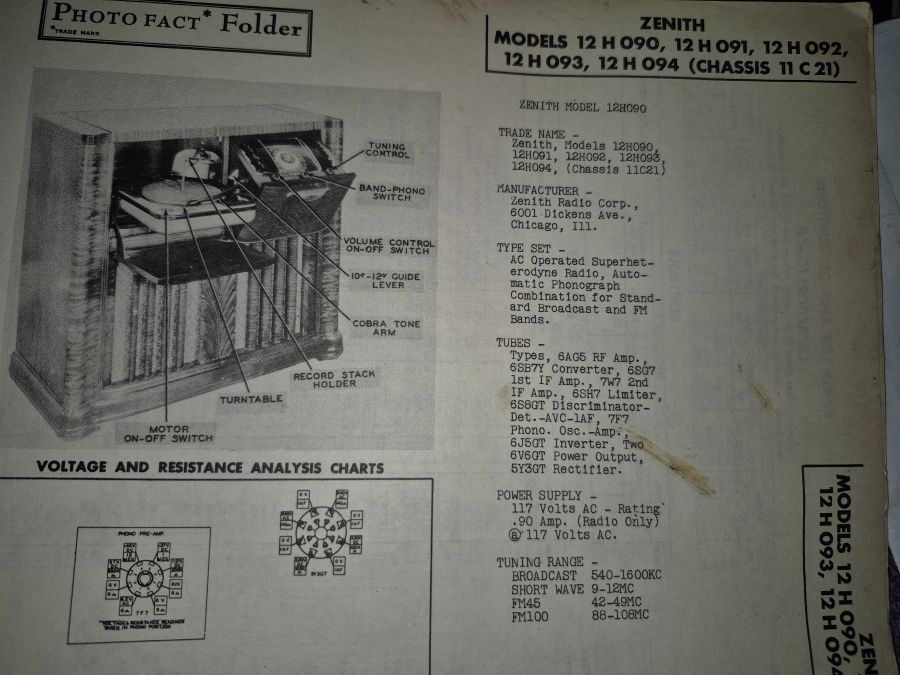

"Radionic" phono? Link to a schematic?

Schematic is on Nostalgiaair, uses a 6AG5 for RF amp, early use of 7-pin miniature tube.
7F7 on separate chassis may be radionic, schematic shows magnetic cart but no cart part# listed in Sams.
The field coil speaker though.

Your Zenith lists a 7F7 "phono osc.-amp.," which means it's the Zenith Radionic system, likely. The cartridge is just a moving vane between plates so there's nothing to fail. When I read about the cartridges becoming scarce, I wonder about sending them out to re-tipping services that replace the jewel stylus tip.
