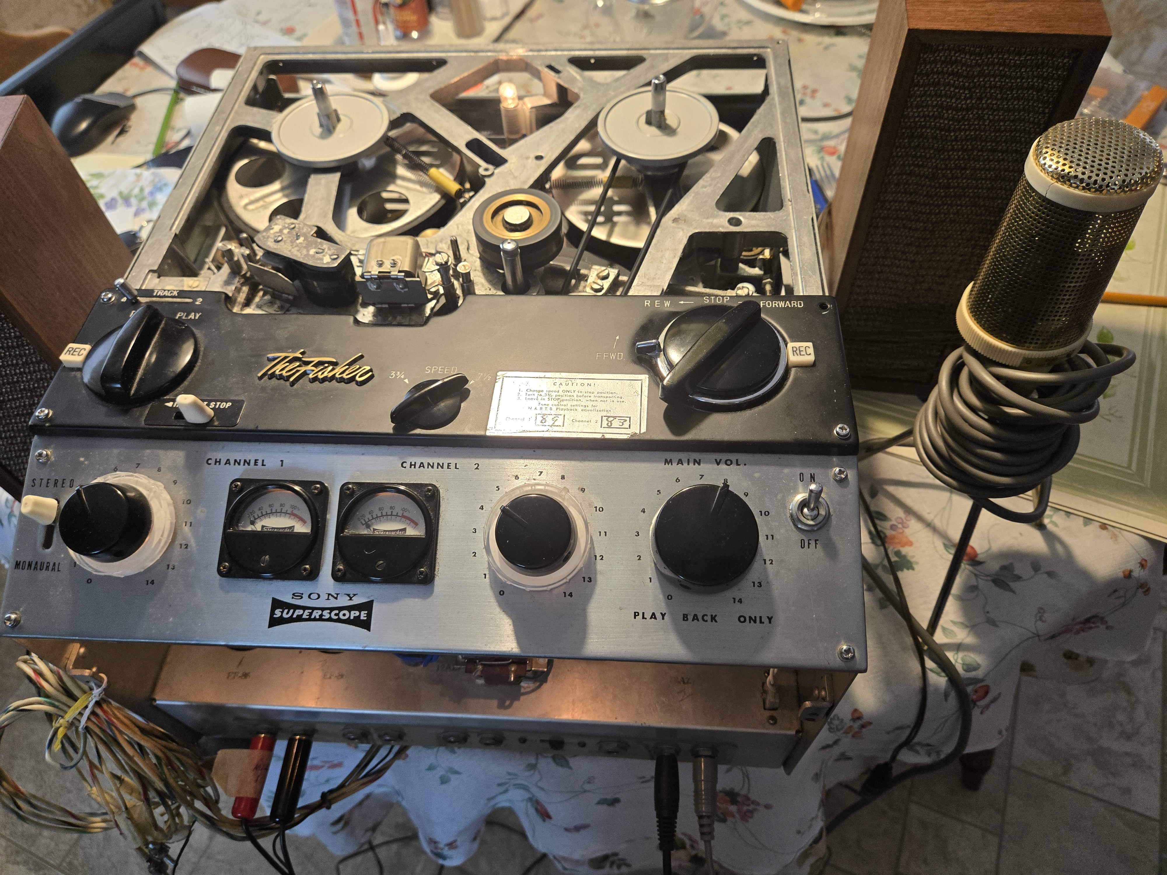

Those following, Fisher used the first consumer Sony 555A r2r in the President and Executive from 59 to 61. They sound great when working and running through the Fisher amp but it's also a PORTABLE unit with its own amp and can be hooked up to external speakers. Owners manual says it's 48 lbs in carrying case!!!
Anyway, issue is no right channel output on playback. I rolled tubes, checked wiring but I think it's a cap or something else. Both meters deflect in playback when it's turned on. Only left channel plays back. Not the heads because it has both 2 and 4-track heads. I switched the leads on the 4-track head and got output from the lower head leads hooked to the upper track.
Microphone plugged in, unit in STEREO RECORD, both meters deflect and sound from both speakers... In mono record, only left channel reacts which is correct.

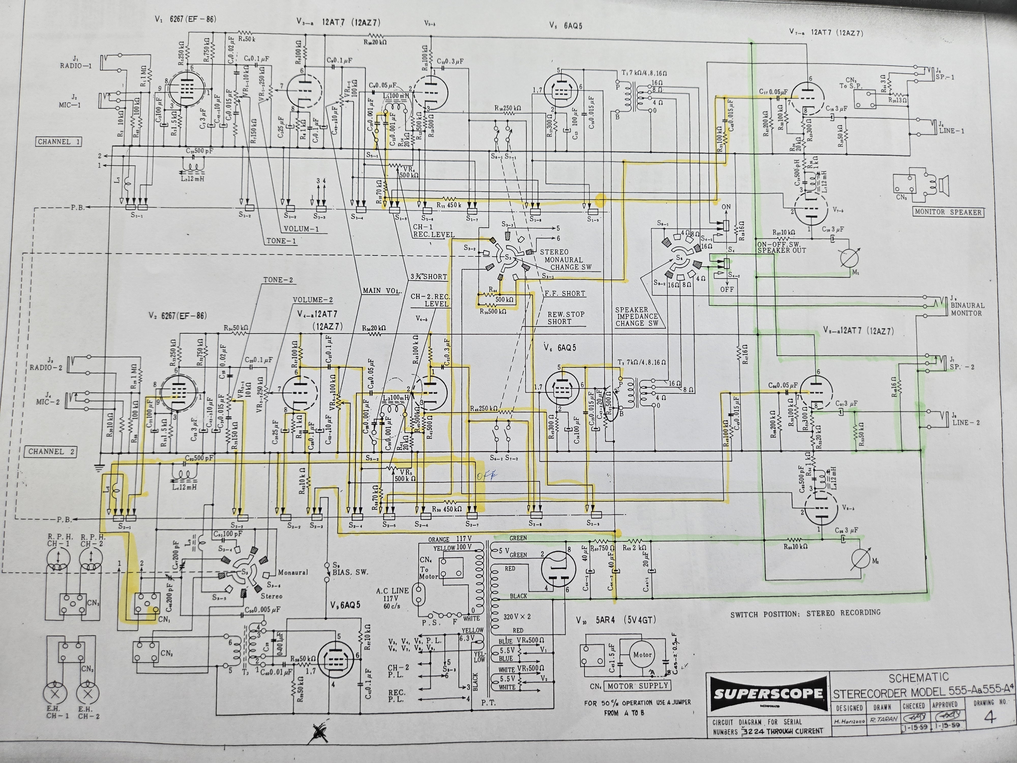

Don't have a scope. Still looking at the diagram and marking things on the actual chassis.
Re: Fisher's Sony r2r
Looking at this area and specifically this choke:
I think it's somewhere in this circuit as this is "on" in playback but "off" in record.

That schematic is one that makes more sense when you can look at the device and the schematic at the same time. I'm not seeing exactly how it works. That choke is in one half of the 12AT7. What happens if you jumper that choke?
Dunno. Haven't tried it yet but there's another one on channel 1 so what would cause one to fail yet the other always worked? A resistor? A cap?

Is the choke there to keep the bias frequencies out of the output, where they can mess with FM stereo decoding?
- Posts: 9024
As to why that choke could have failed. I don't know that a cap or resistor would necessarily be suspected of causing the choke to fail. You stated earlier that a dead channel was a known issue with this model. Maybe the choke is a high-failure item. You could replace the caps in the circuit, check resistors, maybe check the tube for a short. Jumpering the choke would let you know if it was the problem.
