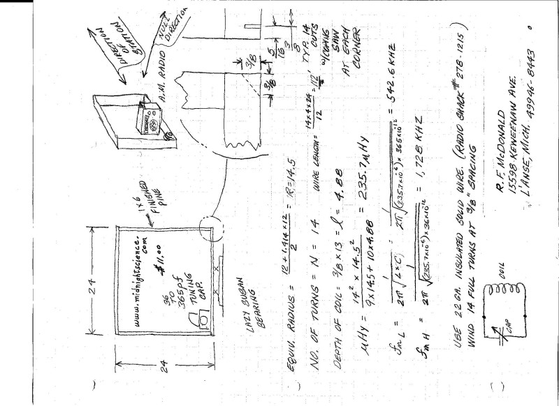

But if you're dead set against a hole, build a loop antenna. I'll see if I've got the plans scanned into this computer, or a photo. It works inductively--set the radio in the middle-- or hard-wired. I've got a good old Philco AM portable sitting inside mine for listening to WSM in Saturday nights. I'll look for the plans and post them separately.

Plans. I'll try to send photos of mine later.

Thanks, Chris! I'll print that out and see what I can do. That looks like a size I can manage in my small shop. I have no idea what the mathematical equations are.

The calculations don't matter--just make a 24" x 24" frame of 1x6, make 14 cuts in each corner 3/8" apart, Wind 14 turns of #22 insulated wire, add the tuning cap from an old AM radio, and you're good to go.
I used pine and amber shellac on it, added mahogany feet for elegance. I added the single turn for a wired connection--hooked it up with twinlead and one of those clothespin-type antenna clips.
Bill, this is tuned for the AM band. Rabbit ears are typically cut for the VHF TV and FM bands,.
