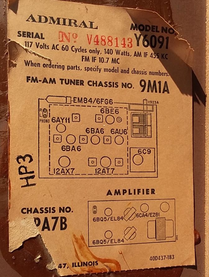

The amplifier is a single-ended 6BQ5 stereo amp on a separate chassis with the power supply and 6CA4. I had a similar model using a 5U4 as the LV rect, most everything else was the same. Record player is made by Admiral, sold as Ensign for drop-in replacement models.
Admiral 1964 model Y6091

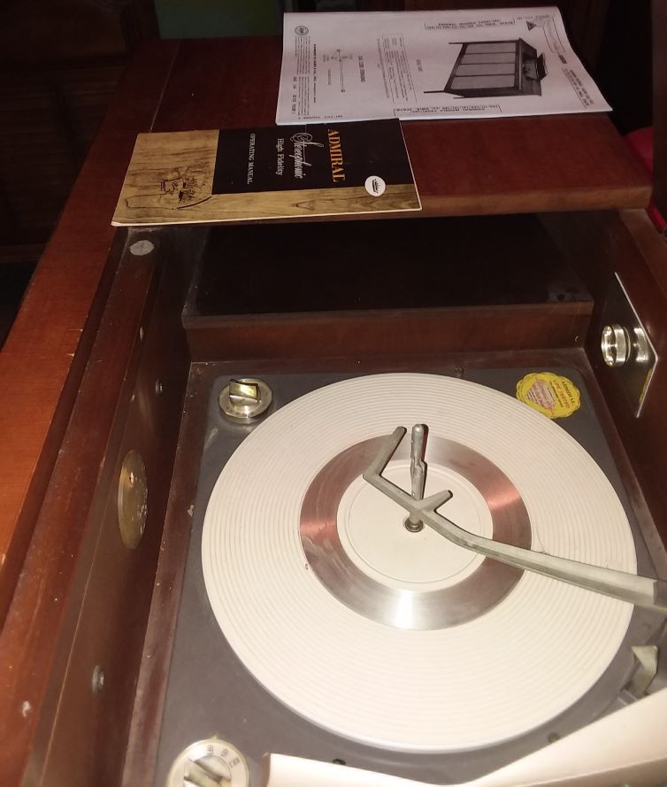

I got this from a n estate clean out. 1950s cape cod with oil forced air heat, it was extra dusty but no smell.
It had never been serviced by the look of things.

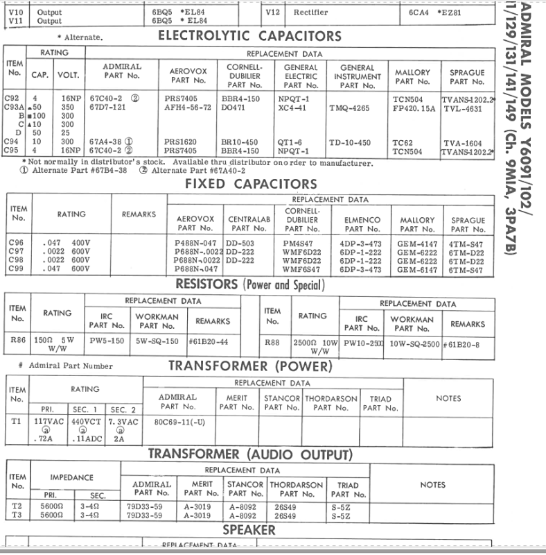

Hi,
I have this same Admiral model but the amp is missing one channel speaker output transformer. I have yet to find a schematic. Can anyone tell me what output transformer I need and where to order one? Thanks!

You may find that an exact factory replacement is not available. Hammond makes a line of replacement transformers. The 6BQ5 is a popular tube, so suitable replacements should be no problem. You might want to change both transformers so they will be the same. Antique Electronic Supply carries a full line of Hammond replacement transformers.
Normally, audio output transformers don't just "go out". Many times, a component fails that causes the output transformer to fail. You want to check the cathode bias resistor and the cathode bypass capacitor to make sure those are good and also the coupling caps from the previous stage to the output stage. If any of these components fail, that can upset the bias on the tube and cause too much current to run thru tube and thru the output transformer. Are both of the output tubes still good, with no shorts. I believe if I was going to the expense and trouble to replace one or both output transformers, I might consider buying a matched set of output tubes at the same time.

Here is a Y6091 partial parts list with the OPT values.
It looks like a common primary impedance value, maybe someone has one
from an old radio or such.
Let me know if you still need the schematic, and I'll post it in "Downloads"
section.

I appreciate being accepted into the forum. Thanks to Hi-Fi-Mogul & electra225 for your swift replies, wealth of info and suggestions. I will check and replace (if necessary) the components electra225 suggests before replacing the output transformer. Thanks to Hi-Fi-Mogul for the offer of the schematic which I’ll need to accurately identify the caps and resistor. --j49

The schematic is now in downloads (Amps and Tuners) on page 4.
