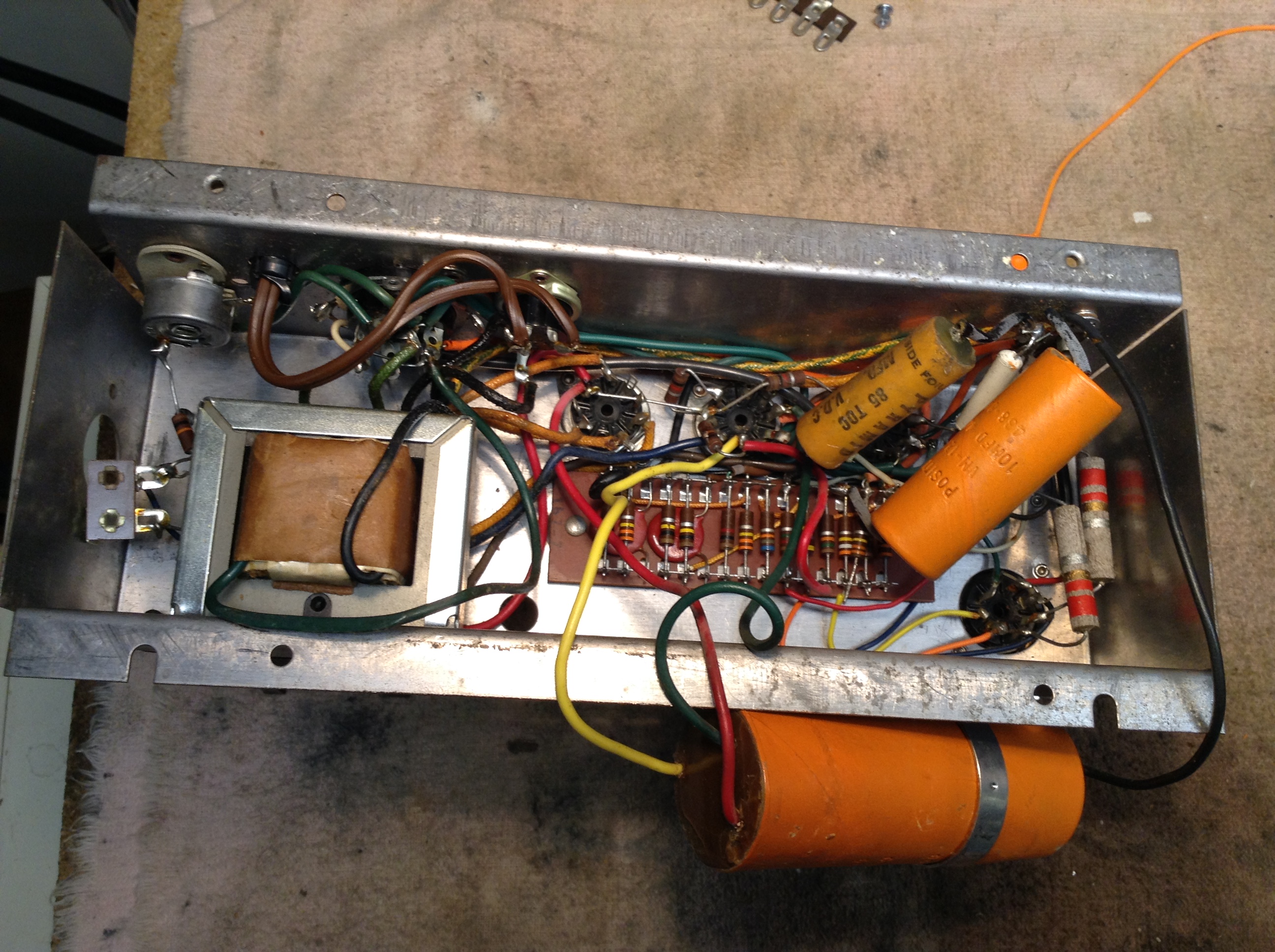

Back in January I posted about my new toy, that being a VM 570 console along with its matching VM 102 amplified speaker. The VM 570 started out as a mono unit in 1958 but with the addition of a stereo cartridge and the VM 102 speaker/amp it was transformed into stereo. The VM 102 was not available until 1959.
If you refer back to my original post, I talked about how dirty the electronics were and I showed a few photos. Since then, I have gone through all of my VM amps that have just been sitting there waiting for me to do something with them. When I say gone through, I mean tested for parts that I will need for restoration but not really restored yet until the last few weeks when I picked the VM 102. All parts needed have been here for some time, I have just been lazy and spring/summer stuff has gotten in the way.

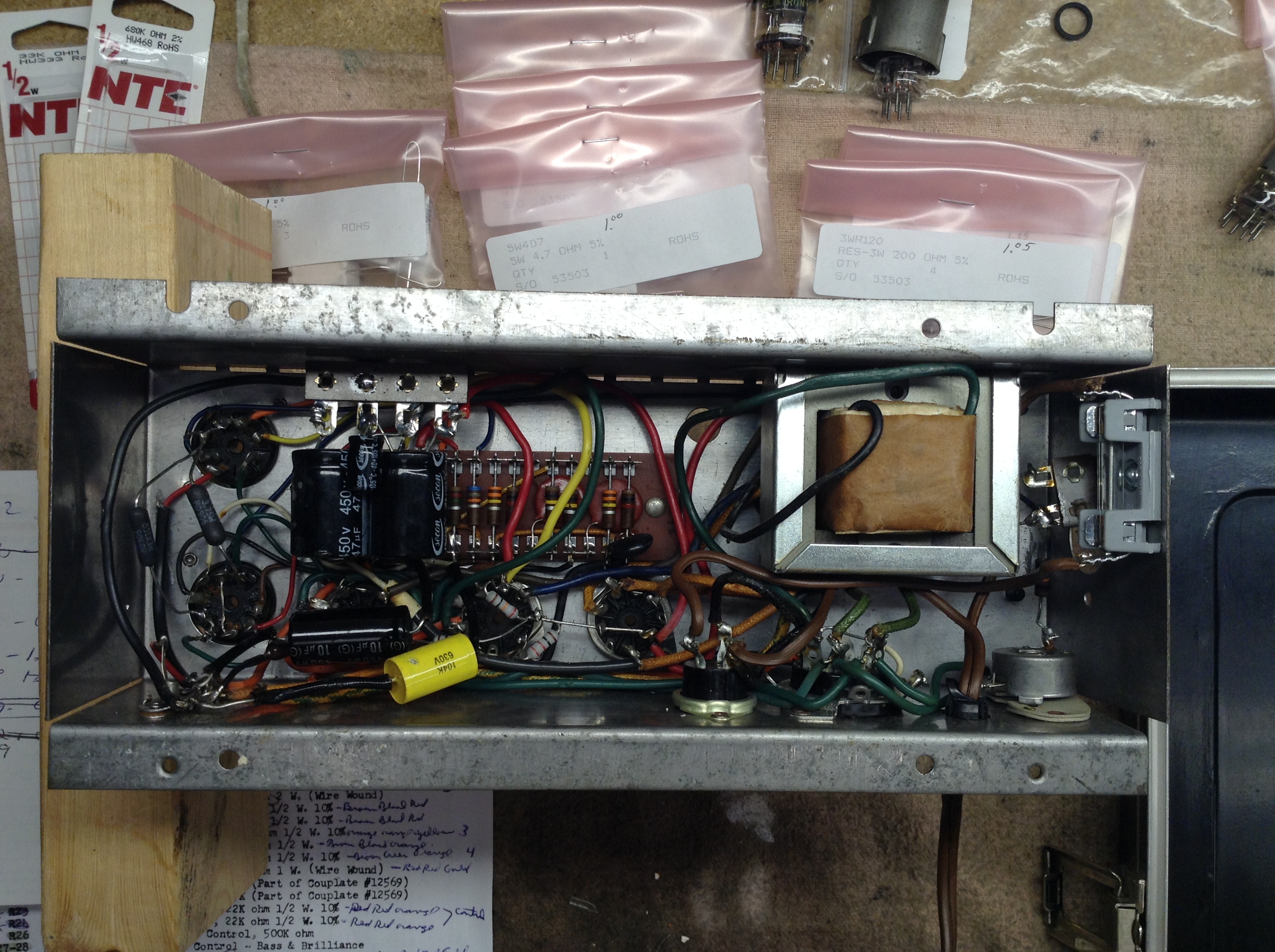

As I mentioned, first victim was the amp in the VM 102 speaker/amp. With my previous testing I already knew what had to be replaced so that is what I did. This was actually my first amp that had the "HUM" when I first fired it up so naturally all the electrolytics were replace along with all the paper caps. 6 resistors had drifted so they were replaced, and this amp had 3 wire wound resistors, so they got replaced as well. All controls were cleaned several times and all connections were double checked to make sure everything was tight. I also installed a fuse holder with a 1-amp delayed fuse. Tubes tested strong with no shorts except the 6CA4 rectifier which tests strong but showed 2 shorts. By luck, or not so lucky, I had a NOS Sylvania 6CA4 tube that I have no idea where it came from but there it was in my tube stash. I stuck it in the tube tester and, :cry: :cry:, it had a short too. WHAT! Since it had only one short, and the short light was weak comparted to the original two short tube with a strong light I stuck it in just to see what I had being very careful with the Variac voltage and a watchful eye for anything that might happen. So far, all is well, and it really sounds great with plenty of bass and sufficient treble. I'm using an RCA 45 changer for testing purposes. I still need to find a "no short" 6CA4 rectifier and with that replaced I need to run voltage checks again just to make sure everything is good. With this unit almost under my belt I can now move onto the main unit, the VM 570. I have all the parts for the amp, and I need to go through the changer as well. I'm not sure when this will happen so stay tuned as I will post when it does.
cover on
cover on
cover off
cover off

I apologize, my photos never show in the order I want them to. If you start with the last photo and go backwards you will get the correct sequence of events. :roll: :oops: :(
Thanks, Mr. Mogul and Greg, and I'm trying to figure out why the photo of the speaker is not showing. I have six attachments showing in the que, but only five showed up in the post. I'm confused. Greg, any ideas? Since the last photo did not show in the original post, here's a photo of the speaker, at least I hope so.

Over the New Years holiday, I decided to work on the VM 102 speaker/amp. The amp and controls have been done for a while now, but there was still a couple of problems. One problem, no matter what was feeding the amp any increase in volume would cause the speakers to motorboat. The other problem, the music coming out of the speakers was clean and crisp.
Problem number one was my first thing to resolve. I checked, rechecked, double checked my work and could find nothing wrong. Shy of replacing all of the capacitor I had replaced one at a time I first tried other things. The interesting thing, when the speakers were motorboating I could touch the amp or the bracket that holds the controls and the motorboating would stop. Take my finger away and it would start back up. Turn the volume control to off and it would stop. I tried running a ground wire from the source to the amp, nothing. I tried running a ground wire from the amp to the controls, nothing. I started inside the amp, using a plastic stir stick, just wiggling wires and components, nothing, until I wiggled the wires going to the power switch. With that, the motorboating stopped. Wiggling again they started back up. There is a protective cover that covers the terminals and incoming wires on the switch so I removed that thinking I was going to find something touching something that it should not be touching. Nope, not the case. But leaving that protective cover off the switch seems to have cured the problem. I have no idea why it stopped, but I'm not complaining and I'm hoping leaving the cover off is a permanent fix.
Does anyone have any ideas why that cover would cause that problem?
Problem number two I'm still working on, so stay tuned. Here's a photo of the controls and the pesky cover.
PS...for some reason my newest photos of the power switch attached themselves to my other earlier photos so please look at the first two photos at the beginning of this post.
