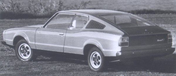

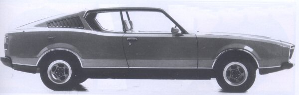

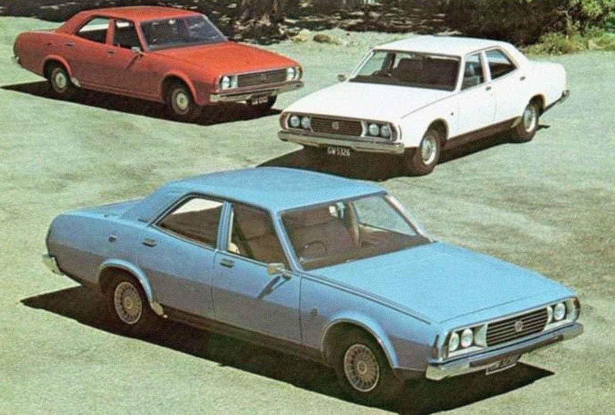

Not Hydrolastic suspension, but one BL (Leyland) car I always kind of wanted was this one; I'm sure most here have never heard of it. Rather thin on the ground in the US being produced and sold in Australia only, the Leyland P76 had the ex-Buick/Rover aluminium V8 in an enlarged form mounted longitudinally in a RWD configuration and had IRS. Even using the ex-Buick "odd-fire" V6 as well was originally contemplated, however an existing BL "E-series" 6 cyl from the Australian Austin Tasman was used instead. The coupe was particularly pretty but few were made, 18k sedans were produced in 3 years. An intriguing and rare car, I'd love one as I like stuff that's out of the ordinary. Aluminium US derived V8, RWD, pretty lines, IRS, and nice interiors... what's not to like?!
