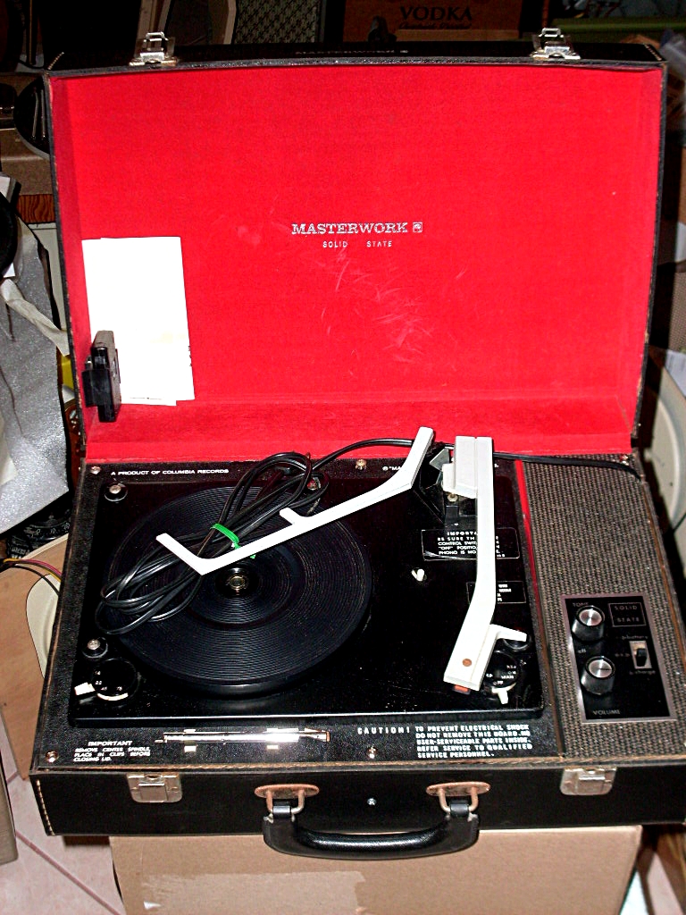

This little Columbia briefcase AC/DC power record player has
a DC motor.
1.From my searches, the motor should not require lubrication
or cleaning.
Is that correct ?
2. The rotor when spun by hand spins, but
not freely like an AC motor.
Is that normal for DC motors ?
Thanks.
a DC motor.
or cleaning.
Is that correct ?
Thanks.

Well, new idler installed, and it appears this
DC motor is a bit tired.
It won't pull the changer through cycle still.
And the motor is inducing quite a bit of noise
into the amplifier.
Plan B ( because I'm stubborn at times), is to see
if I can fit a spare BSR AC motor and switch onto
the changer base.
I'll have to do a bit of re-wiring to the transformer that
drops 120 VAC to 12 volts DC for the amp & old DC motor.
I'm also going to remove the internal battery case, and cover
the hole underneath with some leftover fiber board from
and old record player.
As Greg says, sometimes these little gals can take
as much time as larger units.
It's a cute little briefcase that Don Draper
might like.

I put in the BSR AC motor and it fits and works well.
As I suspected, the speed selector choices now are
altered.
BUT, the good news is that 16 RPM = 33 1/3 RPM,
and 33 1/3 RPM = 45 RPM with the new set-up.
I will leave the AC re-wiring project for later, after I
finish with the Zenith HFY 17E console.
As my friend like to kid me..."It's ALMOST fixed !" Ha ha !

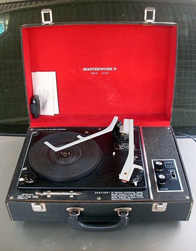

Getting some things ready for a large radio club
auction south of me, I remembered this project wasn't completed.
I permanently wired in the replacement BSR AC motor.
I had to adjust the idler wheel height for the speeds
to match the new motor's spindle configuration.
I had already cleaned the changer mech.
I removed the battery holder, which was broken and
its contacts/wiring all oxidized to rust.
I glued in the loose wood blocks that the motor board and
changer attach to in the "brief-case".
It has a new flip over dual tip stylus and sounds OK for
the little SS amp and 3 x 5 inch speaker.
The original 1968 owner's manual is there
with the 45 RPM adapter, too.
