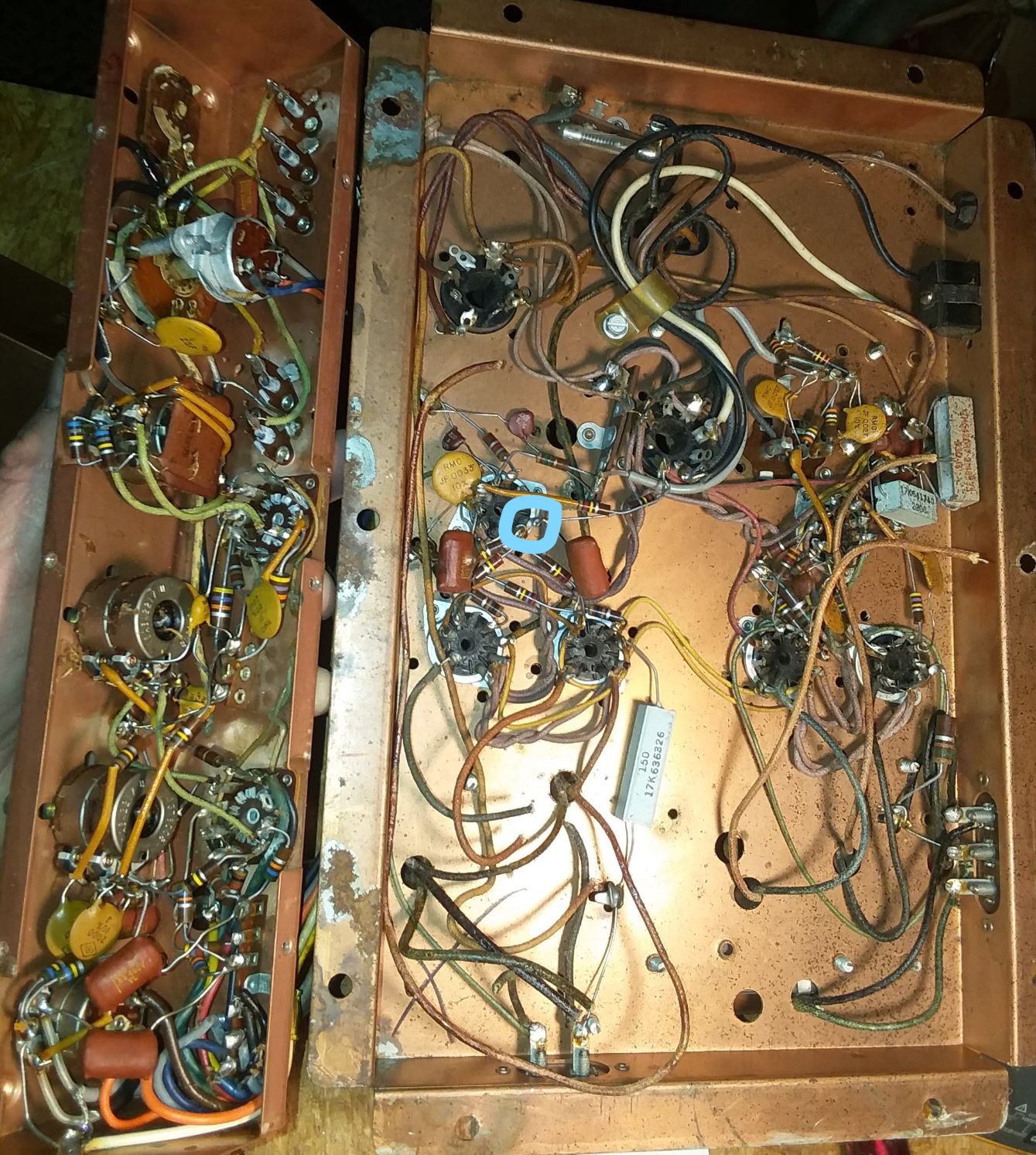

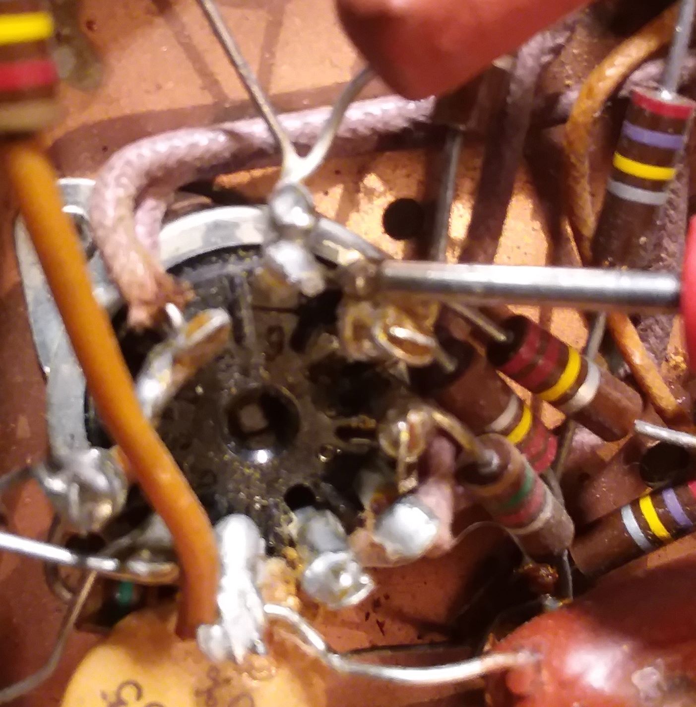

Fortunately, I had an identical HS768 amp chassis that was missing two of it's output transformers as I had robbed it for parts. I decided to restore it for this set and found the three OPTs on the rusty chassis were good :D I also found an original defect in this amp, pins 6 and 7 on a 12AX7 feeding the PP bass output tubes were solder bridged from the day it was built. THAT explains the one open winding on the bass output transformer, the fatigued pin 7 on the affected 6BQ5, and teh fact it never made much bass for me (this was part of a consoles guts I got in 8th grade) but sounded good enough to get me VERY interested HiFi.

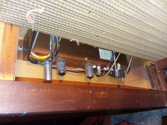

When I opened the panel under the preamp to get it out, I had a hard time getting up to the 11/32" nuts holding it in place. It took every extension I had in my craftsman 1/4" ratchet set and the nuts were so tight. This was only after I vacuumed extensively to get all the virulent crap out of there before I dared look up to remove it. Fortunately the Tape-Tuner switch has a stereo tape input though the AM-FM tuner is pre-mpx.

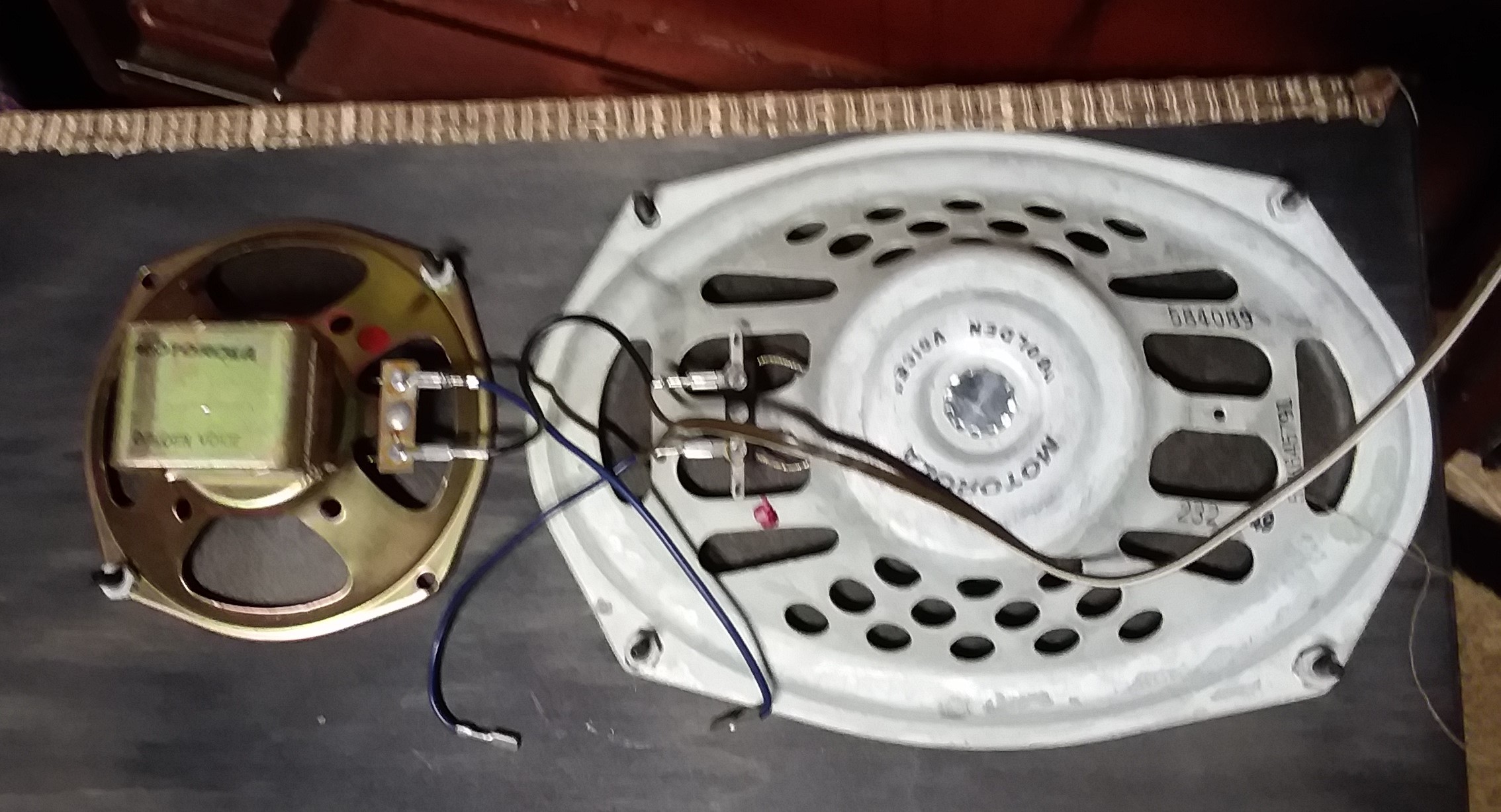

Probably the strangest thing I saw were the 6x9 midrange speakers (OEM 232 - Mag!) that appears to have no magnet. Has anyone seen this before? :roll:
The woofer is Motorola as well as the 4" cone tweeters, with 5 mf NP silver wrapped with clear plastic tubing caps made by Mag also, which actually tested good!!

If they put Magnavox speakers in your Motorola stereo, does that make it a Magnarola or a Motovox? ;) :lol:
I don't remember seeing a speaker like that, come to think of it.

Those 6x9s may have had tiny magnets, but remember that they did not have to do any heavy lifting in the bass department. And the lack of gauss strength may have been intended as a way of rolling off lower frequencies--part of the crossover design.

Perhaps part of the magnet is concealed by the basket stamping?
Weird those bridged tube-socket pins got by the Moto QC people, that's a pretty egregious goof.

Im going by the 232 EIA number on the 6x9s, which are silver like all Mag speakers. The six digit number begins with 580, like Magnavox
