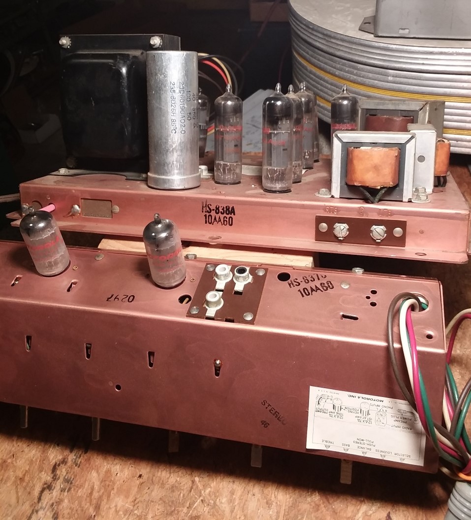

I have been impressed so far by the lack of wax-paper caps and way-off-tolerance resistors so common to RCA, Mag and to a lesser extent, Zenith. This is more of a repair and routine service than restoration, mainly due to its clean, low-hours condition.
The two 12AX7 on the preamp were Motorola branded but sourced from EIA 280 Raytheon, the 6BM8/ECL82 and 6CA4 were all branded originals as well, made in Great Britain. Thankfully all tested good, even the Mallory multi-section passes tests, reforming quickly at 300 volts. I cant wait to play this in the garage tonight
On the flip side, this preamp has the same MONO tape input limitation as two of my own models
. This really bites, like Motorola couldn't put one more contact on a two-position selector switch.

That's a beauty Dave. Like the really clean copper chassis ala early H-K and Westy, and it has a bunch of Mullards, even the cabinet looks pristine too!
6 6BM8s? does it have 3 amp sections? The Moto in my avatar ---> did, but they were all 6V6GTs iirc and it had the big 15" speaker center mounted with mid+highs mounted on the sides. I was very impressed with it's build quality and sound as well.
Good luck with it, minimal repair needed is always good!

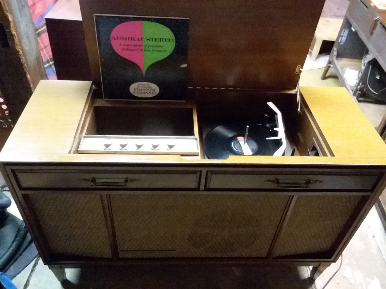

This woofer is a 12" flanked by 3" cone tweets and 6" round midranges, just like the SK112 in my home office and that uses 6 x 6V6 like the 1964 SKR151 in your avatar. After quickly hooking everything up in the cabinet, I dropped a changer in this console this afternoon and played a Chet Atkins stereo on an RCA pressing. It was balking at playing all three channels but that was due to those very dirty and worn channel verification switches that allow you to switch off any or all of the 5 speakers to confirm balance, etc.
I confirmed all three do play well, just not together
our garage has been a good test range due to mild temperatures along with all the clouds and rain, leftovers from the midwest ice storm I suppose. I would be happy for some sub-30s just for an excuse to fire my outdoor wood boiler up.
Once I get out there later this evening, I need to pull the channel verification switch enclosure apart, clean the three slider switches. Its on top of the record compartment lamp, which is a nice large diffuse lens that miraculously has not yellowed
Fortunately this job does not involve a record changer, so I can give it back real soon along with the little blond SK12
