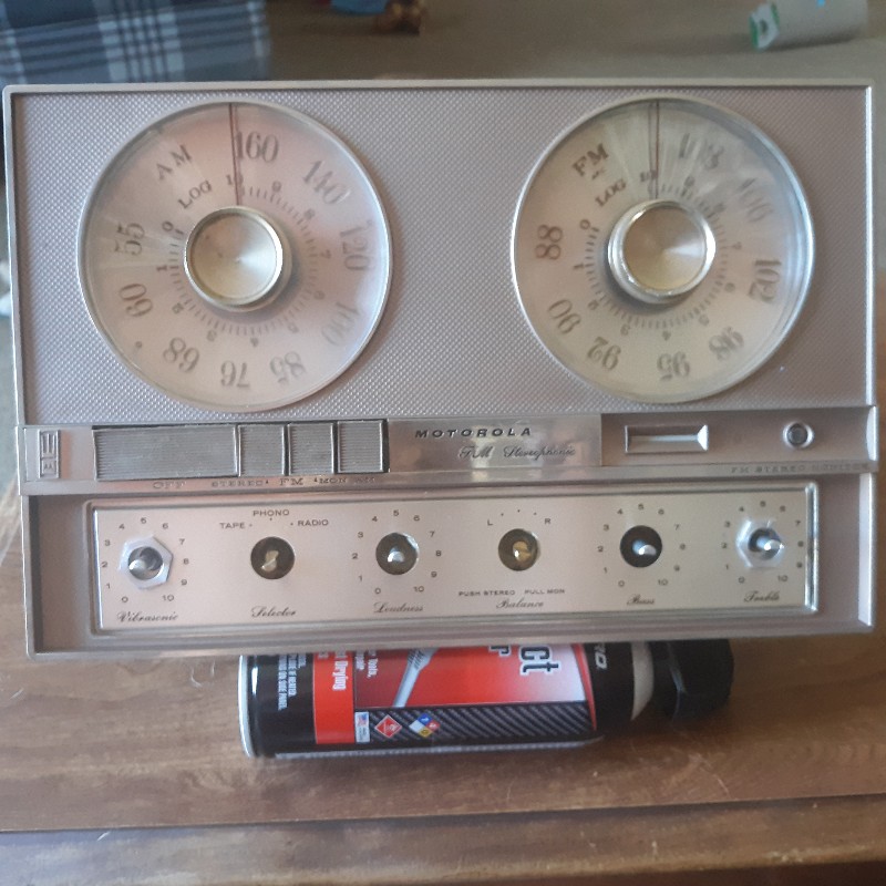

Been scratching my head as to how these chassis come out for about a week.. after lying on my back inside the console , I found these spring metal clips that I guess help hold it tight in the cabinet by friction... one of them was bent and somehow below the mounting board was keeping it from coming out... I hope I took enough picture to figure out where everything goes, because it is a rat's nest of wires everywhere... I gotta say, I give Motorola a zero on service ability... horrible .. and no wiring diagram anywhere to assist in wiring it back in... it outta be fun...

I took pictures as I pulled it out , and of course my phone ran out of memory ... so I got nothing...looking at the little individual charts on each chassis shows the inputs and outputs but not the wiring from each chassis ... and to top it off the color codes for the wires don't match... you would think they would paste a wiring diagram inside somewhere like magnavox does or inprint by the jacks ...but nooooooooo!.... my opinion on serviceability still stands... and where does the tape function come into play?... I see no inputs for a tape anywhere... unless you give that up with the MPX option ?

Hey all , went through the amp and tuner chassis.... not many electrolytics in side at all, mostly all ceramic caps . it took me a couple times to remember where all the wires went , but it is all together and running fine except the FM tuner was way off... found out the FM tuner string collet came loose and caused the dial to veer off badly ... I got it close but it is still not correct, looking at the sam's data , it seems the tuner needs to come out and remove the covers to align just the 108mc to the dial ... while somehow keeping it all connected to everything else ... no thanks.. I can deal with 104 coming in at 98 ... I think my expectations were way too high on this especially with its push pull 6V6's for the bass... I expected way more than what it is ...even with the bass turned all the way up it is so-so , but it is only a 5 watt per channel , the radio is OK but the phono has barely any bass ...I guess I want 100 watt sound for everything... :lol:

The bass on all of the Motorolas that I have worked on has always been too much and could never run them with the bass at 10. Did you check your tubes? The amp in your is a mid-level amp, so they may not be pushing it as hard as the upper level PP 6V6 amp.

Moto_TJ wrote: ↑Wed Aug 18, 2021 12:29 am The bass on all of the Motorolas that I have worked on has always been too much and could never run them with the bass at 10. Did you check your tubes? The amp in your is a mid-level amp, so they may not be pushing it as hard as the upper level PP 6V6 amp.
That is what I have heard about these.. but this one is mediocre at best ...I have solid state silvertone that will rattle the windows ... went through the amp checked resistors for values a few were up but nothing out of the ordinary... the tubes are all branded motorola and test strong on my Jackson 648, only odd ball tubes are a couple of the 12AV7 tubes have been replaced with RCA's... I ordered another 6BQ7 for the FM RF , as it tests as it has a cathode short , so I had another one in my tube stash , and it also checked the same .. don't know if it is a thing with these tubes or the way the Jackson tests them....
Does the tube diagram on the amp call for 12av7 tubes? Motorola usually used 12AX7 tubes on the amp and preamp, and that could be part of your issue, I think the 12AZ7 is like a 12AT7 for output specs but was designed for different purpose than a 12AT7, but workes in its place.

nope my bad I mistyped the number , they are 12AX7's

Are the cathode bypass components on the output tubes known to be good? If it has poor bass response, perhaps somebody put a Magnavox bi-amp in it.... ;) :shock: :roll:

The cathode bypass components I referred to would be the cathode bypass capacitor and the cathode bias resistor. If the bypass cap is partially shorted, not only can that affect bass response, but it is also hard on output tubes and audio output transformers. If the bias resistor has drifted, that can affect bass response, as well as the life of the output tubes. The bias resistor should be almost dead on as to value. If it has drifted any, it should be replaced. Sorry for the confusion. I hope this helps.

I would agree to this comment and limit it to the stereo bi-amp amps. The mono bi-amps, have tons of bass, but they have 4 or 6 tubes on the bass channel with a much larger output transformer.
I to agree with checking the electrolytic caps on the amp, a bad cathode bypass could be your issue!
