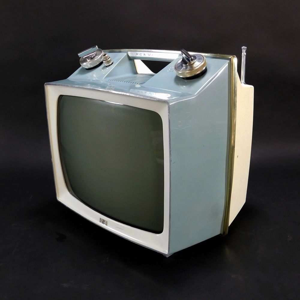

KCS 152 (?) - first all-transistor portable 1966, and very easy to repair if it even needs it. pic below
