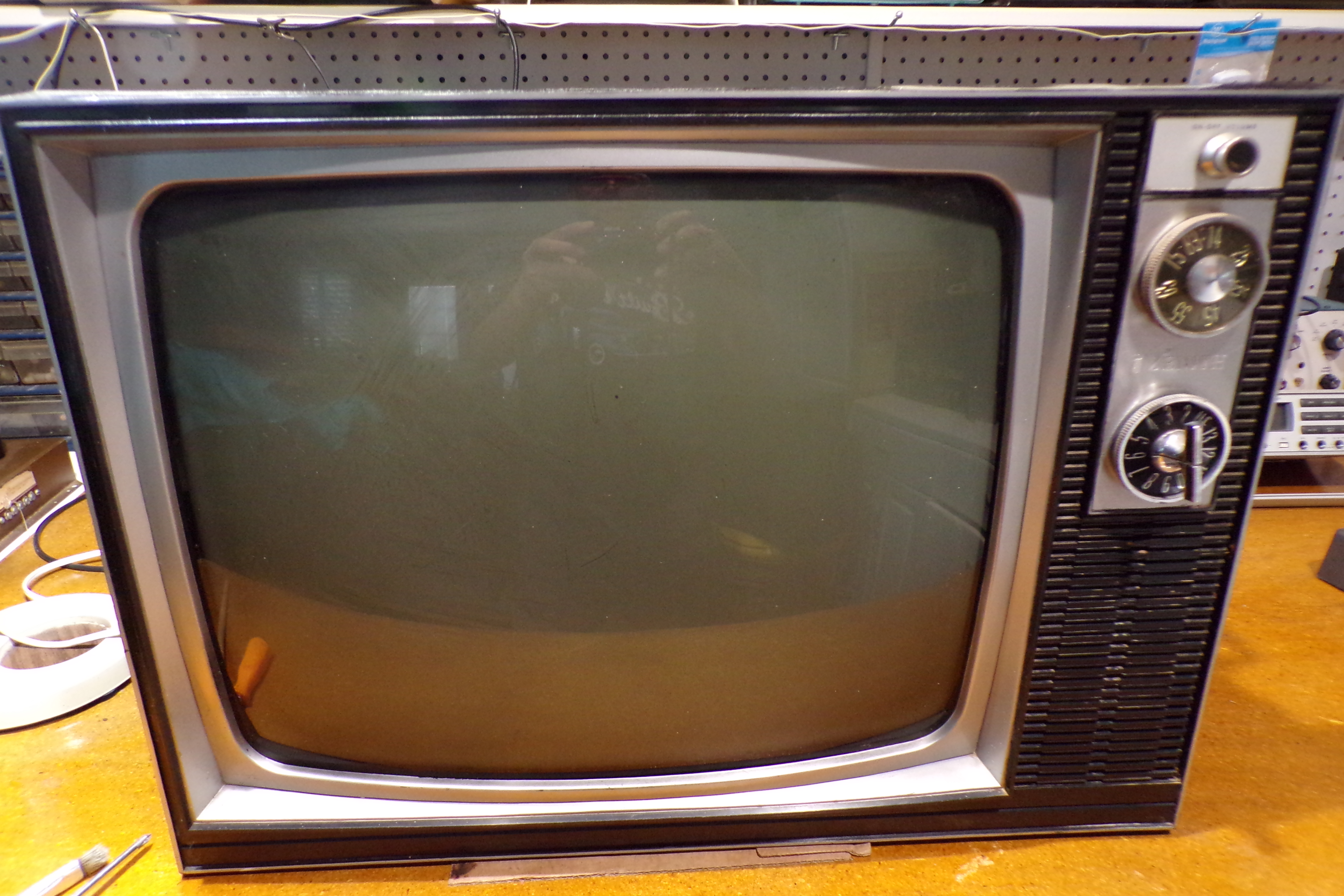

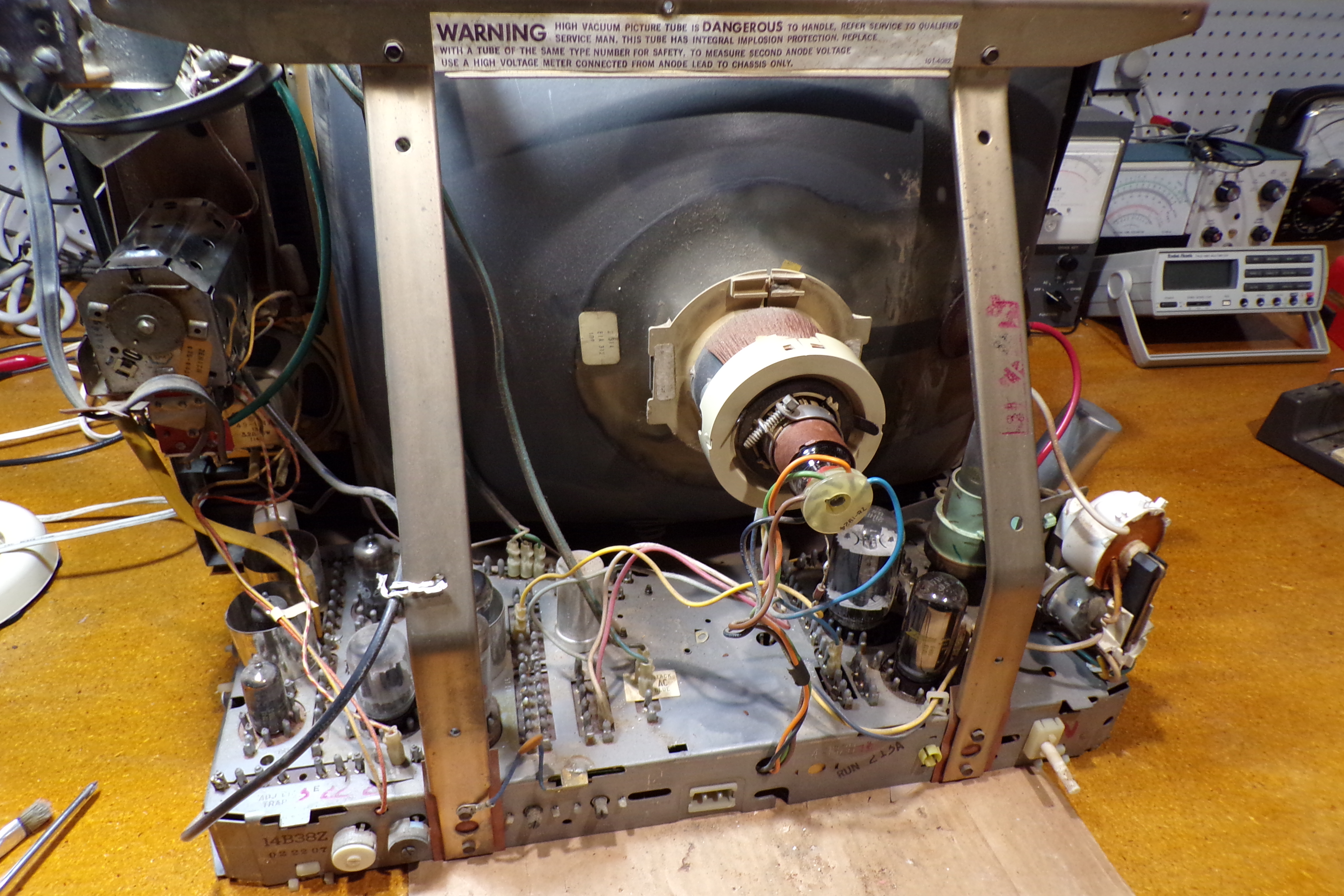

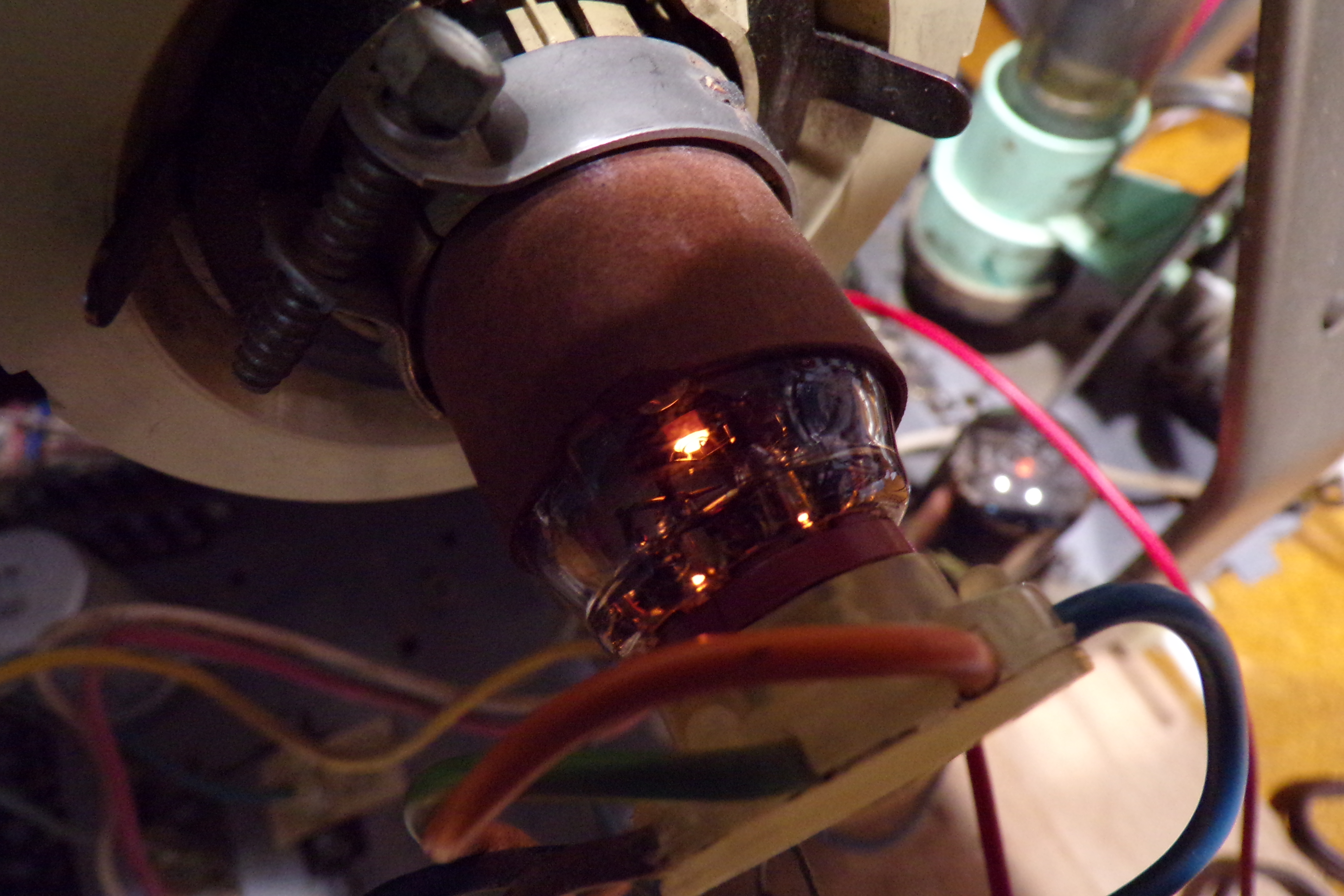

Okay, here they are.

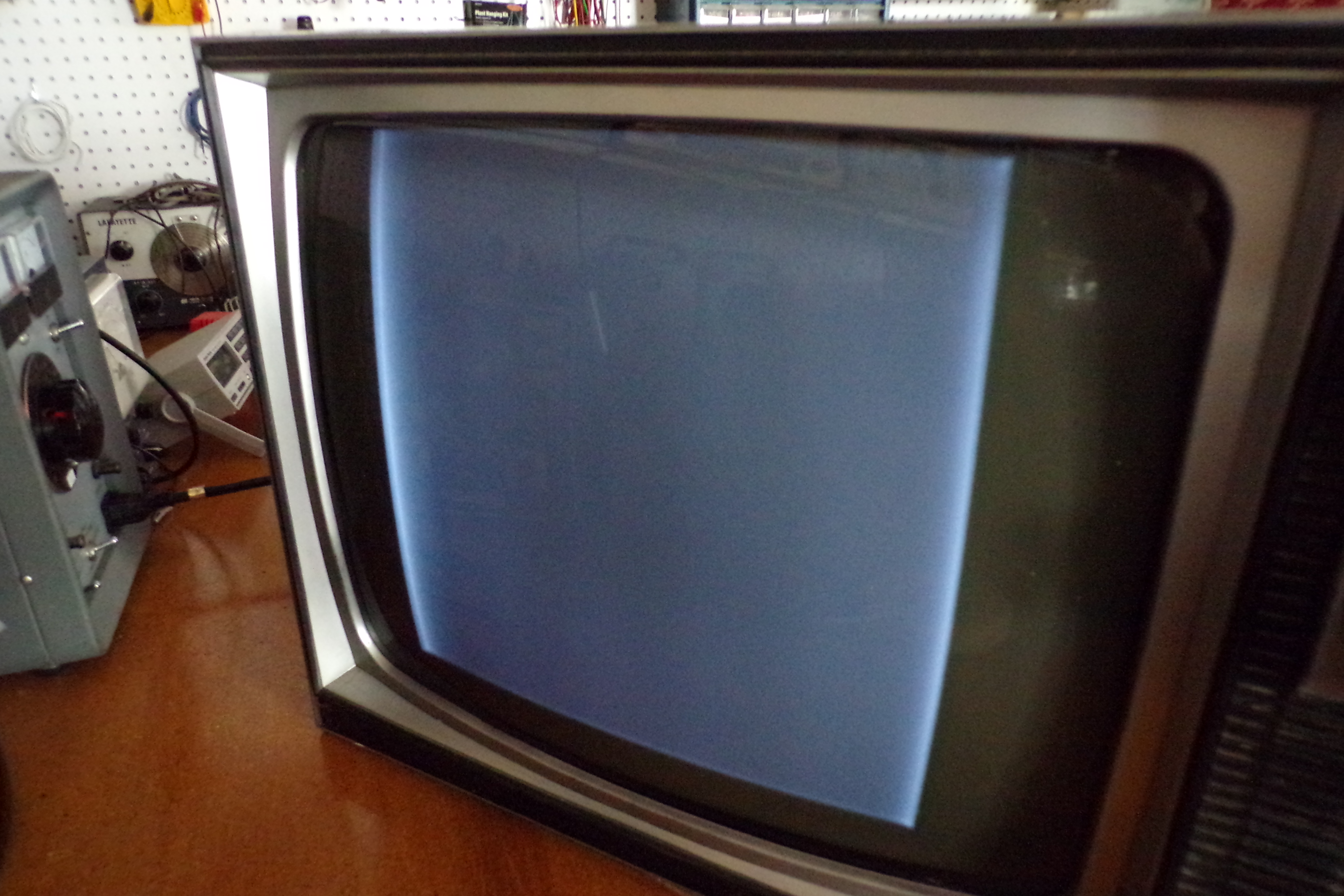

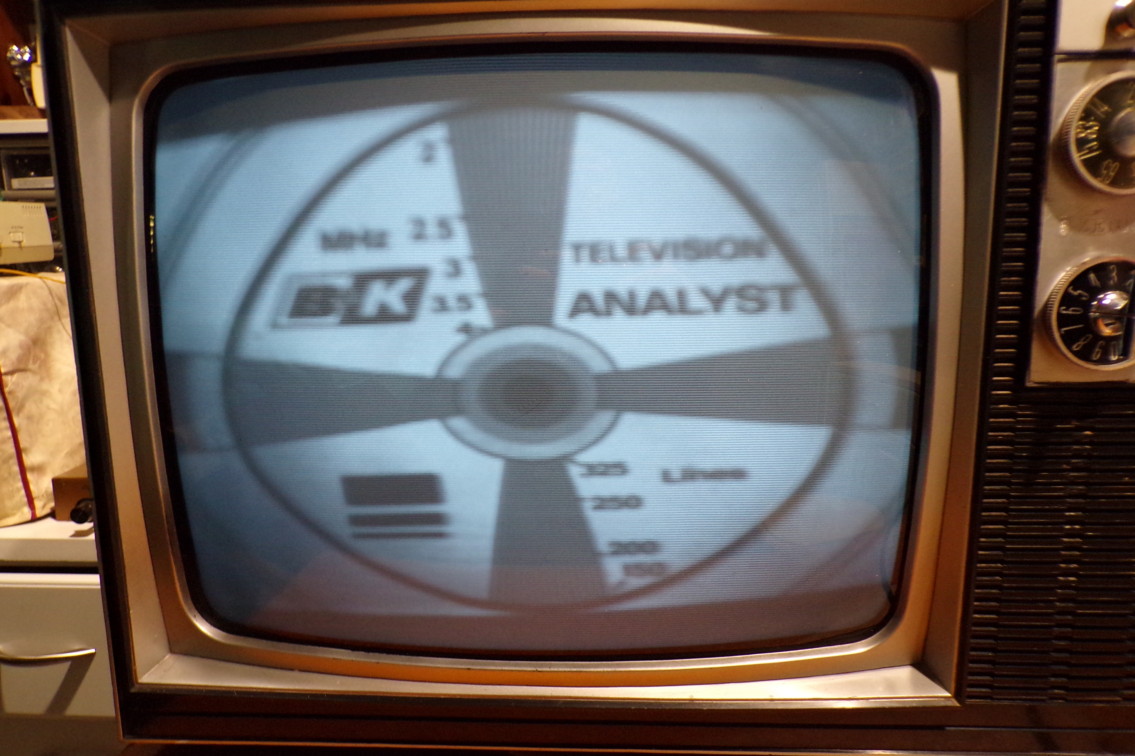

You will notice in the last picture the big goose egg in the image. You will also notice the image does not fill the screen vertically. You will also notice the TV has a full raster. Hence, may we conclude that my Analyzer needs analyzed? Probably has some wonky caps and or a couple weak tubes in the video circuits.

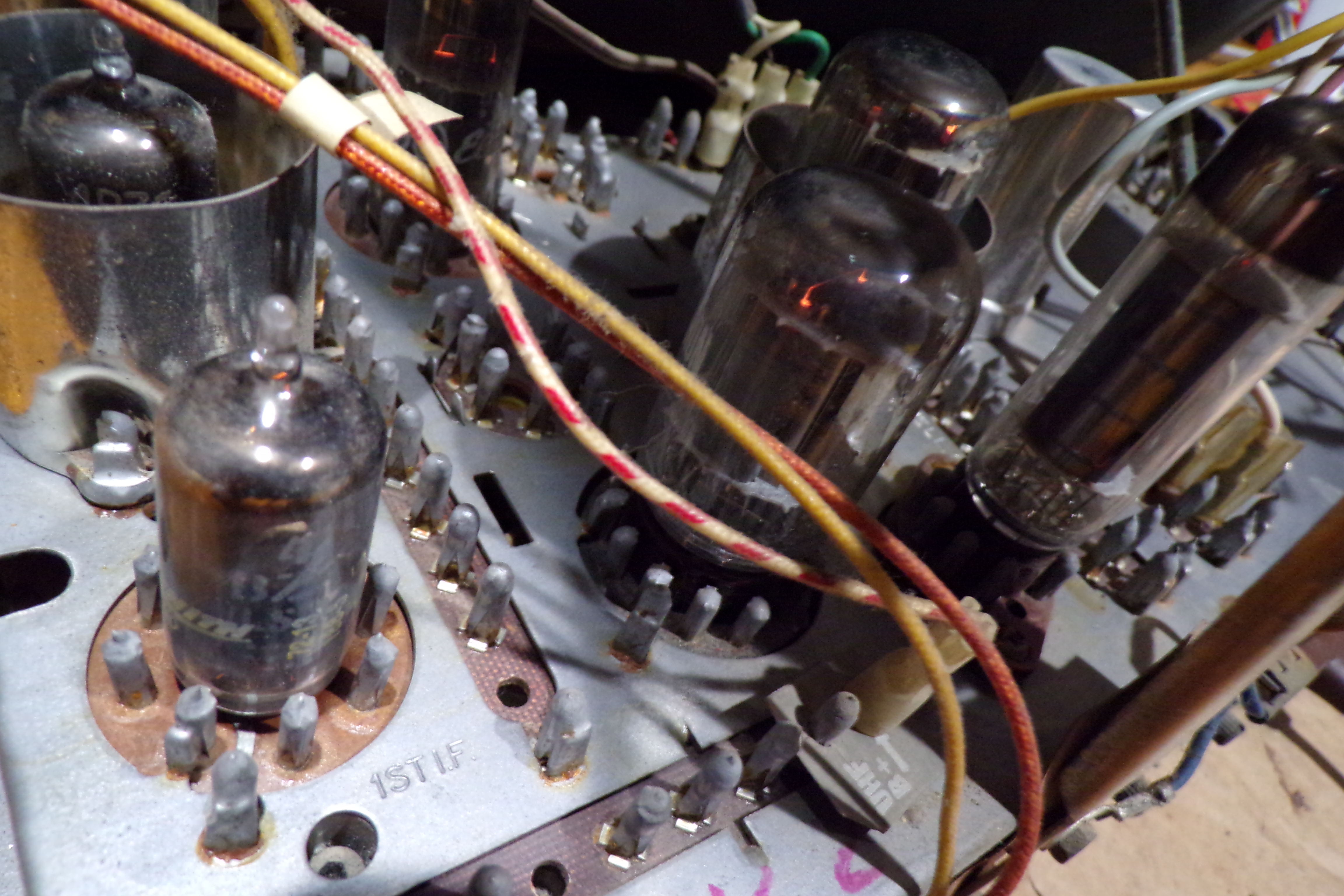

The tubes in this TV were made by Sylvaia, GE and RCA. There are three 4BZ6 tubes in the IF strip. One made by GE, one by Sylvania, one by RCA. The picture bulb was made by Sylvania. I cleaned the tuner (my first time doing that) and all the controls. The vertical is rock solid until the Analyzer messes it up. The Analyzer is an amazing piece of test equipment. I'm thrilled to have it. It will save me a lot of time. If I was a real "TV guy" and wanted a whole shop full of TV test equipment, the Analyzer might be a shortcut instrument. For someone like me who is only into TV because he has some and doesn't want to toss them, it's a life saver.

It looks like you might have a good set there, Greg. This is the first TV that I have seen that the Flyback components are not enclosed in a metal box. Zeniths of that era were definitely well built.

As you know, Bill, I avoid Zenith radios like the plague. But I am impressed with a Zenith TV. Those little posts around the tubes let you measure voltages and run testing without having to pull the chassis to make measurements under the chassis. I really like that. This thing is 50 years old, and, minus a couple adjustments it needs, still works perfectly. That is impressive.
Without inappropriately melding topics, I connected the Analyzer to a later RCA color set that I know to be in good operating condition. I still got the "pregnant" image like I did on the Zenith. I will retain other comments for a topic on the Analyzer. The TV is mostly okay, it's the Analyzer that needs attention.......

The little towers were also solder posts for a non-PC chassis, right?electra225 wrote: ↑Sun Nov 20, 2022 11:10 pm As you know, Bill, I avoid Zenith radios like the plague. But I am impressed with a Zenith TV. Those little posts around the tubes let you measure voltages and run testing without having to pull the chassis to make measurements under the chassis. I really like that. This thing is 50 years old, and, minus a couple adjustments it needs, still works perfectly. That is impressive.
- Posts: 9020
Re: 1972 Zenith model T-2657 19" B&W TV set
I think Zenith called those little posts a "Service Saver" chassis. They appear to be a part of the tube socket assembly. My understanding is the posts that hold those assemblies into the chassis are points where you can connect test equipment to common negative. Maybe some of the TV gurus on here can clarify that point.

Elton, I believe it to be an all-tube set. The UHF tuner is solid state, of course. It has 14 tubes, including the picture tube. I'd call it a late tube, Compactron set. Zenith put their transistors in obvious places, and I don't see any. In fairness, I don't have the drawing for this set, so there is that. The horizonatal oscillallator is a 6GH8A, but the horizontal output tube is Compactron, as is the audio detector/audio output tube. The sync tube is Compactron. The IF strip has three 4BZ6's, the vertical oscillator and the vertical output tubes are not Compactron. It's a pretty simple TV, beautifully built. If you look at the second picture, just to the right of the left chassis support upright, that is the wire for the power to the switch. The interlock is below the white plug on the chassis. And to the rear of that white plug, there is a stake. That stake/lug is common negative. You can do almost all voltage tests from the top of the chassis using that stake for common negative. How much easier to service could they have made it? I think even I could actually fix this set if it came to that. I can see why the TV guys have a lot of respect for Zenith TV sets.

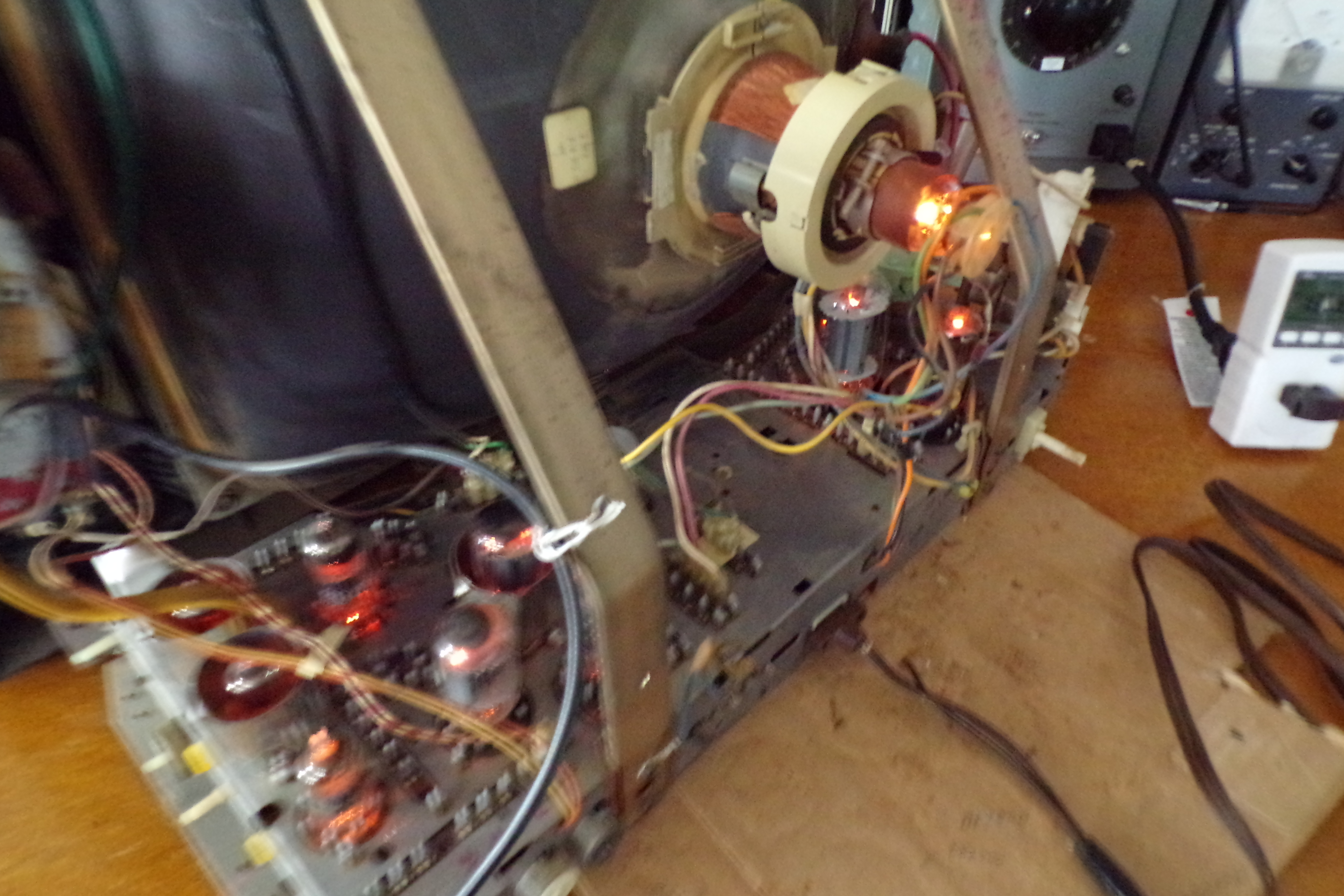

I sure wish I had Mr. Wells around again. I'm not sure the picture on this TV is as good now as it was that I posted above. I had some problems with the contraption I used to adapt the antenna connections on the TV to the Analyzer cables. The picture is washed out, with poor contrast and poor focus. I don't think the problem is in the Analyzer because I can increase the settings on the video control and RF attenuator until it overloads the front end of the TV. The contrast control really doesn't do much. I had a shop lamp on next to the TV and turning that off helped some, but the pictures still looks washed out to me. My next step is to fix the antenna adapter and get a VCR connected to it. The tuner doesn't seem to be dirty anymore. None of the controls that I used were scratchy. I have a beautiful raster, rock solid vertical and horizontal lock. Good audio, not even any Zenith buzz.

I may be worrying about something that is somewhat normal.
First, let me say how much respect I have for anyone who seriously works with these old TV sets. They have LOTS more patience than I do. Tinker. You gotta twiddle and tinker to convince one of these old sets to work. I had the contrast up WAAAAYY over yonder too high. I backed off on the AGC just a tad. I think there is a focus control, but you have to remove the back to get to it. The image is for sure out of focus. I found an old Ronald Reagan black and white DVD and connected the device to the TV. I found a better antenna doodad, which helped considerably. The pictures is better, but I still believe it's washed out. I REMEMBER it being more sharp and detailed. The black is too gray. Or am I expecting something it never had? I may run it awhile before I tinker much more. Video linearity and height seem okay. Maybe I need to run it awhile to wake up the picture tube?

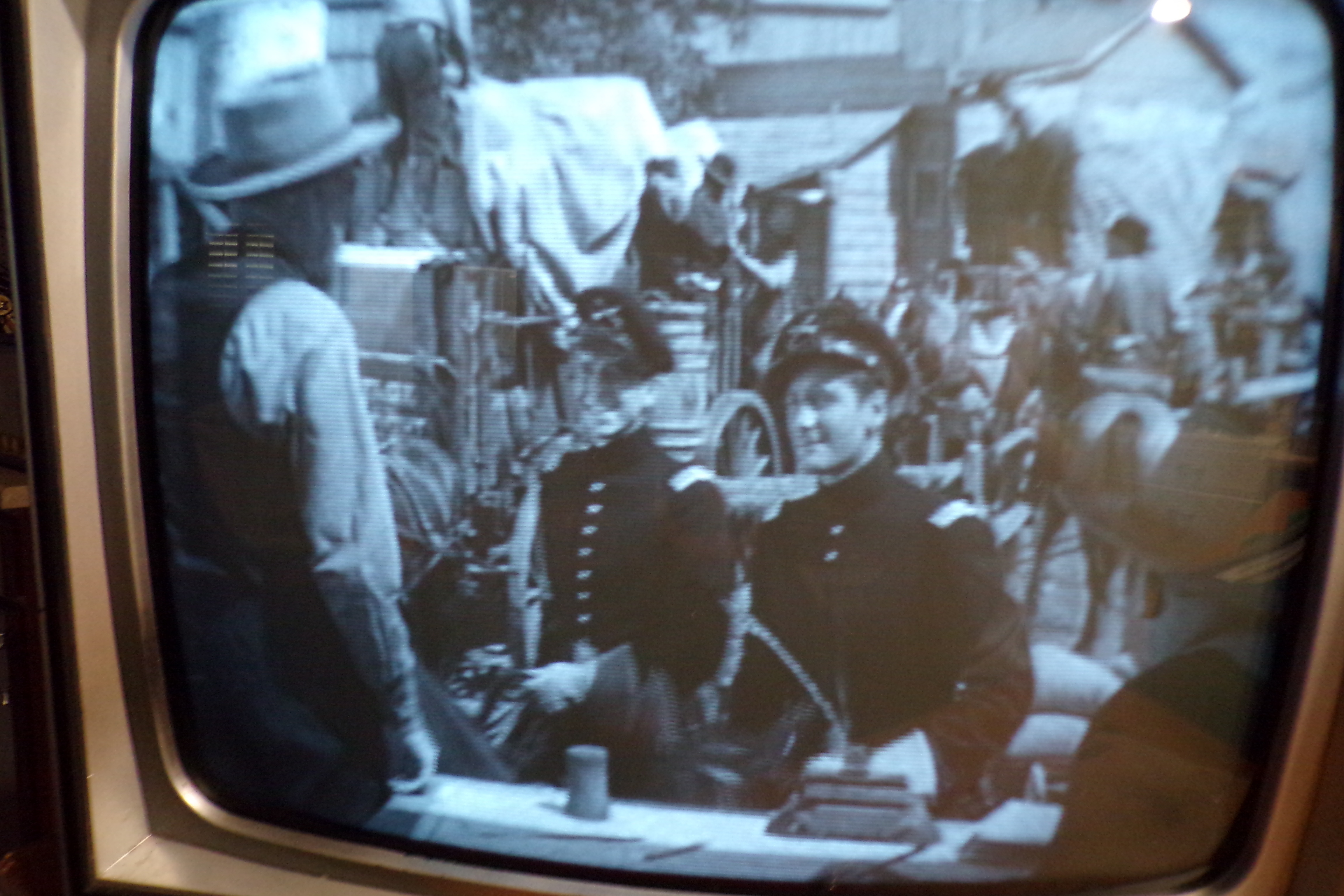

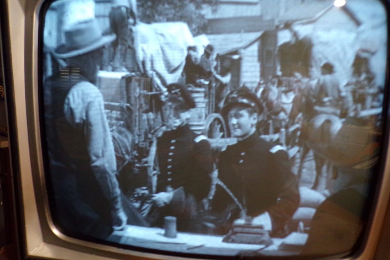

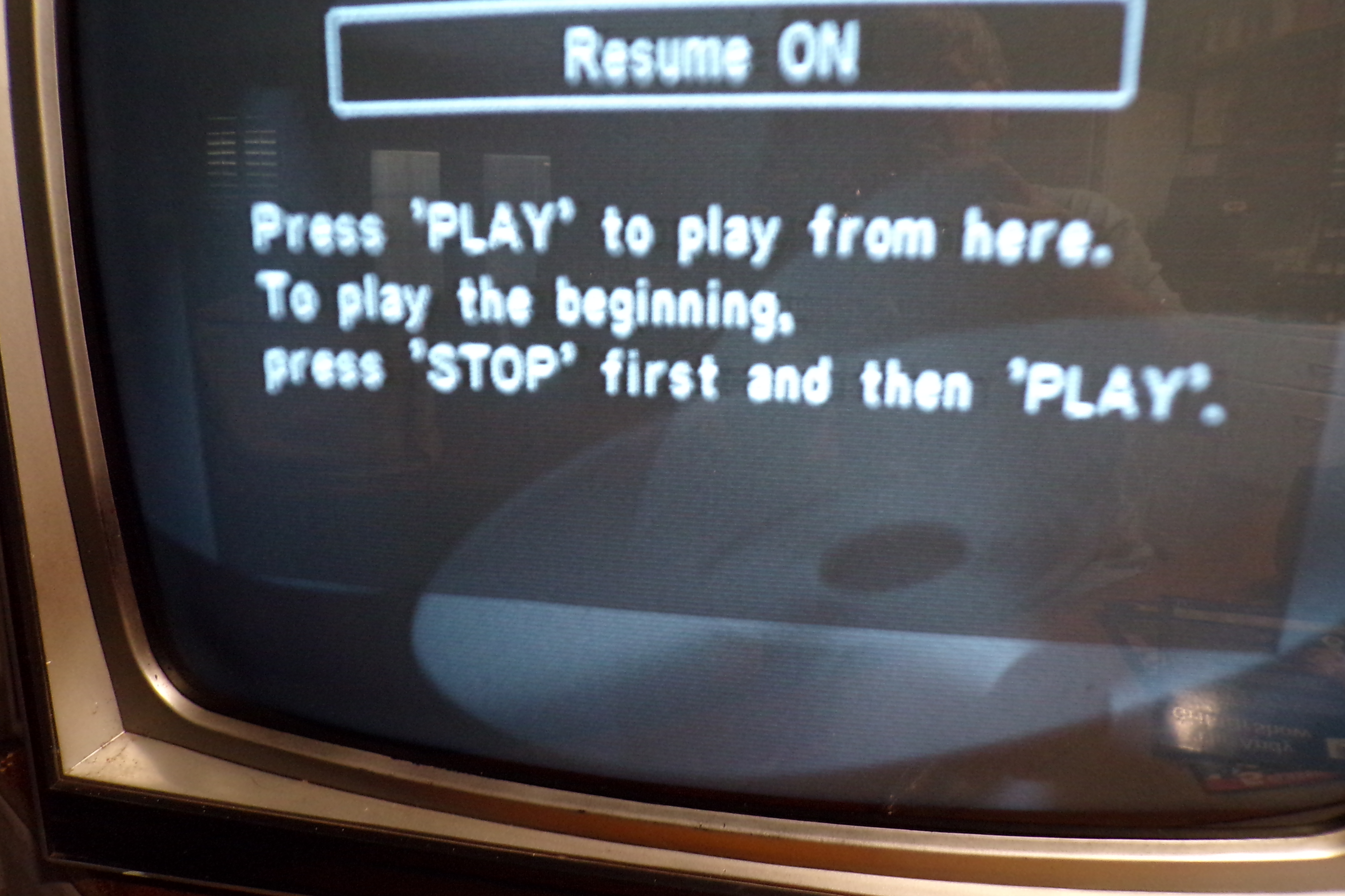

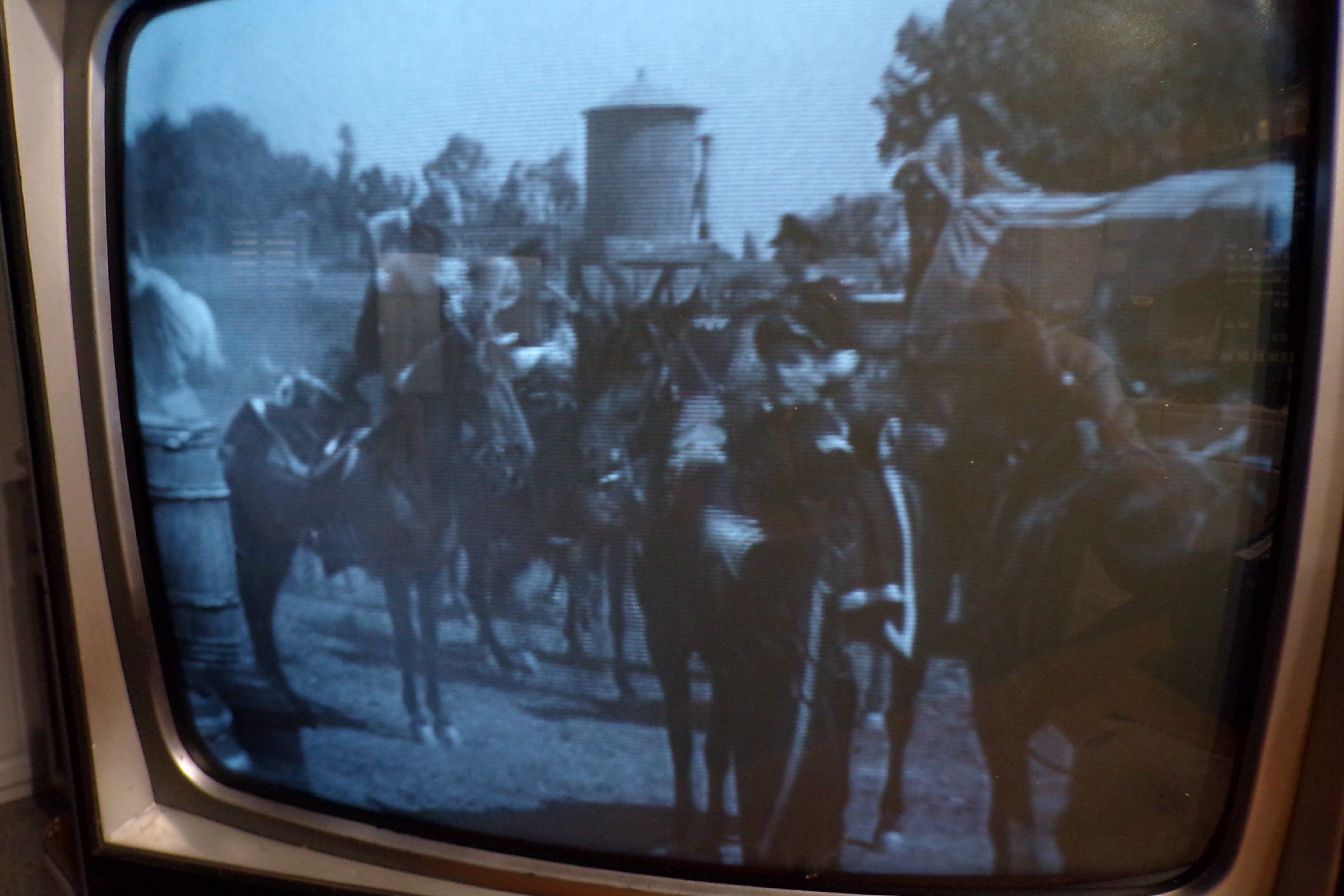

I fired up this old set this afternoon. I played a couple Andy Griffith DVD's and then "The Sante Fe Trail" with Ronald Reagan and Olivia De Havilland. I let it run for about an hour before I did any twiddling with controls. The longer it ran, the better the picture got. It now has a very respectable picture, no buzz, but the focus could certainly be better. The picture is not so washed out as it was. I set the AGC control right on the edge of distortion, then cut back on the contrast control, darkened the screen a bit. I may need to get a print on this chassis to clear up a couple questions I still have. There has to be a focus control someplace. The vertical height is good, horizontal seems good, the picture is rock stable. All in all, if something doesn't fry being on so long after so long a rest, I'd say it represents the brand Zenith well. I have essentially done nothing to this thing except some cleaning and some adjusting. The controls all seem good. I fixed my broken DVD player and used it all afternoon and it's still running. Next up is to figure out why the VCR part eats tapes. It plays them okay, but good luck getting them back. I don't know whether something is jamming, of if the belt starts slipping just when the tape starts lifting on its way out. It may have been 30 years since I had used this TV very much. My plan is to rig it up to receive OTA TV. I have no idea how that will work. IF I get that figured out, my next plan is to find an agile modulator and see what I can do with it.

Before you use any medium to test the performance of a TV you are working with, first test that medium on a set known to be good. In other words, play any DVD you use for test on the flat panel set in the house to make sure you are not watching a wonky movie then trying to "fix" the TV to compensate. Don't ask......

Your screens shots look pretty good, Greg.
