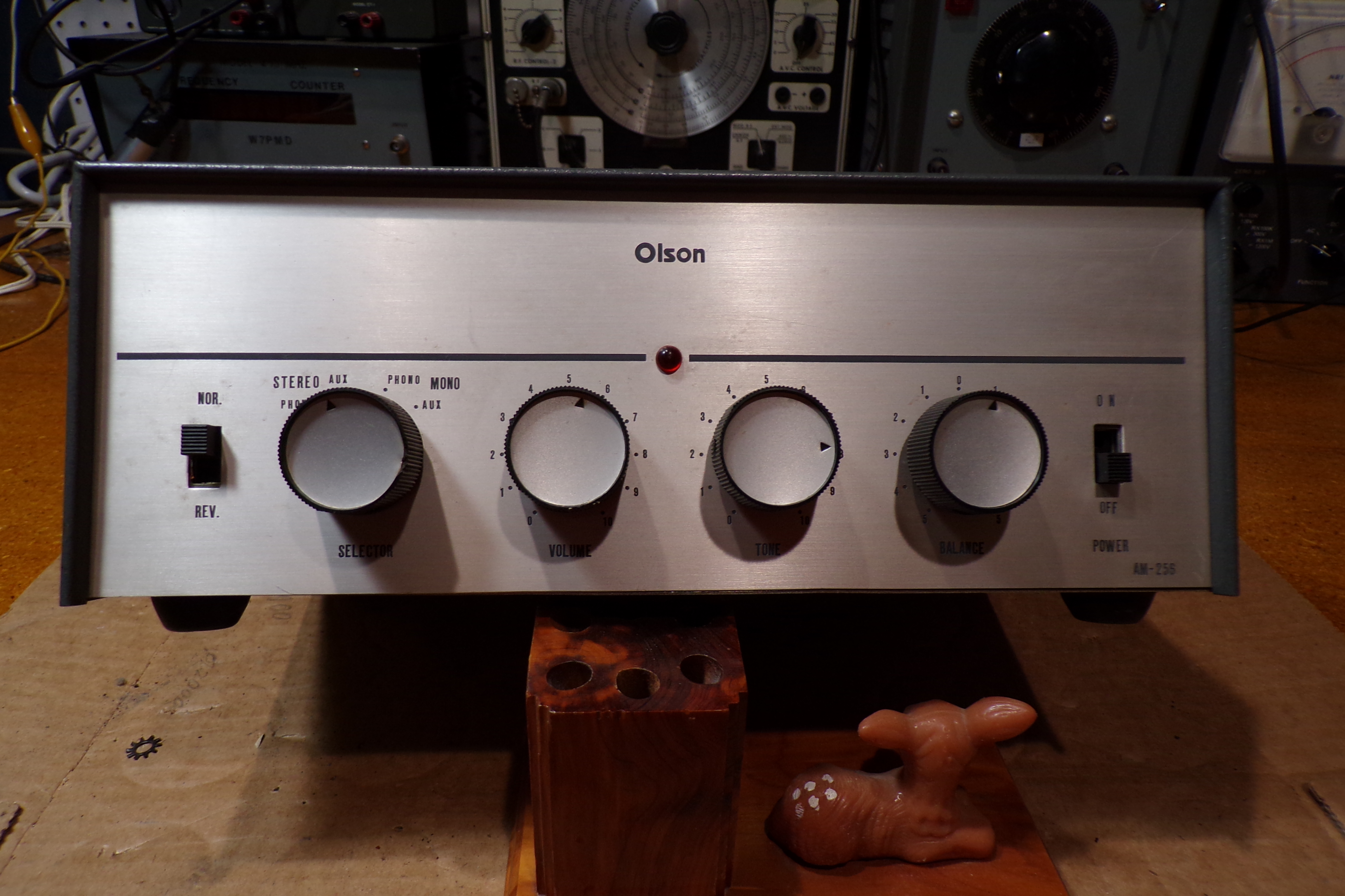

I use this little stereo amp on the bench when I need one. I don't remember the last time I used it, but it has been at least two years. I wanted to bring it up to power slowly, so I connected it to my iso/variac/dim bulb contraption. I set the voltage at about 60 volts, and put the Kill-A-Watt in series with the amp and power supply. As soon as I flipped the power switch on my power supply, the 5 amp circuit breaker tripped. I fired up my trusty old VTVM, and found a dead short at the filter caps. The four-section filter cap is a Rubycon with two 40uf @300 volt caps and two 10uf @ 300 volt caps. All four show shorted. Next step is to disconnect the circuit at the rectifiers, check the rectifiers, and also check to make sure the PT has not been damaged. Then I will lift all four legs of B+ at the filter caps and check each of them for potential shorts. Finding all is well, I will replace the filter caps. There is precious little room under the chassis, but the plan right now is to restuff the can with the two 40uf caps with 47uf @ 450 volt caps. The two 10uf caps I believe can be mounted under the chassis on a terminal strip. Tight, but doable. The 6AQ5 SE amp is not a barn burner, but it worked real nice for a test rig. One of my next projects is to start working on changers, so I wanted all my test equipment up to snuff.

Olson was not Mac-level stuff to be sure, but I like the thoughtful way they recessed the output tubes. I assumed it was for ventilation, the neglected issue for so much tube equipment, but then it occurred to me that maybe it was just for vertical clearance purposes, with venting an unintended benefit.electra225 wrote: ↑Wed Aug 31, 2022 1:38 am The 6AQ5 SE amp is not a barn burner, but it worked real nice for a test rig. One of my next projects is to start working on changers, so I wanted all my test equipment up to snuff.

This thing works mono or stereo, so it was handy for the bench. The audio is so-so. All I want it for is to make noise when appropriate, and it fills that bill nicely.

IIRC these Olsen amps were made in Japan, not that that's a bad thing. I had a very early Kenwood tube receiver that was made in the early-to-mid '60s and it was excellent, had 4 x 6BM8 PP output I believe.

I'm sure this one is made in Japan. IT seems to be well-built with a beefy power transformer, and wimpy output transformers. It is handy for a test amp. I hope I can resurrect it.
