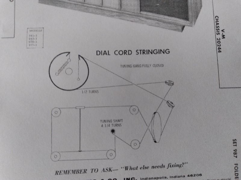

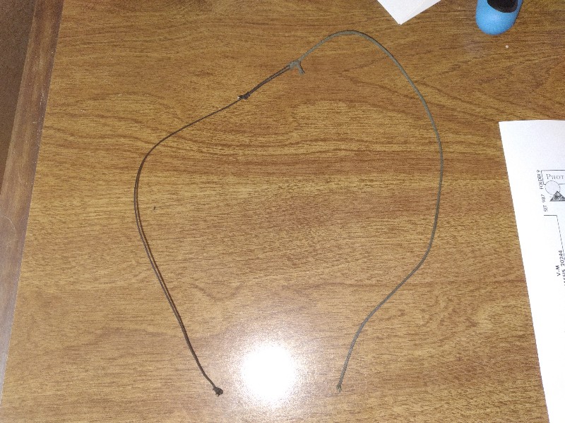

the 977 I tried to restring the dial as per the sams using the standard .08 cord it just slips , when I took the set apart a found one end of the cord with the spring attached to the standard size cord but then it transitions into larger cord... whether this was from the factory or done after is the question .. the cord guides are large like they are made for the thick cord , but can't imagine that thick cord wrapped around twice on itself on bottom of the dial indicator where it looks like a race track ... guess I will have to ask Gary if he has any insight on this one ...

I find it amusing, and puzzling how they came up with all the gyrations that make up the travel of a dial cord. Everyone is different, and to me everyone is overly complicated and bizarre. My guess, Gary will have an answer.

From your photo, it looks like somebody had to do a dial cord repair and only had some string at hand so they tied the string to the useful remains of the original cord.

I agree with Chris. That looks like regular old string, instead of dial cord. Probably why it slips. ;) ;)

Yes...it was a repair , I spoke to Gary and he confirmed that all VM products used the .028 sized cord ... since I only have about 3 feet left , i will have to order some... this tuner takes about 5 to 6 feet by itself...

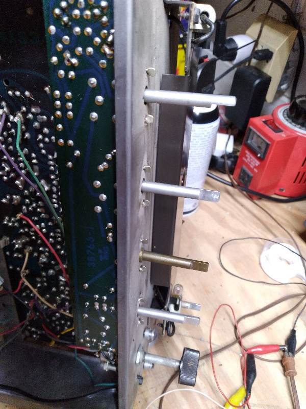

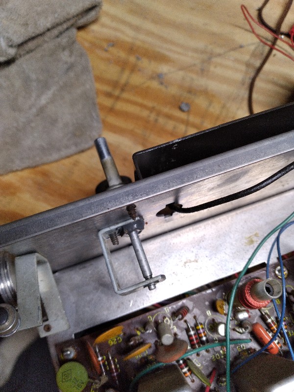

Here is one issue this set had , and the reason I think the dial cords wouldn't work correctly... the tuning shaft itself was so worn and wowed out where it goes though the chassis that I had to JB weld a nut with a inner diameter hole just large enough to support the shaft ... before this fix ...the tuning shaft could wobble up to a 1/4 inch in any direction .... also working on the preamp is going to be a pain ... that board is held on to the chassis only by the twist tabs on the pot/controls ... no center nuts.... so I risk breaking those tabs just to recap the preamp board... another reason for my cheaply made statement...basically this radio is just a step above a portable sized am/fm radio chassis in a console IMO ... with it's single transistor output on each channel I would guess it produces 3-5 watts max...I will keep you updated on the progress

That is a rather ingenious repair that should work well. I'm a bit surprised that VM built something that appears to be rather "breakdownable". VM equipment is typically well-built. Good luck with the restoration. And thanks for sharing.

Nice job, Elton. As much as I hate to admit it, VM went cheap along with everyone else in the late 60's and beyond. As I mentioned in another post in this discussion, their higher end stuff of this time period was still topnotch. I'm always looking for VM tube stuff and one would think it would be everywhere since they were built here in Michigan. Not so! As far as VM consoles go, I have two. The one you picked up for me and another one that I actually found here in Hart. Good luck with you project.
