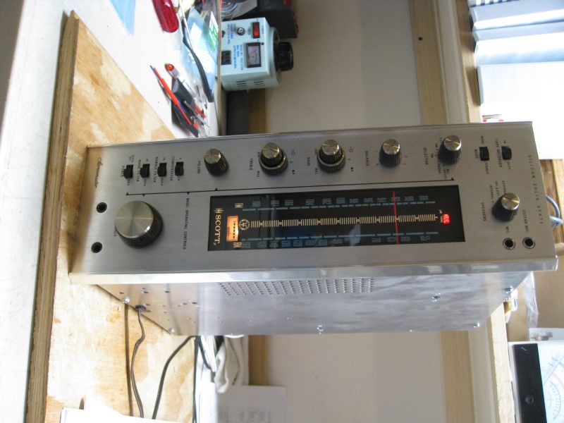

The Scott is running pretty good, but the MPX portion of the FM is not up to par. It only goes into stereo on a couple of strong stations, not necessarily the strongest ones. When I picked this up the turntable was glued together with lubricant, you couldn't even push the start/stop lever to either side. I sill have an issue with it as it won't shut off when playing the last record. It's not any linkage, it's that there is something that has too much friction preventing the switch to complete. I did notice that I can feel a slight resistance on the start/stop lever. I had a Dual 1225 back in the 70's and I don't remember any drag on the lever. I'll get back to that later. The receiver is kind of a "combination" of sorts. It has parts from the 342, and 382 receivers. The chassis has been recapped, but FM didn't have any sensitivity at all. The meter was lucky to get just below center, even with an outdoor antenna connected. The rf transistor for FM in the tuner (a FET) was not working as I pulled it and that didn't change the signal level thankfully the transistors are socketed. This chassis was worked on before and I'm sure several times as it looks like the tuner was pulled before. Found a replacement FET amp and now the signal meter works as it should. Here is a picture of the front of the receiver running on a FM stereo station. The original #49 lamp (stereo indicator) was burned out so I just changed it to a LED with a dropping resistor after reusing the original bulb base. I'll leave this thread and start a new one showing the cabinet and insides in the appropriate section. There's much to figure out on the receiver as the schematics were ok, but the pictures were somewhat blurry to work from. I was just happy to get a similar schematic to work from.

I believe the Scott console receiver shown on the bench is basically a 342 (first version) with axis rotated 90 degrees.

I thought I had posted to Firedome and now noticed it never posted, I guess I have to be more careful. In my answer to the receiver being an early 342, you are correct, except that this one has both AM and FM - maybe an early 382 version. The schematic is similar to the 382 but has the MPX-10 version board. The issue I'm having is it will produce the pilot signal for the stereo decoder, but not just quite enough on most stations. If the pilot signal increases past a certain level, the pilot signal jumps to what it needs and stereo comes in. It's kind of like the trigger point for switching to stereo is set too high. There are only 2 or 3 stations I can get the light to illuminate, but I have several dozen stations that are at signal level 4 (out of 5). I can get it to go to stereo with my signal generator, but that won't help me much. I ordered a transistor tester to see if one of the transistors on the MPX board has low gain. In the alignment instructions it says to pull a couple of transistors to get the 19khz oscillator to run very close to the pilot signal for best lock in, but those transistors aren't in sockets like some of them on the board. I'd like to put sockets on those transistors, but finding ones that will work is the tricky part. Like I said before, this one has seen some service before so it may take some work to get it just right. Regular FM sounds just great. I did figure out the reason for the 15 second delay on FM when powering up - it goes through the preamp circuitry whereas the other inputs do not. I think the phono would have the same issue as it goes through the preamp as well.
