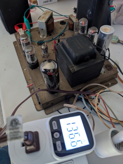

Finished recapping amp, but still short one 6V6, so I just tubed up L & R channels with small test speakers, and fired up with the dim bulb (100W) tester, and everything looked ok, so I took out the bulb and shorted the socket for this picture. Feeding the inputs with an old cellphone headphone jack and Prime Music, it sounded fine. Then, I moved the left tubes to the center channel and all works OK, too. Even on my little speakers, you can hear the bass emphasis on the center amp.
So, 137 watts for just the amp seems OK, since total draw for the SK111 is supposed to be 240 watts according to the back panel sticker. (that's at 120V, my line is 125V) Interesting, that's much higher than the Sam's datasheet which says 175 watts.

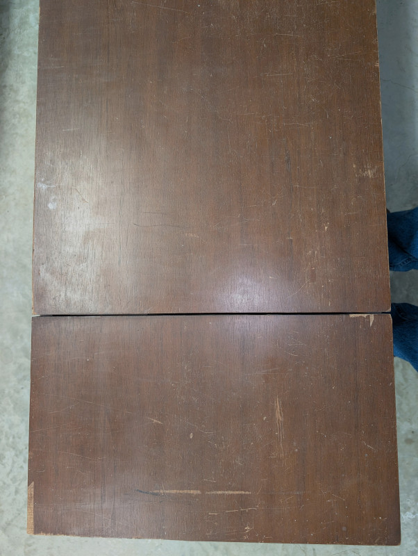

Besides the abuse this cabinet has suffered (lots of scratches, gouges, ripped off veneer), it also had a virtually opaque factory finish. To remove the scratches/gouges, I sanded the top and sides, revealing a nice grain-matched top veneer, with the raw veneer on the sides being normal-looking (brown) walnut. The top, however, was much lighter, so I adjusted my staining accordingly, no problem.

Anyway, after sanding, it was evident that they used a mix of poplar for the frame and molding (some large olive green streaks typical of poplar) so I needed an opaque treatment for the front. Even the nice louver assembly had nicks exposing a lighter finish which would not accept stain for touch ups.
I suspect they used parts of that louver assembly on several different cabinet designs.
I'm letting everything dry overnight, and tomorrow I'll finish up with a final laquer treatment. Hopefully in a few days, I'll post pictures of the final result!
